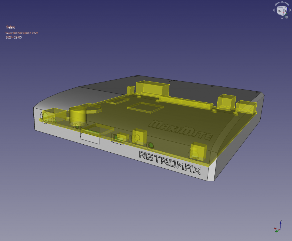

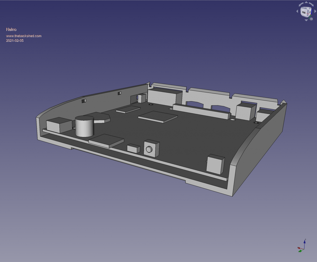

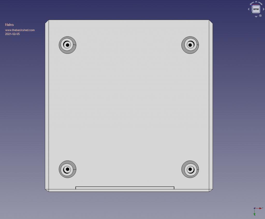

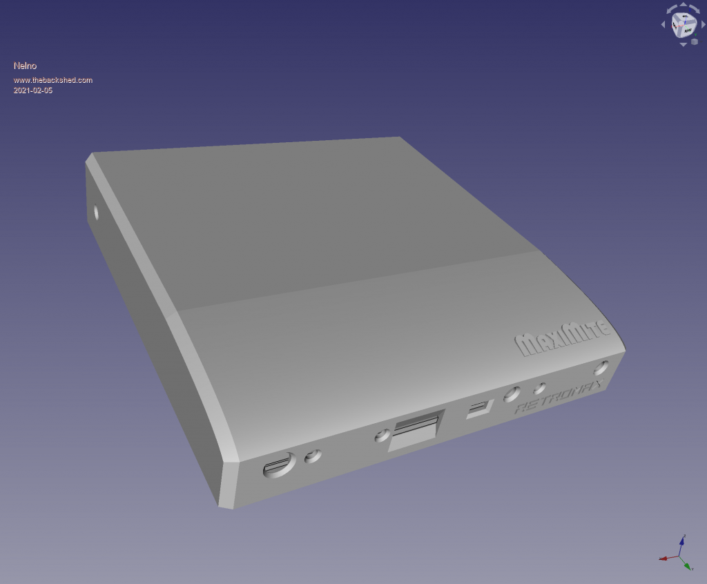

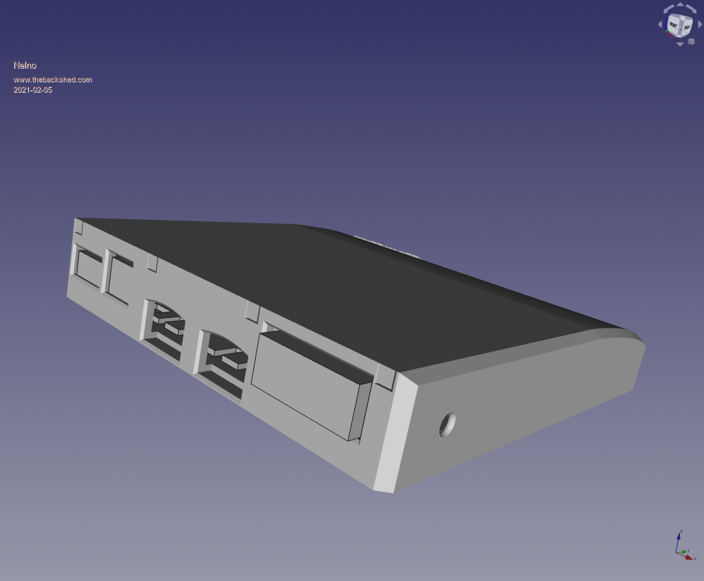

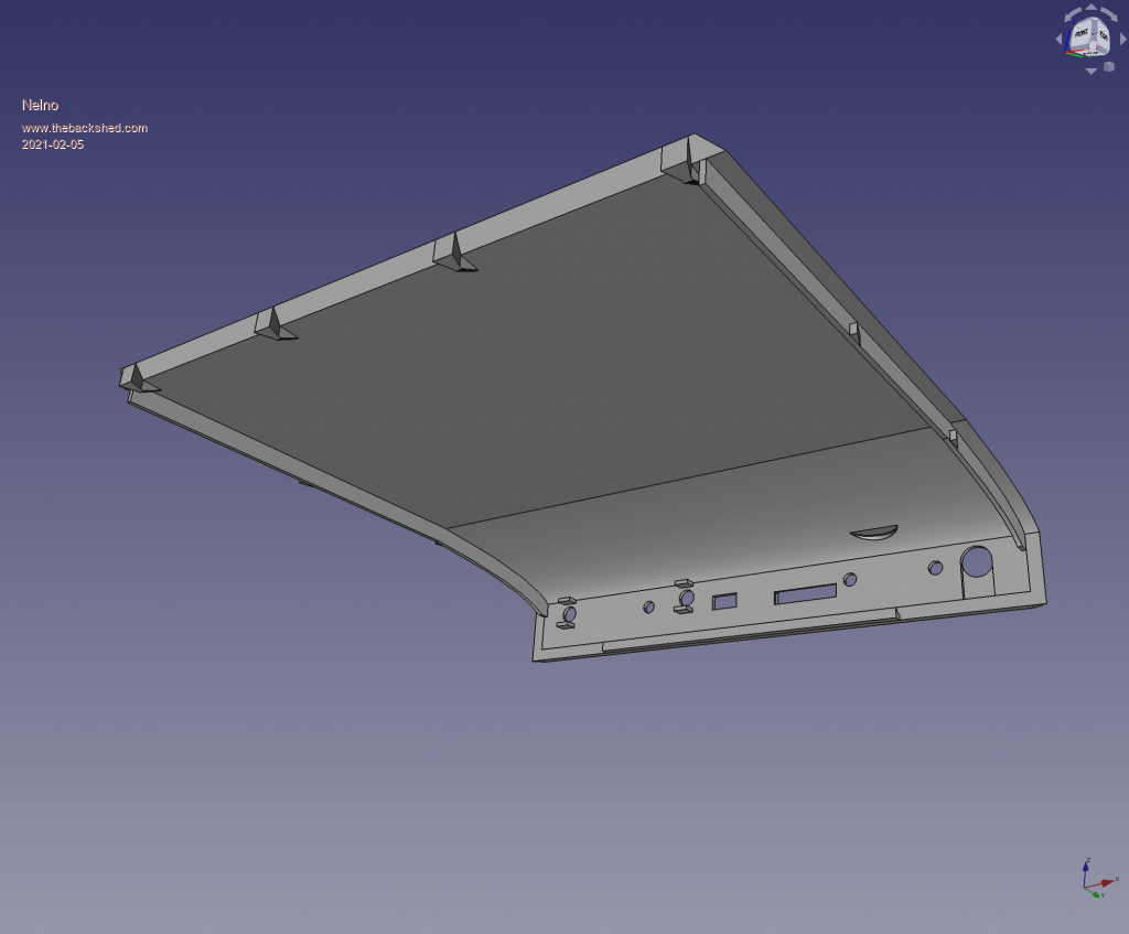

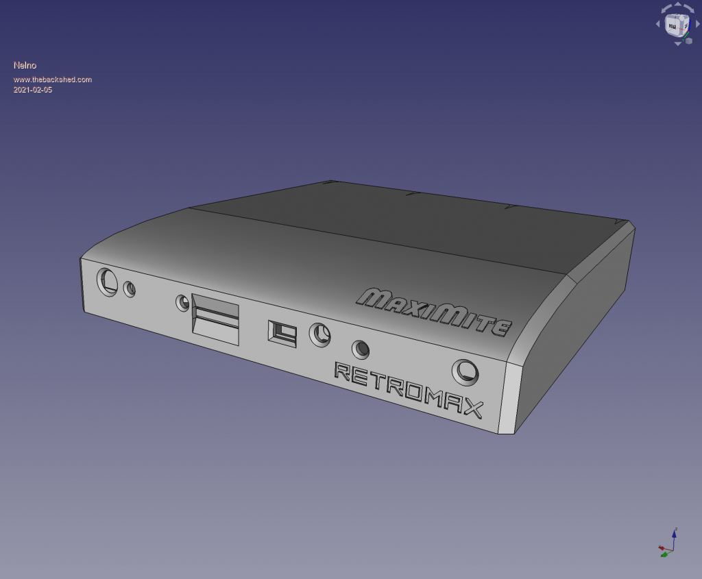

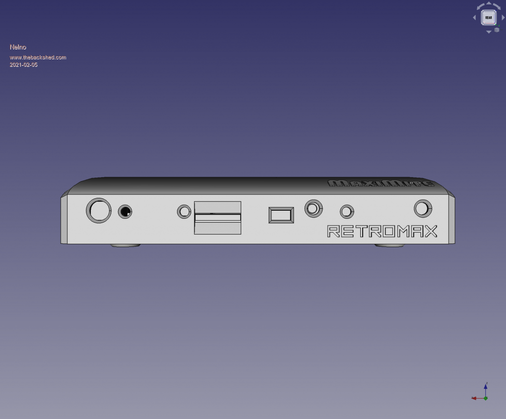

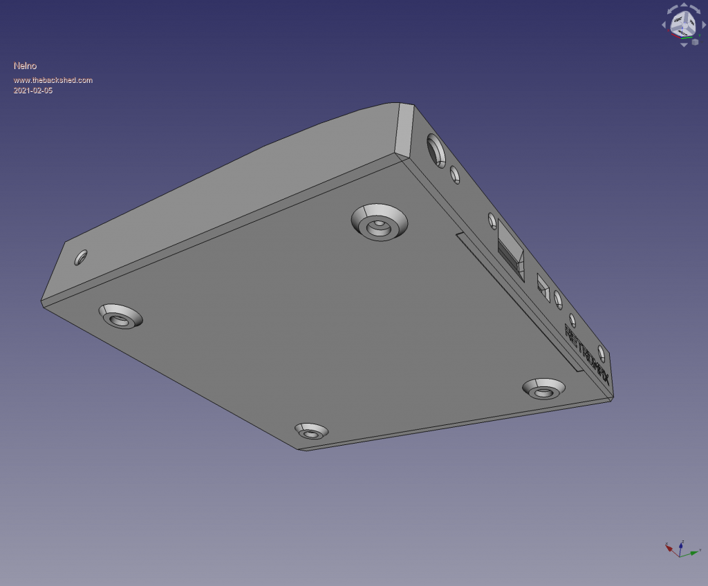

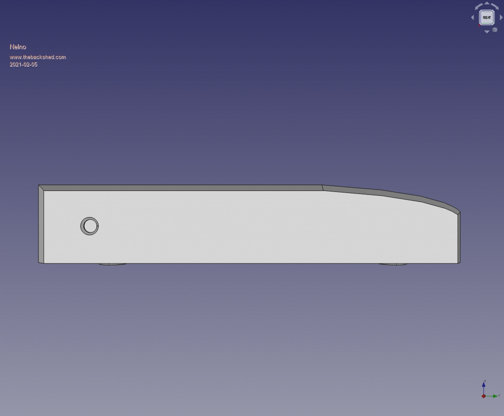

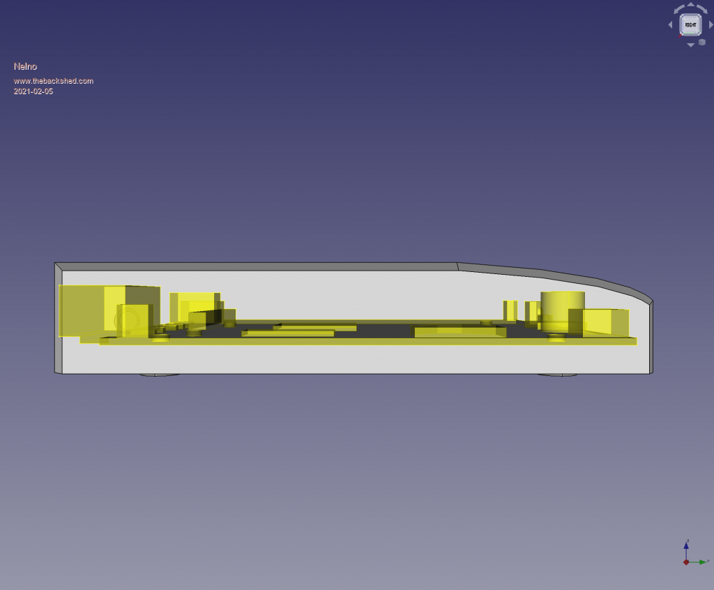

I made a custom, 3D-printable case for my Retromax. This case is fully printable without any supports and snaps together. The PCB can be secured with screws, but also snaps in. The power and reset buttons just rest in the case on ledges and sit against the microswitches on the PCB. I use a little piece of heat tape over each to keep them in place when snapping the case together and they're perfectly functional.
The nunchuck ports on the back fit a nunchuck plug, as long as you remove the large, transparent clip from the top of the plug. It was just too bulky to accommodate a minimalist case design, imho.
I didn't bother to cut out a hole for the 40 pin connector in this version. I plan to, and provide a cover that snaps in.
I don't know why I bothered to do this, other than I just wanted a custom case and a project to spend several weeks on :). There's nothing wrong with the original Retromax case, I just wanted something different. This is almost exactly the same size as the original case, but about 1 cm taller to accommodate the curved top + the piezo buzzer and audio jack at the front of the board. Otherwise, it could probably be about 5 mm shorter.

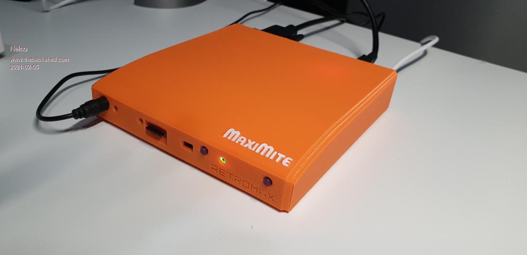

The example is printed with an FDM printer (Flashforge Adventurer 3 Lite) and is orange because I happened to have a spool of orange.
I recently bought a 4K 3D resin printer and will probably print my final version in that.  The detail will be significantly better at that point. For the moment, I'm liking the orange. The MaxiMite logo is sculpted into the case (generated from the actual logo) but I painted it (poorly) with some acrylic to make it stand out.

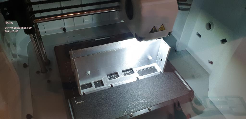

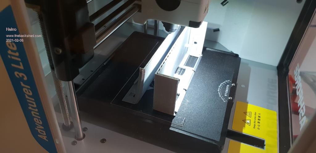

  PilotPirx said  Good work!!
But the curved upper side and the bottom with feets seems to be printed with support.
How did you get such a smooth surface? Not easy to print!
You can release your work in Thingiverse.
I have already published some drafts there.

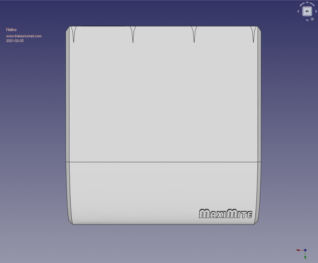

I assure you this was printed with zero supports of any kind. I hate using supports. This comes off the printer and is immediately usable without any post processing.
The top of the case is printed with the fron of the case on the bed. The bottom of the case is printed with the back of the case on the bed. So instead of printed flat, the are both rotated 90 degrees to stand upright.
When rotated that way, there are no over hands of more than 45 degrees.
Of course, it depends on the printer as to how well it can print the angled overhangs. My printer is not that great at overhangs, but it handed everything here with ease.
Unfortunately I cannot find any pictures that I took of it actually printing, though I a sure I took some at some point. If I print another I will take a picture of it on the bed for you.
I didn't do anything special for the surface. This printer is just pretty darn good for a $300 printer!! I've been impressed by it.
Thanks, I will likynput the files on Thingiverse once I am happy with them.

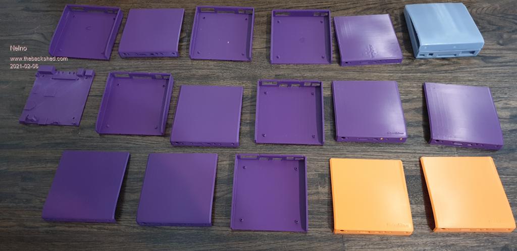

I probably printed close to 10 of these (at up to 12 hours print time) before getting it right.

  CircuitGizmos said  Hey this looks FANTASTIC!
That was a lot of hard work. I hope that people can appreciate the effort that went into this - especially printing many revisions and tweaking after each.
I'll happily point people to your files wherever you host them.
Thanks for the compliment. I don't really know how long it took, but here's a picture of the prototype cases I had in my "Box of Fail":
The gray one is the single prototype I tried on my resin printer. It, unfortunately, is going to need some supports to keep the raft from covering the ports on front and back.
Other than adding the pin header port, I had a lot of trouble getting the front to snap on easily and I'm still not sure I'm happy with that, even though this one worked well enough for me to bother painting it.
Here are some examples of how the pieces are printed. There are no supports on these at all.
Results with other printers may vary, but with mine, I don't have any issues as long as I have slopes of < 45 degrees for the overhangs. This is why the connectors on the back edge have to look like triangles. They cannot be printed in this orientation without the slope.
My slicing software is causing some issues on the left top case edge, though. You CA  see them in this print. This particular filament doesn't usually bond as well as non-metallic filaments and it seems to have exaggerated this issue.

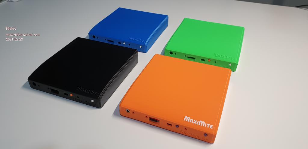

STL files for the Retromax case are up on Thingiverse: https://www.thingiverse.com/thing:4771521
I did not add a port for the pin header yet. If anyone finds that necessary, I can make time to do that soon. Mostly I am just not using the header right now and decided to do other things instead.

Like the colors . Especially green and orange. What Filament u use?
Plasma
Nelno
Joined: 22/01/2021
Posts: 59
Posted: 07:50am 27 Feb 2021
  Plasmamac said  Like the colors . Especially green and orange. What Filament u use?
The orange and green are both 3d Solutech brand filaments.
The green is called Apple Green
And the orange is just called Orange
The blue is also the same brand.
They are all relatively inexpensive, around $19 US for a 1 kg spool and I have had nothing but excellent print results with these filaments.
