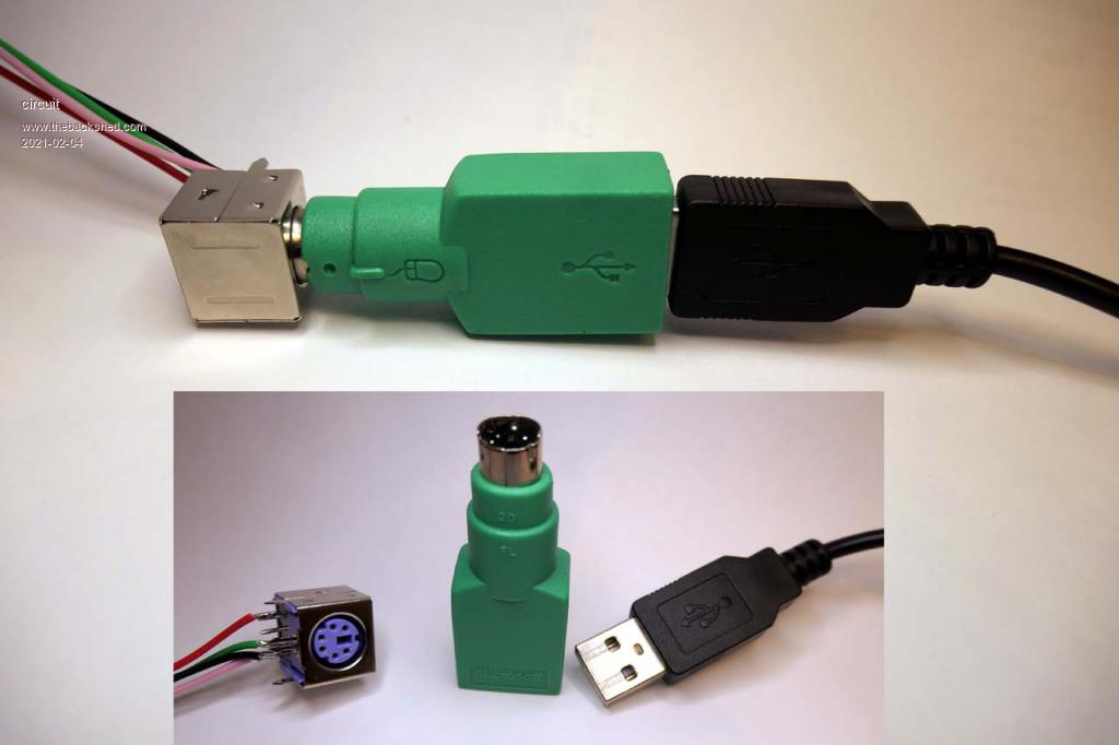

I have a keyboard connection to a MM Plus in the prescribed manner and it works fine with a standard PS2 keyboard.  The latter are becoming somewhat scarce and therefore I tried connecting a contemporary USB keyboard using an old Microsoft USB-PS2 adaptor as in this illustration.  It works perfectly!
My question is what is going on in the adaptor?  Is it in anyway active or is it just a wiring pass-through?  I am hoping that the latter is the case and that I might be able to cut off the USB plug and just wire a four-pin molex connector instead.  If the adaptor is in anyway active, what components would I need on my MM Plus motherboard to replicate its function?
Zonker

I don't think there is anything going on inside the adapter... Just a wiring pass-through as you have said... just change the plug... Should be ok...

What puzzles me is that the PS2 keyboard connections to the MM+ are "keyboard clock" and "keyboard data".  USB lines are "Dataline positive" and "Dataline negative".  How do these line up?
Posted: 02:50pm 04 Feb 2021
As you and Zonks have already said, there is nothing clever inside the green jobby, the work is being done by the keyboard controller. "early" USB keyboards were auto-sensing.
There was always the intent that such controllers would be stop-gap during the transition but it is only software so if it is costing nothing... a lot of modern keyboards will still support PS2 through such an adapter - evidently legacy software/module includes with the manufacturers either deliberately or just no-one has paid to have a turf-out/do-over. I wouldn't expect it to last forever.

  CaptainBoing said  As you and Zonks have already said, there is nothing clever inside the green jobby, the work is being done by the keyboard controller. "early" USB keyboards were auto-sensing.
Thank you - that clarifies things enormously.  So, upon detecting a clock signal the keyboard is reconfiguring itself so that the USB wiring "data minus" line becomes the clock line.  Excellent!  Out will come the wire-cutters and the "gang of three" will be reduced down to a simple four pin Molex.

Before you start hacking plugs off, why not change the PS/2 jack to a USB jack?
Also, my experience with mice and the CMM2 suggests that pull-ups on the 2 signal lines may be required to put a dual mode device into PS/2 mode. 2.2K, 4.7K, 10K ohm all seem to work. I've used 2.2K pull-ups to 5 volts - make sure the 'mite pins can handle it!

  lizby said  I'm trying to understand what this signifies. If you have an older USB keyboard which is likely to have the auto-switch firmware, you can connect USB "data minus" to a keyboard clock pin on the ARMmite F4, and USB "data plus" to the keyboard data pin, and all will automagically work?
That will be easy to try with a USB breakout board if true.
Whoops! Sorry, I think I got that the wrong way around; I think that it is the "Data Plus" that connects to the clock pin of the MicroMite Plus- I am still tracking out the wiring through the converter.
With respect to the pull-up resistors, in the MMPlus manual Geoff indicates that weak pull-ups are invoked (I presume with the "OPTION KEYBOARD language") and of course the pins designated for the keyboard are 5 volt tolerant.  I have not checked out the situation with the ARMITE F4 - the sparsity of documentation is an issue.  Given that Lizby is raising the question, I presume that we are talking of the STM32F407VET6 board.  Is there a listing of the OPTIONS available for this board?  I seem to have missed this but would much appreciate a pointer to one if it exists.

Correct - PS/2 clock connects to USB D+.
Most PS/2-USB converters include two 4.7k pullup resistors but that can vary.

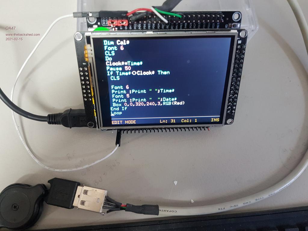

I decided to check through my collection of keyboards with usb connection that will support PS2 and other than a couple of Msoft versions I was delighted to find that some small flexible (roll up) keyboards that I purchased from the local Woolworths store for a couple of dollars do also work.
