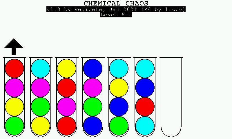

I thought it might be fun to try to port vegipete's excellent ChemiChaos to the Armmite F4 (which, to my mind, remains the best and least expensive of the all-in-one ports of MMBasic (though lacking in the graphics capabilities of the CMM2)).
For those not familiar, the F4 is based on a STM32F407VET6 board , includes USB programming, an RTC, a micro SD socket, a winbond flash chip, and a high-speed, 16-bit LCD interface. Board and LCD can be had for around $25US. Larger LCDs up to 7 or even 9 inches are possible.

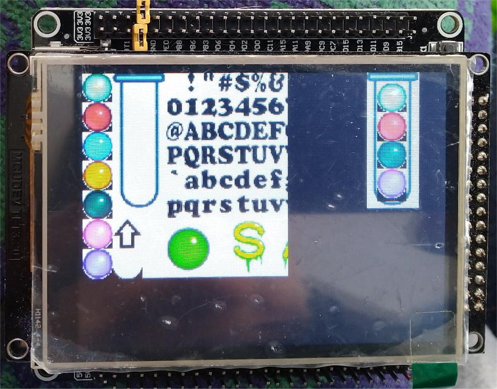

I've never written a game, and prior to CMM2 had not played one since arcade Pac-Man and Space Invaders on a Xerox Alto/Bravo in the early 80s. So it would be a learning experience.
I downsized Pete's "ChemiChaosSprites.png" file to a 320 pixel width, keeping the aspect ratio, and turned it into a bmp file. Downloaded with XMODEM RECEIVE and then LOAD IMAGE "ChemiChaosSprites320b.bmp". So far, so good.
(Note: the LCD is crisp compared to this photo.)
I cleared some space on that image and did some BLITs:
box 180,0,140,240,0,rgb(black),rgb(black)
blit 27,0,250,0,46,120
blit 0,0,259,10,26,26: blit 0,26,259,36,26,26: blit 0,104,259,62,26,26: blit 0,156,259,88,26,26
Again excellant.

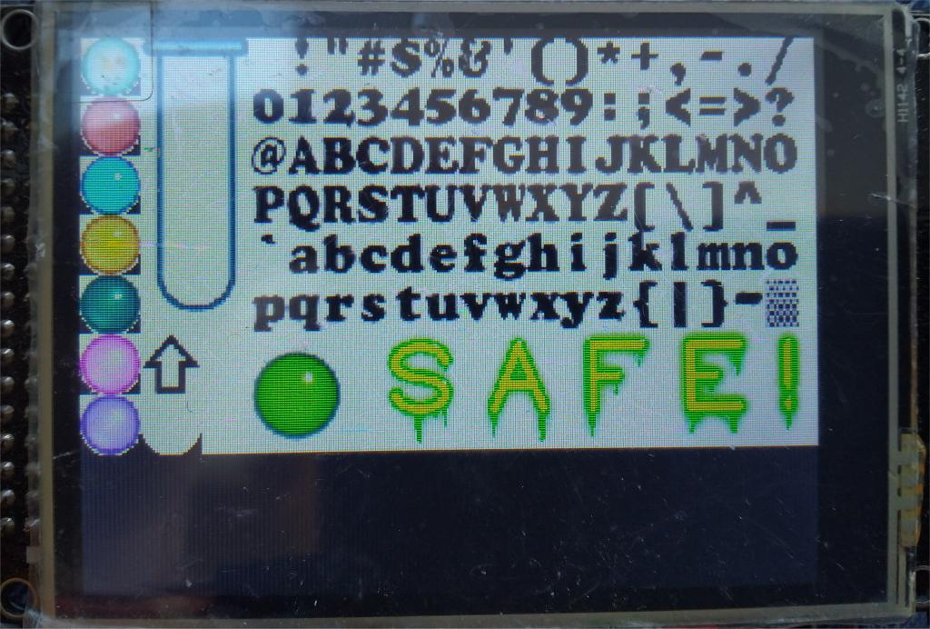

There is no F4 manual, so documentation of the commands chain back to the Armmite H7 manual, the Micromite Plus, and the original Micromite manual. The H7 says "The BLIT and SPRITE commands can be used interchangeably. All Micromite Plus functionality is preserved with minor functional changes."
However, for the F4, SPRITE 27,0,250,0,46,120 yields "Error: Unknown command", so BLIT it is, and as far as I can tell, only the Micromite Plus commands.
BLIT READ #1,0,0,26,26: BLIT READ #2,0,26,26,26: BLIT READ #3,0,52,26,26: BLIT READ #4,0,78,26,26
The above works to save 26x26-pixel bit areas into 4 numbered buffers (sprites?!). It turns out because of the resizing, some of the balls are 26 pixels high and some are 25.
After fiddling, I am able to make 9 BLIT buffers (7 balls, one arrow, one test tube. Then I can produce this:
Here's the code.

The images aren't perfect, but should be good enough so that I can try to start in on Pete's game code. I still need to produce a down arrow (probably on the PC), since I can't see that there is a way to rotate the BLIT buffer.

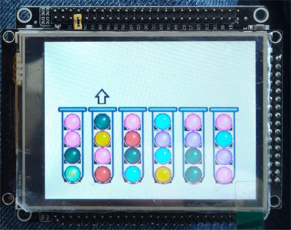

Success. ChemiChaos on youtube.
My porting method was brute force. After setting up the 12 sprites (blit buffers) and changing the text to be output with the TEXT command, I simply ran the program on the F4 until it crashed, usually at a BLIT command with invalid parameters or a SPRITE command. I then fixed that and ran until the next "Invalid syntax".
I made most changes on the PC and did "XMODEM R "ccf4.bas", but if the change was simple (a value or a statement or two) I used the MMBasic editor (and also made the change on the PC). I probably used XMODEM R 50 times or more.
I tried to make it so it would run on either the CMM2 or Armmite F4. I set up a variable, cputype%, initialized it to 0 for CMM2, and checked for mm.device$="ARMmite F407" to set it to 4. Then at each necessary point, I checked cputype% and executed either CMM2 or F4 code. I have not yet gone back to see if the code works on the CMM2.
As I expected, except for the graphics parts, vegipete's game code just worked. They may be some exceptions I haven't tested yet. The bottoms of the balls (black) are transparent on the CMM2. I saw some suggestion that transparency might work on some LCDs, but didn't investigate when it didn't on this 320x240 model.
I didn't make allowance for the 480x272 or 800x600 LCDs which can be fitted (with an adaptor) to the F4--I just plugged in magic numbers for the 320x240. I may fix that later.
Code is attached, along with the ChemiChaos320b.bmp file.
Thanks, Pete, for the fine and fun code example.

Posted: 03:22am 02 Feb 2021
Playing through to the end revealed a few more bugs.
I shifted the vials left, but the 7th one shows up distorted. The balls appear correctly, though. For the games which have an 8th and 9th vial, they are off the edge of the screen, but the program handles them properly and you can complete the round.
Among the non-graphics things I had to change because the CMM2 commands are not supported by the F4 were MATH SCALE and MOD$ on the left of the "=" sign.
ChemiChaosF4.zip

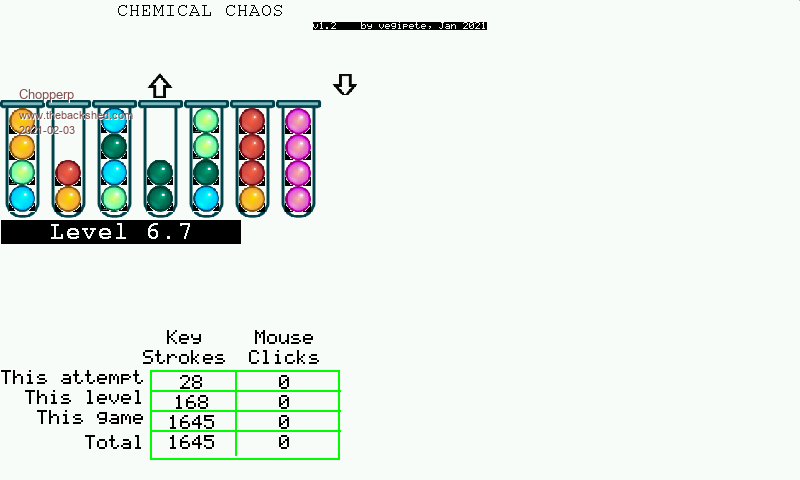

ChemiChaos screen grab on an F4 with 7" display stuck at Level 6.7
Only taking up about half the screen at this stage. More work to be done.
This would not be compatible with the CMM2 without further changes. Just playing at this stage. I didn't try to resize any of the graphics.
A number of changes done to lizby's great effort to get to this stage.
The Keystrokes table was off screen & had to be moved up. It then got partially erased in use after "Safe" came up & a key hit.
I could not work out why so I eventually modified the ShowCounts & ToggleCounts routines to refresh the table & still make it selectable On/Off.
The Level indicator was changed to a fixed text & relocated as the original moved down the screen if the "R" key was pressed.
Not sure where the spurious down arrow came from.
Thanks again vegipete for the great game.

Posted: 02:51pm 03 Feb 2021
Chopperp--good work carrying on. As you saw, I didn't implement any display of the statistics.
That round you're showing is the most difficult one. It took me 6 or 7 retries to solve it.
