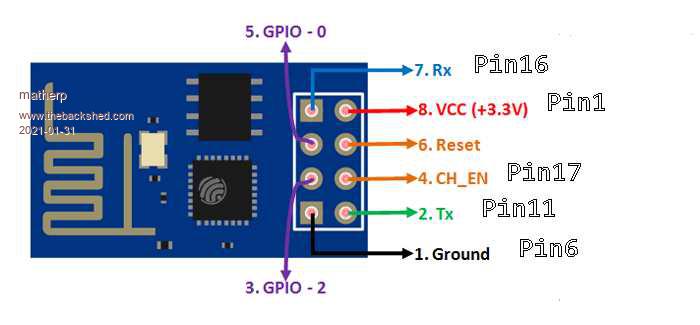

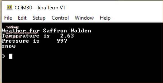

Attached is some code that uses the openweathermap.org api which is called using an ESP-01 with the default "AT" firmware. You need to substitute your own wifi login details and your own openweathermap api username and key in lines 3, 4, and 14 to get it to work. This is code I previously published to work on the Micromite eXtreme  that works without a single change on the CMM2 - Isn't compatibility wonderful
You can see from the local report why I have so much time for coding

getinput(10000)
Print "Weather for "+json$(m%(),"name")
Print "Temperature is ",val(json$(m%(),"main.temp"))-273
Print "Pressure is ",json$(m%(),"main.pressure")
Print json$(m%(),"weather[0].description")

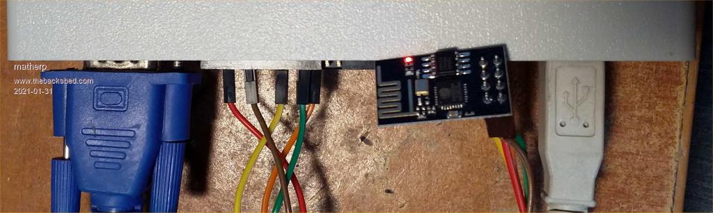

How is it possible for the regular CMM2 to access Wifi/Internet?
Is there a guide somewhere, or does it require the special 'deluxe' model?
Posts: 12185
Posted: 05:11pm 30 Jan 2021
This is for running on a regular CMM2 - just connect a standard ESP-01 to com port 2 and power it from 3.3V/GND (make sure the CH-PD pin is also pulled high) and you have network access

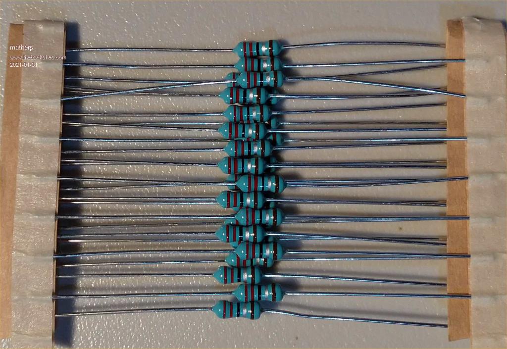

Posts: 4410
Posted: 05:35pm 30 Jan 2021
  matherp said  This is for running on a regular CMM2 - just connect a standard ESP-01 to com port 2 and power it from 3.3V/GND (make sure the CH-PD pin is also pulled high) and you have network access
@matherp
Didn't you say we shouldn't drive an ESP-01 from the CMM2's power rails a couple of months back because it can draw too much current under some loads?
Posts: 12185
Posted: 05:40pm 30 Jan 2021
Seems to test OK but put a 2.2R resistor in the 3.3V line and a 100uF cap across the ESP-01 if any problems
Edited 2021-01-31 03:43 by matherp
Posts: 4410
Posted: 05:46pm 30 Jan 2021
Did you really mean a 2.2 ohm resistor ... do they come that small, other than 0 ohm SMDs ?
Posts: 12185
Posted: 05:51pm 30 Jan 2021
Yes 2R2 as used already on the CMM2 in the power supply to the SDcard. Together with the cap just slows the spikes slightly
Edited 2021-01-31 03:54 by matherp

Posts: 4410
Posted: 08:14pm 30 Jan 2021
  matherp said  Yes 2R2 as used already on the CMM2 in the power supply to the SDcard. Together with the cap just slows the spikes slightly.
Thanks Peter, I've learnt (and ordered) something new. I think providing photographic evidence that such resistors exist was overkill though

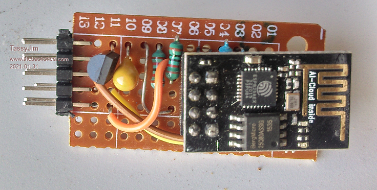

Posted: 08:30pm 30 Jan 2021
I used the 5V supply with a 3.3V regulator for my ESP interface.
I also used com1 so that all the pins are together on the expansion port.
Thank you for json, I wasn't looking forward to doing that in Basic.
Posted: 10:32pm 30 Jan 2021
Jim--what high-current 3V3 TO-92 regulator did you use?
Posted: 11:08pm 30 Jan 2021
  lizby said  Jim--what high-current 3V3 TO-92 regulator did you use?
MCP1700
Posted: 11:15pm 30 Jan 2021
Ok, I've got some of those--in Box #10, my notes say, if I can find that.

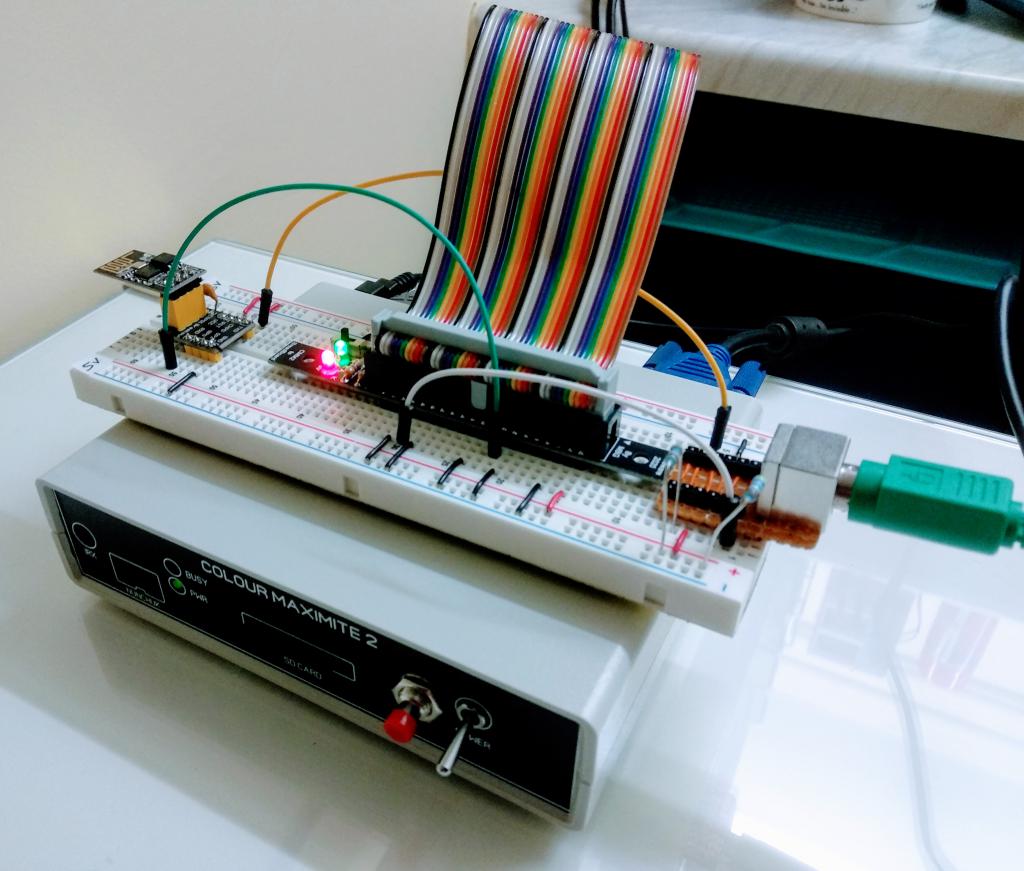

Posts: 4410
Posted: 01:40pm 31 Jan 2021
Thanks for providing a morning's amusement Peter.
I found I had to replace:
dim b$= "GET /data/2.5/"+report$+"?id="+MYID$+"&APPID="+APIKEY$
with:
dim b$= "GET /data/2.5/"+report$+"?q="+MYID$+"&APPID="+APIKEY$
Otherwise it complained that "manchester,uk" was not a valid city, which I thought was rather opinionated for a computer
I've also found my ESP-01 module to not be terribly stable, sometimes it works, but othertimes it only flashes its LED on initial power-up and then will refuse to flash it further or make a connection. It will then stubbornly refuse for a while whilst I faff with the cables and switch things on and off a couple of times, or attach it to an external power supply and then it will decide it will work again after all even when connected back to the CMM2 3.3V power rail ??? Maybe that resistor and capacitor will help when the former arrives. TBH I'm not convinced that the 3.3V rail is always supplying 3.3V ... sometimes I'm measuring as low as 2.8V - though I must acknowledge there may be a certain amount of incompetence involved.
Anyway, if we get many more upgrades then I think I'm going to need a bigger breadboard:

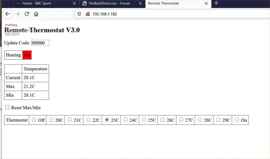

Here is a simple webserver using the ESP-01 in tcp server mode. Just substitute the login for your network in lines 8 and 9
