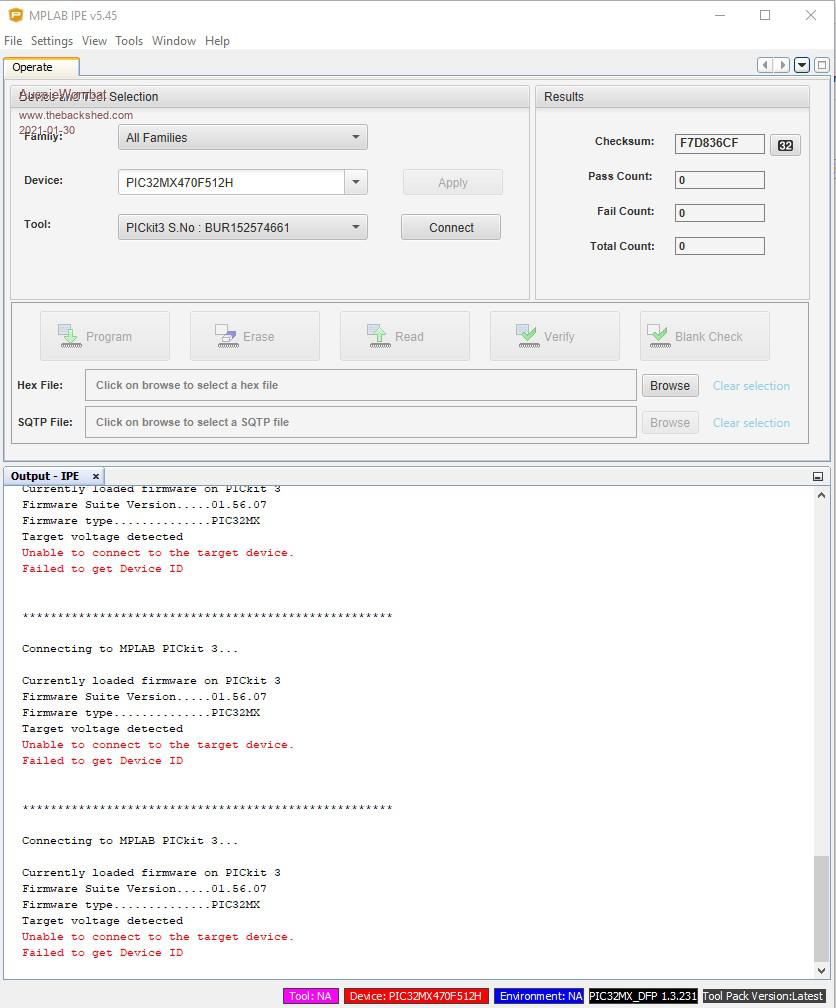

Hi All,
I have managed to get the MPLABS X IPE to communicate to my Pickit3.
But I still can't get the MM+ to connect.

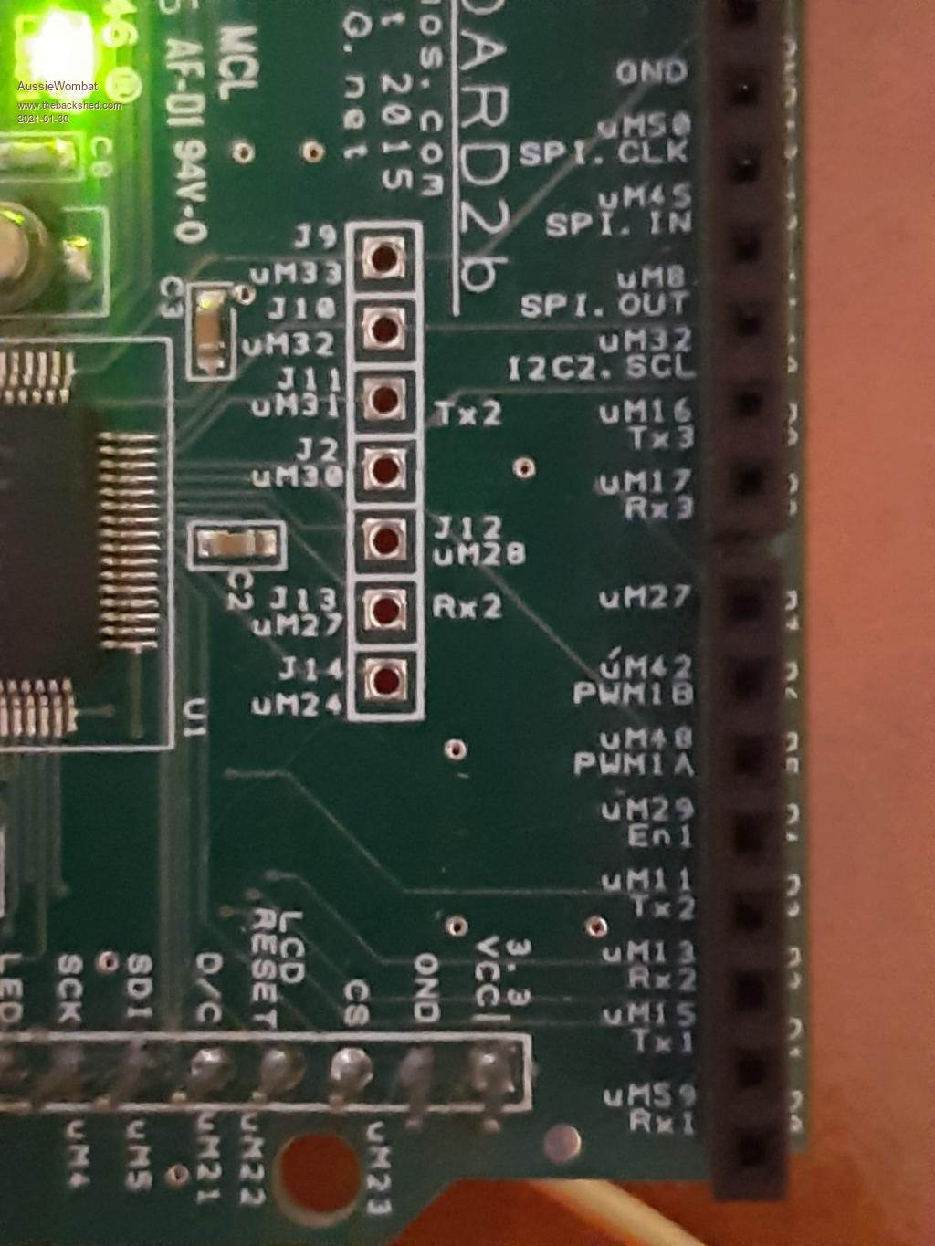

According to Gizmos page I should connect PGD to uM16 and PCC to uM15.
But on my board the silkscreen print identifies uM16 as Tx3 and uM15 as Tx1
On Circuitgizmos page both uM15 and uM16 are listed as Com3 Tx
CONFUSED.

Hi all,
Well I finally got the device to talk to the pickit3, and updated to latest update. seems the Dupont wires I was using must have been slightly loose. Put a slight bend in them to make a snug fit and voila. Who knew.
Sorry for being a nuisance.

On the 64 pin chip there are two set of PCG/PGD pins.
PCG 15 or 17
PGD 16 or 18
You can use either set. The pins can have other functions, as long as they don't have external stuff connected to them when you are trying to program it. e.g remove LCD if it uses the pins.
uM16 as Tx3 and uM15 as Tx1 is correct but not really relevant to the issue unless something is connected to them.
