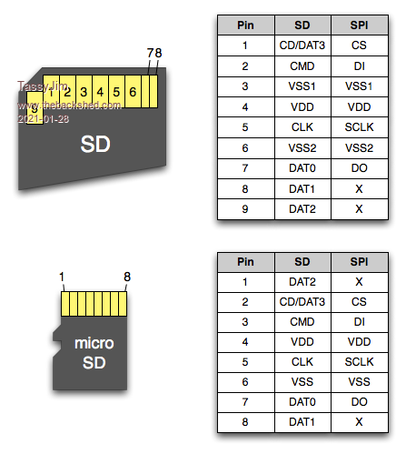

There are a few lines to check.
I used this spreadsheet when I put my first breadboard system together.
The pin numbers refer to a full size card holder but the designations are the same.
This image gives you the pinout for the microSD
The pin numbers on the CPU are:
PD2   144
PD3   145
PC10  139
PC11  140
PC12  141
PH12  89
On your board, WP is not available so PH12 (pin 89) will be tied to ground.

Thanks, I had tested all of those at some point but this inspired me to go back and do it again, and I found the problem.
The first issue was the broken trace that was pulled off when I accidentally bent the card socket up, but that was indeed fixed. The remaining issue was that I had two pins that weren't touching the pads. They looked like they were touching but just had a little less solder on them.
When I was testing for continuity I was putting the probe on the pad just next to the pin and not on the pin itself, so I mistakenly thought they were connected. I knew better, but that's what I get for doing things at 4 am when I'm half asleep.
It's all working now. I will de-solder it this weekend after I have some high-temp epoxy come delivered, repair the delaminated pads, overcoat the fixed trace, and it should be good as new.
