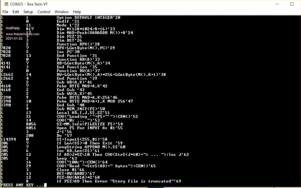

Posts: 11891
Posted: 07:42pm 21 Jan 2021
Watch this space - coming tomorrow a full profiling capability for the CMM2 in V5.07.00b6
The attached shows for each line of a program the number of times a particular line has been run and the average time in uSec that each time took to run.
The text is the program line as it really exists in memory after the crunch that the CMM2 applies except that the single byte command and function tokens are expanded to make it readable.
The overhead of enabling real-time profiling is about 5%
