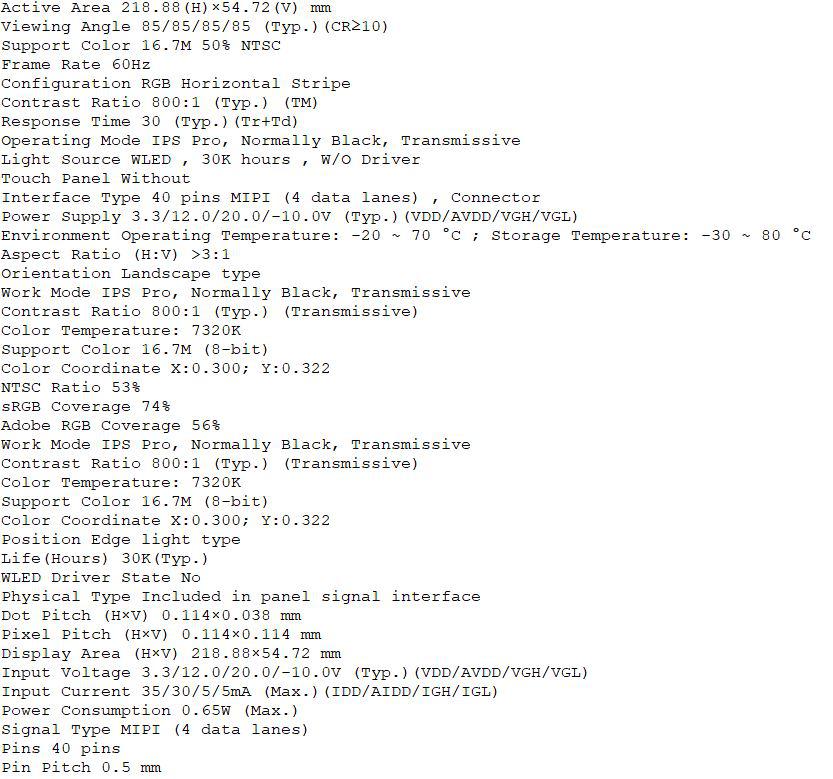

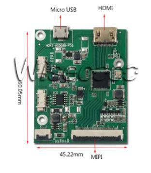

Posted: 08:12am 21 Jan 2021
This is what I could find on it
it seems it uses a HDMI to MIPI interface board and the power is got from the USB connector
it's designed for use in car dashboards

Posted: 10:07am 21 Jan 2021
I would like to know what part number that HDMI/MIPI conversion chip is. I could then look it up for some juicy hardware details! Sadly all the pictures I've seen of that adapter PCB are so poor there is no chance of getting a part number from them.
