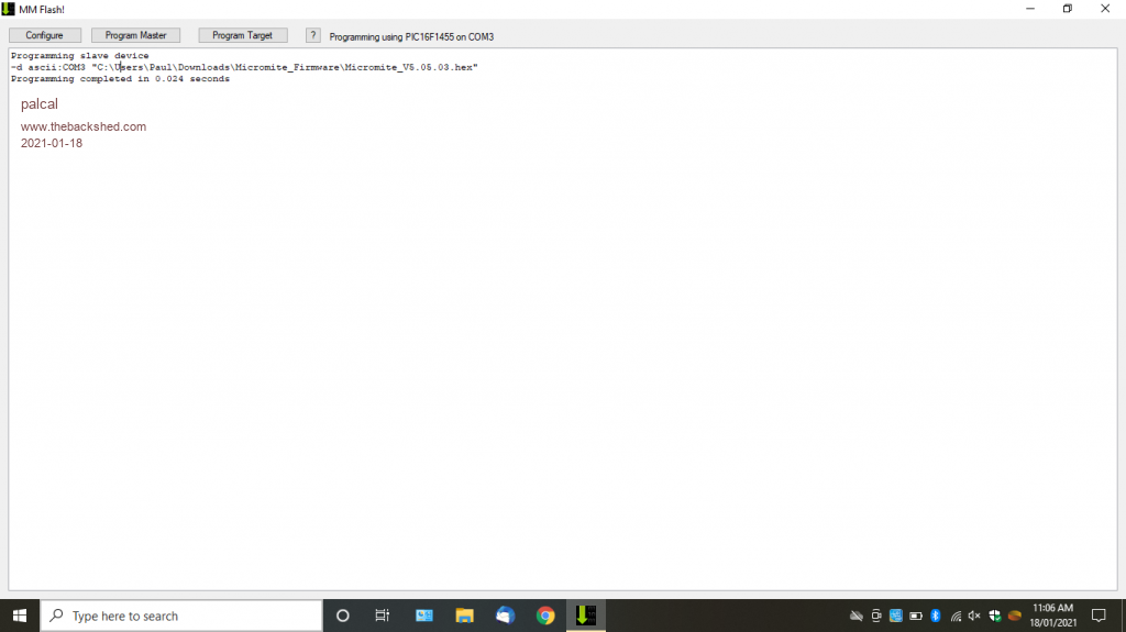

I think I understand it now, I am programming through the 1455. Don't know why I need the PGC and PGD pins, I thought the 1455 would take care of that.
It seems to work, runs through everything and says it programmed but it only takes a fraction of a second and does not program the chip. I don't think I will bother with it, don't know if it will work on Linux anyway but it seems to do the same as on Windows. If I have to use Windows to flash the chips so be it.
This is what MM.Flash says
Edited 2021-01-18 11:09 by palcal

I also receive this file.
  Quote  [Windows]
; Main Window
MainX = -3
MainY = -8
MainW = 1366
MainH = 705
; Config Window
ConfigX = 200
ConfigY = 200
ConfigW = 492
ConfigH = 295
[micromite]
uM SerialSpeed = 57600
LineDelay = 150
PGD = 4
PGC = 5
MCLR = 1
[Arduino]
A SerialSpeed = -b3
[General]
Master Device = PIC16F1455
MM Program = pic32prog.bas
HEX File = Micromite_V5.05.03.hex
HEX Folder = C:\Users\Paul\Downloads\Micromite_Firmware\
Max port no = 32
comport = COM3
Posts: 6607
Posted: 02:39am 18 Jan 2021
That file is just the settings that get remembered between sessions.
If you delete it, the default settings get used next to.
MMFlash and Rob's GUI are both wrappers for the commandline tool so if one doesn't work under Wine, it is most likely that the other one won't work either.
