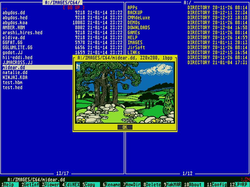

because of need in Napoleon Commander, I wrote small graphics library and finally thought it could be useful also in other projects, so I moved it to separate repository. Right now it can just few things:

These are the SUBs I use in my FileManager to get image info:

You are welcome to use them as is or parts of them.

maybe is time again to refresh the graphic library (GitHub) and extend it. right now it supports this:
Info and loaders for following formats:
General : JPG, GIF, PNG, BMP
Atari ST : PI1, PI2, PI3, PC1, PC2, PC3
C64 : DD,HED, KOA, HBM
ZX Spectrum: SCR, BSC
Also can save BMP in 8- and 16-bit colors.
It could be interesting to add some other formats (BBC, SHARP, SORD, MSX...), but I need help from you... If somebody knows (owned) some (mainly 8-bit) computer and knows his graphics formats and (in best case) can help with loader, it will be very nice. I'm still missing some important C64 format, but also maybe Amiga IFF can be nice to have.
