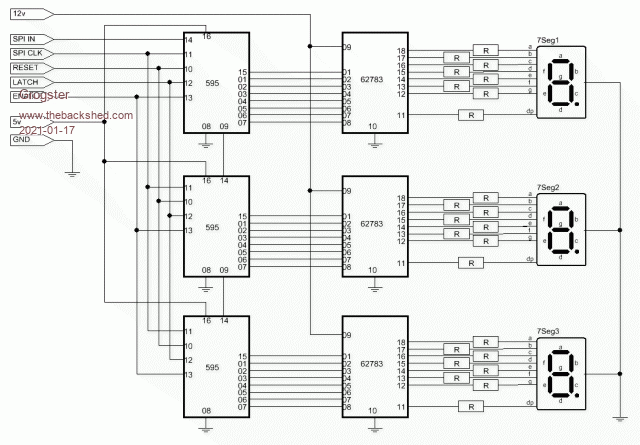

Posts: 10114
Posted: 05:44am 17 Jan 2021
@ vegipete: This is how I plan to connect things up....
Does that look like how you would use the 62783's?
Basically, the 595's drive the 62783's, which then drive the large LED common-cathode displays using a 12v LED display voltage.  Value of R yet to be determined.
I would very much appreciate your comments, as you have obviously used these chips before, so I want to make sure I am correctly understanding how to connect them, as I had never heard of them before you posted the part number.
Not shown in the schematic, are 100n caps on all chips' Vcc pins.
vegipete
Joined: 29/01/2013
Posts: 1193
Posted: 08:18pm 17 Jan 2021
I just grabbed a circuit board to compare and it looks like you have essentially matched it. We run series strings of 5 red LEDs from 12 volts using R = 100 ohms. (Actually, 3 strings in parallel, each with its own resistor.)
We use the AFG version of the chip, which works well driven directly from the pins of a 5 volt MCU and should work equally well from the '595s. There are other versions of 62783 that work at other input voltages, just to be aware.
Our PCB is a large 2 digit 7 segment display, so it uses two of theses chips. One of the extra outputs directly drives a smallish 12 volt relay, the other drives a MOSFET PWM display dimming circuit. After over a thousand boards, these chips have never failed.
Posts: 10114
Posted: 01:25am 18 Jan 2021
Excellent, thanks very much for the confirmation.  I had read the datasheet for the 62783, so I was reasonably confident I was wiring them correctly, but it never hurts to ask someone else who has actually used the chip in question, if you(me!) have never used that part before.
Yes, I have ordered DIL versions of both the 595 and the 62783 from Digi-Key.

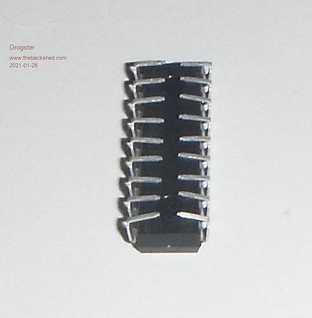

The chips are laser-engraved with "CHINA", so I was at first worried that these might be clone chips, but buying from DigiKey I figure I can be sure they are genuine.
I blew the first one up by putting Vcc and GND the wrong way around, cos I was looking at my PCB design, and forgot that I put the chips on the C2 layer!!!!
Ah.....opps.....
"I think the phrase rhymes with 'Clucking Bell'" - Blackadder.
But the 2nd one I made sure I connected correctly, and it is working fine.
I bought a whole heap of these chips to maximize the DHL courier cost, so I will write this one off as an "Aragog"....

vegipete
Joined: 29/01/2013
Posts: 1193
Posted: 06:33pm 28 Jan 2021
Aragog? I think your picture is of an oh so special surface mount DIP.
