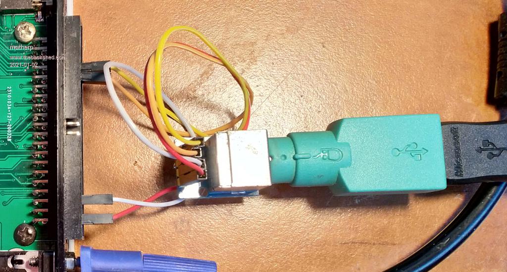

First PS2 mice are now supported connected directly to the CMM2. Many current USB mice still support the PS2 protocol and the current Microsoft Basic Optical Mouse is fully tested and recommended.

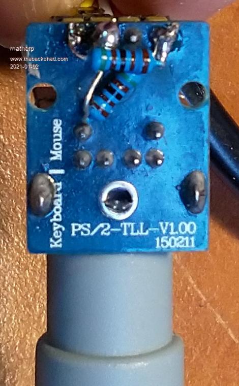

To make the connection I use a PS2 connector breakout and USB/PS2 adapter. The mouse clock line is connected to pin 33 of the CMM2 and the mouse data to pin 32.
These lines must have pullups to 5V fitted. I've used 5K1 resistors as I have run out of 4K7 which are recommended

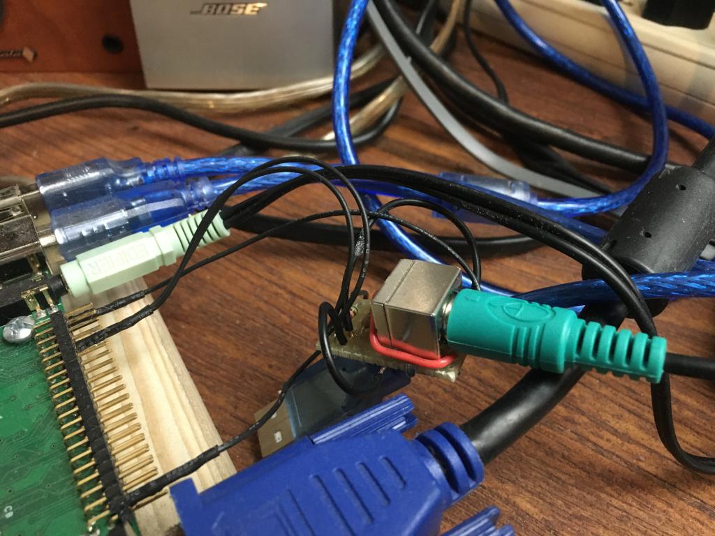

In the meantime I was playing with exactly the same think (PS/2 mouse direct on CMM2) and tryied to communicate with MMBasic, but I was unsuccessful. Also my connection is similar, just swapped DATA and CLOCK...

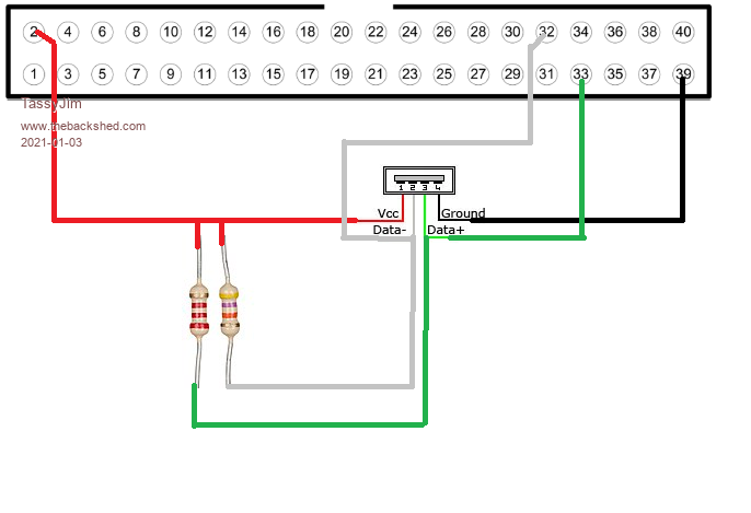

With 2 4.7k resistors and a USB socket wired to pins 32 and 33, I have a nice working mouse at the right price.
The Clock line (pin 33) goes to D+ and data (pin 32) goes to D-
If you get it wrong, no smoke is released.
If you are cutting a USB cable to use, the green wire is probably D+, white D- red +5V and black for ground.
I have seen cables that don't follow that convention.

  TassyJim said  If you are using a USB mouse, there is no need for the adapter.
Errr... Jim, how does that work? I obviously don't understand D+ and D- transmission.
I think I see a 4K7 and a 2K2 pullup. Is that combination important or is the 2K2 there because your toolbox ran out of 4K7's.

  Quote  If you are using a USB mouse, there is no need for the adapter.
This one kind of confuses me.  If you are using a USB mouse don't you need the HT USB host or am I missing somthing?
Jim, You make the best wiring diagrams but can you give one with the proper connections to the PS/2 female port.  Thanks.

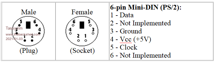

Posted: 04:57am 03 Jan 2021
PS/2 connector.
"Some" USB mice work as PS/2 with an adapter.
Peters photo shows one connected.
Because I will be using this type of mouse, I can dispense with the adapter and plug directly into the USB socket. When I want to use a PS/2 mouse, I need to use an adapter which is the reverse of the adapter that Peter used. (It is also the one I originally used.) I made an adapter out of a couple of suitable cables.
Some USB mice are happy as PS/2 but only some.
If your mouse is happy as PS/2, there is no need for the HobbyTronics chip.
The Microsoft mouse I mentioned earlier is one such currently available mouse.
Is the resistor on the right 100 Ohms (Yellow, Purple, Orange)? What about the one on the left? I can't really tell the colors from the photo.
Edited 2021-01-03 17:11 by toml_12953
Posted: 08:18am 03 Jan 2021
Both resistors should be 4K7 but the value is nor critical
