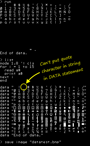

It seems that DATA statements can hold strings with characters with ascii codes greater than 127, but the READ statement cannot read these characters. (CMM2, 5.06.00)
This program demonstrates this: datatest.zip
If you run the program, your get the basic characters and some minor weirdness.
But if you list or edit the program, you see a whole lot more.
Is this true of MMBasic in general or just the CMM2? Is this as intended?

Standard across all versions of MMbasic. In the tokeniser:
   // first, make sure that only printable characters are in the line
   p = inpbuf;
   while(*p) {
       *p = *p & 0x7f;
       if(*p < ' ' || *p == 0x7f)  *p = ' ';
       p++;

Here is what it looks like:
Yes, maybe I used some trickery to get the characters into the DATA statements in the first place, but that is my prerogative. Yes, screwy things could happen when doing this but that is for me as the programmer to take care of. I just want a READ statement that reads exactly what's there and lets me mess up on my own terms.
Posts: 11891
Posted: 06:42pm 31 Dec 2020
Sorry - but as per my post this is standard across all versions of MMbasic in Geoff's code and not something I'm going to change

That tokeniser code doesn't explain what's happening.
The '& 0x7F' should strip the high bit, resulting in the normal characters appearing twice.
vegipete
Joined: 29/01/2013
Posts: 1185
Posted: 06:48pm 31 Dec 2020
MMBasic standard. Fair enough, it is what it is.

data "    Hold \[Alt\] to select rows or columns."
data "\[PgUp\] \[PgDn\] to move faster, hold \[Ctrl\] to move sideways faster."
data "\[Home\] to move to cell [A1]"
data ""
data "In general, \[Esc\] cancels the current operation."
data ""
data "Cells can hold 3 types of info: numbers, text or equations."
data "    To enter text, start with a quote character \[\'\]"
data "    To enter an equation, start with an equals sign \[=\]"
data "    A number starts with \[0\] \[1\] \[2\] \[3\] \[4\] \[5\] \[6\] \[7\] \[8\] \[9\] \[.\] \[+\] or \[-\]"
data "Press \[Alt\]-\[Enter\] to edit an existing cell"
data ""
data "When entering an equation, use \[\146\] or \[\147\] to switch to cell select mode."
data "    Choose cell with \[Enter\], \[ Space \] or )*+-/<=>\\^"
data "Cells are in [] brackets. Use $ for absolute reference."
data "In general, any MMBasic function can be used."
data "G","Sum(refcell to refcell) is also available."
data "\[Ctrl\]-\[K\] to recalculate entire spreadsheet."
data ""
data "\[Del\] and \[Backspace\] clear the highlighted cell or range."
data ""
data "For Cut, Copy and Paste, use \[Ctrl\]-\[X\], \[Ctrl\]-\[C\] and \[Ctrl\]-\[V\]."
data ""
data "Press \[Ctrl\]-\[Q\] to quit."
data ""
data "Press \[Ctrl\]-\[N\] to start a new file."
data "G","Press Ctrl-O to open a file."
data "G","Press Ctrl-S to save the current file."
data "END"
