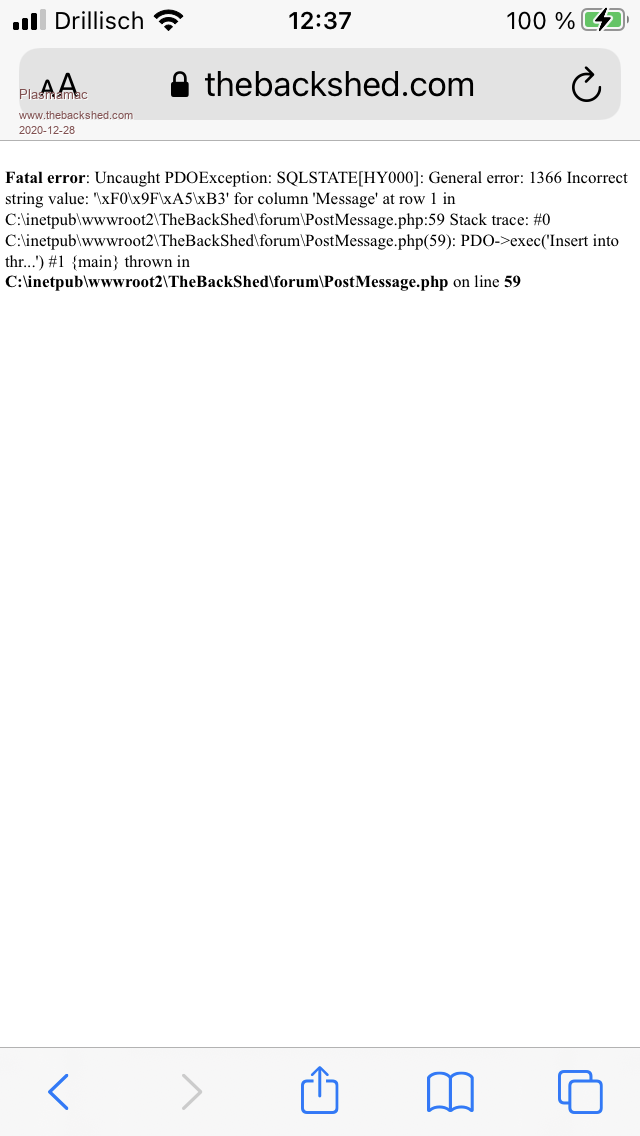

Again the well known 1366 ("illegal" Unicode characters) error?

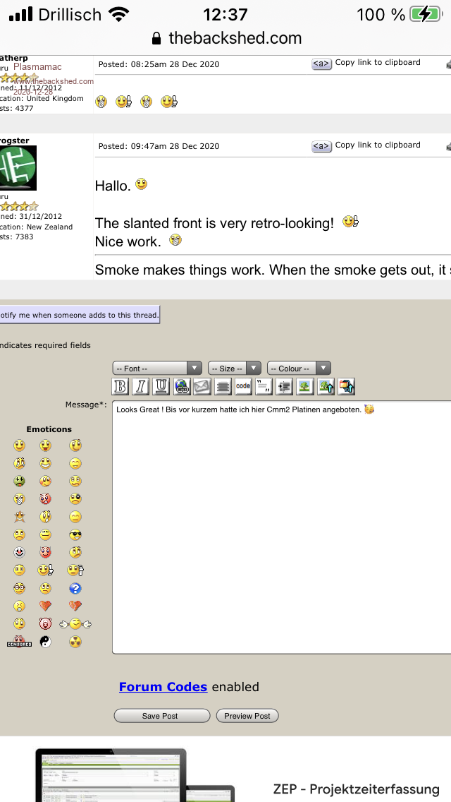

One pic Shows the Error . The Other is the Message i wrote.

It looks like you tried to use an emoji that the forum didn't like.
#define EM_SELFIE "\xf0\x9f\xa4\xb3"

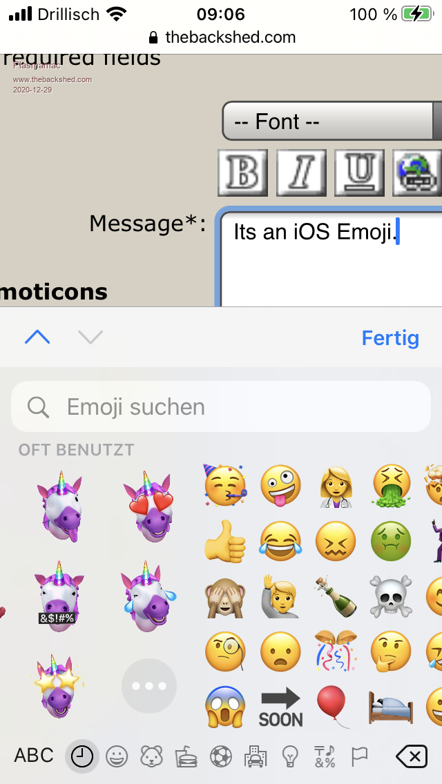

Is it a forum emoji, one you can click on from the list on the left, or is it from another source?
Also, what device are you using? browser?

Its an iOS Emoji . I am on Tour so i use an iPhone.

OK, I'll have to filter those iOS emojis out. One problem I'm having with the forum is finding a balance between user code and malicious code. Because users want to share code on the forum, I cant use the standard "filter out anything suspicious" approach.
Filtering out anything suspicious would include those iOS emojis, as they are not the emojis the forum has provided. But as we want users to share code, I've changed what gets filtered out, and the modified filter lets those iOS emojis sneak in, and they are breaking the forum code.
I plan to do some work to the forum code on the weekend, so will address this then. In the mean time, dont use any emoji other than the ones provided by the forum.
