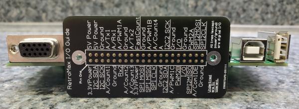

Hi , if iam not totally wrong i think the cmm2 Pin number are mirrored. Because the Port has a Pin 1 sign But the manual Says its pin number 40.

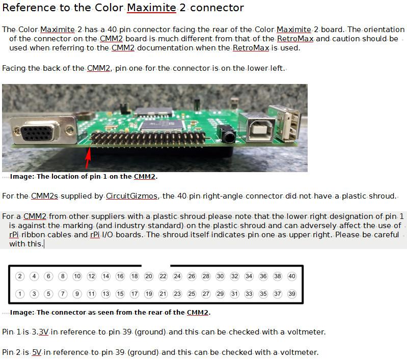

Is this what you are talking about?
  The Manual page 10 said  These numbers are used as reference in the table below and by MMBasic to refer to an I/O pin.
They are not the connector manufacturer’s standard pin numbers.

The image in my RetroMax documentation has a red arrow pointing to pin 1.

The RetroMax I/O guide in the back of a CMM2:

RTFM ! Sry
