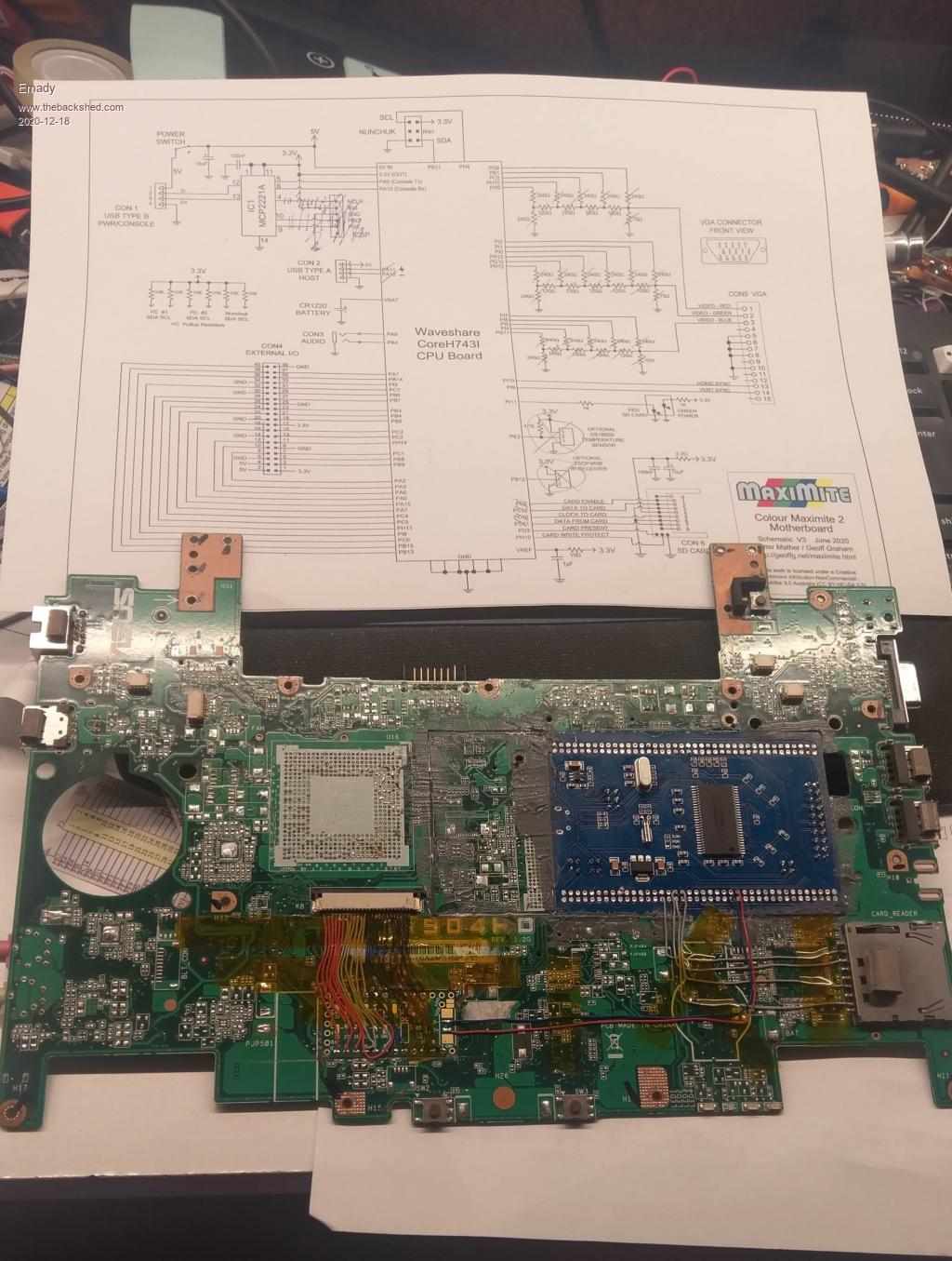

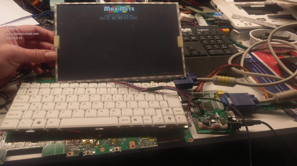

After a lot of lurking I have started my custom build of a CMM2. Initially I wanted to do my own PCB but decided against that. Instead I took an old eeePC netbook and used it as a donor in which I fit the STM32 shield and all other required parts.
The build is well under way, I have done the smoke test today and all went well
I wanted to use the original keyboard of the netbook so I built a USB Keyboard controller following this instructable:
https://www.instructables.com/How-to-Make-a-USB-Laptop-Keyboard-Controller/
I tested the controller on my laptop and it works great but when plugged in the CMM2 it does not work. Plugging a normal keyboard in the CMM2 works. Anyone tried a custom keyboard controller based on the Teensy with the CMM2?
Here are some photos of the build and the smoke test setup:
Any advice to help me make my CMM2 Netbook a reality?

Everything else is working, I got the original display to work, finishing off the battery charger and power supply, just this keyboard .....

Looking at the photo display loooks like wide AR, but CMM2 has 4:3 AR. The image woill be horizontaly disproportionaly stretched if display is really wide AR.
