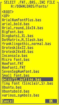

So I hope import also works, tested on some .BAS files in MMBasic Embedded Fonts directory and some .FNT files.
File selector in Import is terrible, because I bent down my info-box, but at least works...

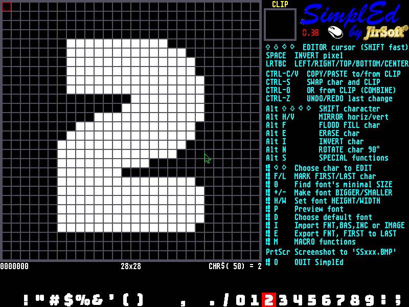

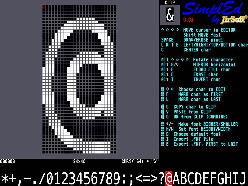

Some improvement in SimplEd:
Jiri

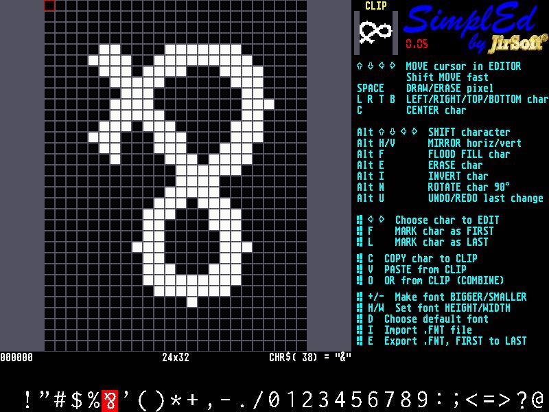

New v0.05
UNDO for destructive operations
ROTATE 90 degrees
much faster LEFT, RIGHT, TOP, BOTTOM and CENTER operations on bigger font
some bugfixes
Jiri

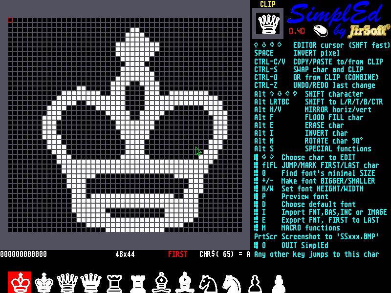

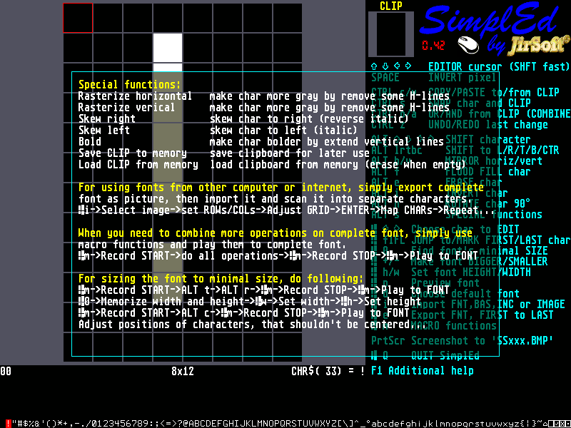

Some new screenshots:
Jiri
Posts: 4410
Posted: 07:06pm 13 Dec 2020
That is really looking impressive.

BIG news:
MACRO scripting
      you can record actions on one char and then play it to complete font, now limited to about 20 functions
      macros can be recorder, shown, played, erased
      for example record this macro:
      copy to clip, shift left, OR from clip, shift right to make char bolder
SPECIAL functions, prepared for extension
      rasterise vertical
      skew right and left
      can be included into MACRO
TUI.INC is removed from branch now, it can be downloaded from TUI.INC
(it's because of simple maintenance of  just one file...)
Enjoy!

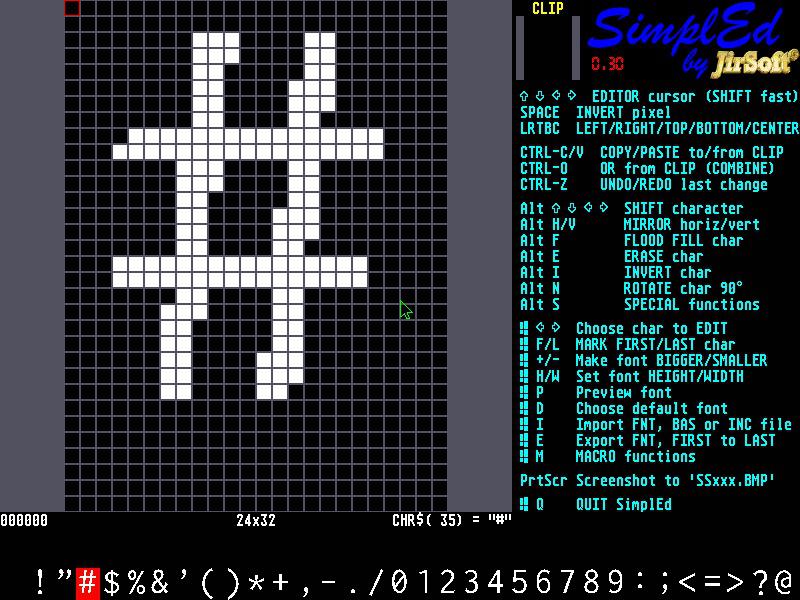

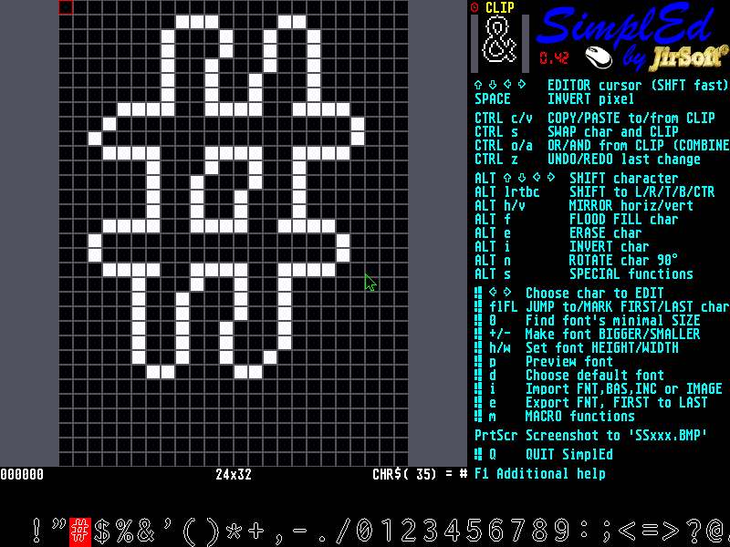

New version of SimplEd (0.30) with basic mouse support:
1. in editor: LEFT button sets pixels, RIGHT button clears pixels (both also set cursor)
2. in character set: LEFT button chooses character from set
3. in CLIP: LEFT button copy active char to clipboard, RIGHT button from clipboard, MIDDLE button OR from clipboard
Jiri
