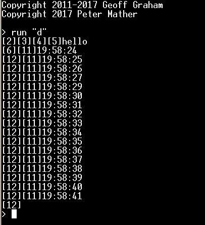

It could be one of the bugs in Pi-Cromite
I changed the time to 5 seconds
it just loops between lines 11 and 12
TRACE ON
SetTick 1000, UpDateTime, 1
Print "hello"
Pause 5000 ' 5 seconds
Loop
End
Sub UpDateTime
Print time$
End Sub
If I don't use SETTICK then it works perfectly
I kinda need settick to keep a clock running
EDIT is there a way to keep the program running but only doing what it says in the settick? as in using 2 setticks?

Posts: 6607
Posted: 08:05pm 05 Dec 2020
OK
It looks like the Pi PAUSE hides the interrupts.
Instead of PAUSE 10000
try
for n = 1 to 100
PAUSE 100
next n
That will allow the one second ticks to fire.
