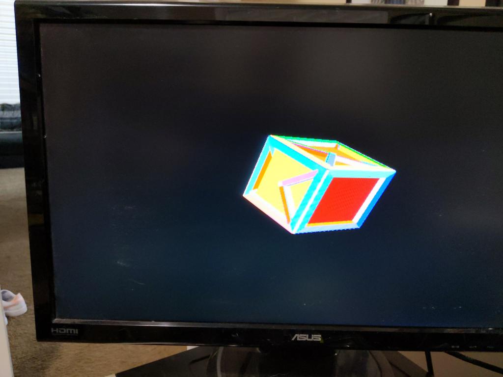

I thought I'd start a seperate thread where we can put any code for loading (or saving??) existing 3D file formats in to the new 3D engine. That way we won't be cluttering up the main thread.
This .WRL one (code to convert .wrl files in to the new 3D objects) is definitely a work in progress. But I thought I'd share the latest update. I've rewritten it so that it now has a bunch of custom string handling functions that I think will be useful for all other file loaders (I'm starting to write a .obj one as well).
I had to use "long strings" for the file load section (because of the 255 char limit on strings) and then I split it down in to smaller strings that I can parse.
This code doesn't work with some of the larger .WRL files as I realised halfway through the project that there's a whole pile of different ways to store data, including having multiple objects in the one file. So when you upload a truck it might have seperate hood, wheels etc, all at different relative locations. That's the next task to solve.

I have the .OBJ loader "working". I use Quotes because there still appears to be some issue with the objects, but that might just be the order in which the primitives, that make it up, are loaded. In the crate object below you can see that some of the struts are missing. I'm not sure why that is, I'll try and investigate this weekend. They do re-appear as they rotate to the front of the object.
It can handle quite large objects, however I have to pre-allocate the Long String arrays to handle the parsing in LoadOBJ(). I have defined these as 100,000 elements - which I believe translates in to a maximum string length of 800K. i.e. If the text to define either the vertexes or faces exceeds 800,000 characters you will need to increase this limit.
The .OBJ file format is much easier to work with than .WRL. By default all faces are right hand/clockwise orientation.
It is clearly defined here.
http://paulbourke.net/dataformats/obj/
Currently I'm just throwing random colours at each face. But the .OBJ file format does contain definition for colours and/or textures, so I want to get that working.

dim integer camera_y = 0
dim integer viewplane = 700
dim integer camera_z = 0
dim integer camera_x = 0
dim integer finalObject=1
dim integer c,t,s
timer=0
dim q(4)
dim yaw=rad(1),pitch=rad(2),roll=rad(0.5)
' Generate 50 random colours to use on faces
dim integer bcol(50)
for t=0 to 50
 bcol(t)=rgb(rnd()*255,rnd()*255, rnd()*255)
next t
' Works for putting random colours on objects with up to 500 faces
' Increase for objects wth more faces
dim integer faceCol(500)
for t=0 to 500
 facecol(t)=rnd()*50
next t
LoadOBJ(1,"EliteShips\wooden crate.obj", bcol(), faceCol(), faceCol())
draw3d camera 1,viewplane,camera_x,camera_y,camera_z
page write 1
for c=0 to 7200
 draw3d show 1,0,0,10, 0
 math q_euler yaw,pitch,roll,q()
 draw3d rotate q(),1   ' rotate this object #
 inc yaw,rad(0.1)
 inc pitch,rad(0.2)
 inc roll,rad(0.5)
 page copy 1 to 0,b
next
page write 0
print 720000/timer
draw3d close all
end

  PeteCotton said  I have the .OBJ loader "working". I use Quotes because there still appears to be some issue with the objects, but that might just be the order in which the primitives, that make it up, are loaded. In the crate object below you can see that some of the struts are missing. I'm not sure why that is, I'll try and investigate this weekend. They do re-appear as they rotate to the front of the object.
I think this is just the nature of the beast. The painter's algorithm draws faces from farthest to nearest. But it is possible for a large face to have a nearer centroid than a smaller face that should cover part of the larger one.
Consider this:
The two visible green faces should cover (part of) the red face. However, the centroid (black dot) of the red face is closer than the centroids of both green faces and therefore is drawn after the green faces, hiding (or mostly hiding) them.
Breaking large faces into smaller ones might be the only solution.
qwerty823
Joined: 30/07/2020
Posts: 30
Posted: 07:57pm 10 Dec 2020
https://en.wikipedia.org/wiki/Painter%27s_algorithm#Limitations
You describe the overlapping case (though not cyclical). There is also an issue of "piercing" faces (where faces intersect).
Seems we need a z-buffer, and let the renders do a z-buffer depth test. :)
Although another option would be to split faces on overlaps and intersections and generate new vertices and faces as needed to make painters algo work.

  vegipete said
  PeteCotton said  .....In the crate object below you can see that some of the struts are missing. I'm not sure why that is, I'll try and investigate this weekend. They do re-appear as they rotate to the front of the object.
Ah, thank you. I think you have hit the nail on the head (and thanks for the nice and clear diagram).
  qwerty823 said  Although another option would be to split faces on overlaps and intersections and generate new vertices and faces as needed to make painters algo work.
Yes. I think this is probably the easiest solution. For most objects which just have an outer skin (like the Elite ships), this isn't going to be an issue. It looks like Blender and MeshLab both have the ability to generate the outer skin mesh and not include any hidden surfaces.
