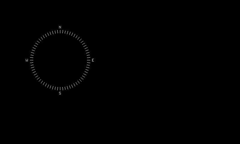

I've been trying to figure out if it's possible to get something like this without the fancy star in the middle without using an image
I mean a Circle or 2 Circles with the lines around it and the letters
I've been using this
but I'd like to do it without using an image as I need it to be able to be used on a couple of different resolution displays
I know how to do the circles but I have no idea if you can make the marks around the outside or not and put the direction letters in place using mmbasic

It looks like you want is to find the x and y point from any given angle.
The formula for finding any point on a circle is x=cos(angle)*radius and  y=sin(angle)*radius
Lets call a variable "a" and make it our angle. Make another variable "r" and this is the radius of the circle you want. (in the above diagram "t" is the angle and it has a radius of 1). To find the X and Y for any point on that circle of radius r, you need to provide the angle a.
The formula for this is
x=cos(a)*r
y=sin(a)*r
The only real gotcha here is that by default BASIC uses Radians instead of Degrees for it's angles. You can make it use Degrees by adding
option angle degreees
at the top of the program. Or alternatively you could convert angle "a" in to Radians.
So the following program will draw a series of lines from the center to the outer points in a circle
option angle degrees
for a=0 to 360
 x=cos(a)*100
 y=sin(a)*100
 line 200,200,200+x,200+y
next a
Note: Because the x and the y can go negative and 0,0 is the center of the circle I have added 200 to all of the x and y values so that the lines appear on the screen (otherwise you would only see a quarter of the circle at the top left of the screen).
This is the basic formula you need for drawing anything in a circle. So to get to your compass, we are going to do three things.
First off, we are drawing a line for every degree, I suspect you only want a line every 5 degrees so we add a "STEP" command to the for loop to make it step up in multiples of 5
for a=0 to 360 step 5
Next we don't want to draw the line from the center, so we could use the formula to calculate the points on two circles. One with a radius of 90 and one with  radius of 100 and draw a line between those points (instead of from the center to the outer circle).
x1=cos(a)*90
y1=sin(a)*90
x2=cos(a)*100
y2=sin(a)*100
line x1+200,y1+200,x2+200,y2+200
This gives you the outer ticks.
Finally you want to be able to put text next to some of them. You can use the same formula to find the x and y locations of the text. This time we will make the radius of the "text" circle 110. Normally text is positioned by the top left point. We need to center them so that the point we are using from our 110 radius circle is actually at the center of the text. We can use the "TEXT" for this, with options CM to specify center and middle alignment.
There's probably a neater way to do this, but to keep it simple
x3=cos(a)*110 + 200
y3=sin(a)*110 + 200
if a=0 then text x3,y3,"N",CM
if a=90 then text x3,y3,"E",CM
run this and you get the following
Which is almost right... but you can see that 0 degrees is not North and 90 degrees is not East.... There are two things happening here. Look at the original formula drawing (below)
First off, an angle of zero degrees (t in the above diagram) would actually point East along the x axis... so that's problem number one. This is easily fixed by subtracting 90 degrees from the angle we are using.
The next problem is that with this diagram, 90 degrees (East) would point straight up along the Y-axis. However graph paper has the origin point 0,0 in the bottom left (i.e. positive values of Y go up the page) and our CMM drawing page has 0,0 at the top left (with positive values of Y going down the page). By a happy coincidence though, what this means is that although the calculation goes counter/anti-clockwise, for our purposes we want to go clockwise... so we don't need to change anything on that score.
So the final program looks something like this
  ' NOTE: I have added the 200 offset to the calcs below to keep the later code cleaner
 x1=cos(a)*90 + 200
 y1=sin(a)*90 + 200
 x2=cos(a)*100 + 200
 y2=sin(a)*100 + 200
 x3=cos(a-90)*110 + 200
 y3=sin(a-90)*110 + 200
 line x1,y1,x2,y2
 if a=180 then text x3,y3,"S",CM
 if a=270 then text x3,y3,"W",CM
next a
Which should give you something like this (apologise for the dusty screen).
Edited 2020-12-05 04:32 by PeteCotton

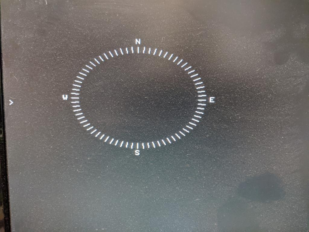

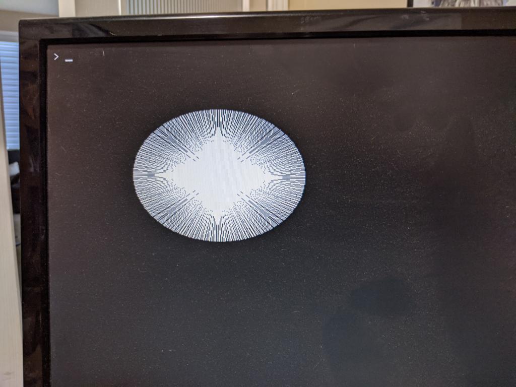

I've kinda got success
but I've gone wrong somehow
a = a*0.01745
x1=cos(a)*90 + 200
y1=sin(a)*90 + 200
x2=cos(a)*100 + 200
y2=sin(a)*100 + 200
line x1,y1,x2,y2
LINE mm.hres/2,mmvres/2,LT,2, 2, RGB(WHITE)
next a
print finished 'so I can see the program has stopped
EDIT:
I tried it with for a=0*PI/180 to 360 step 5 and i's still the same result
Edited 2020-12-05 06:56 by lew247

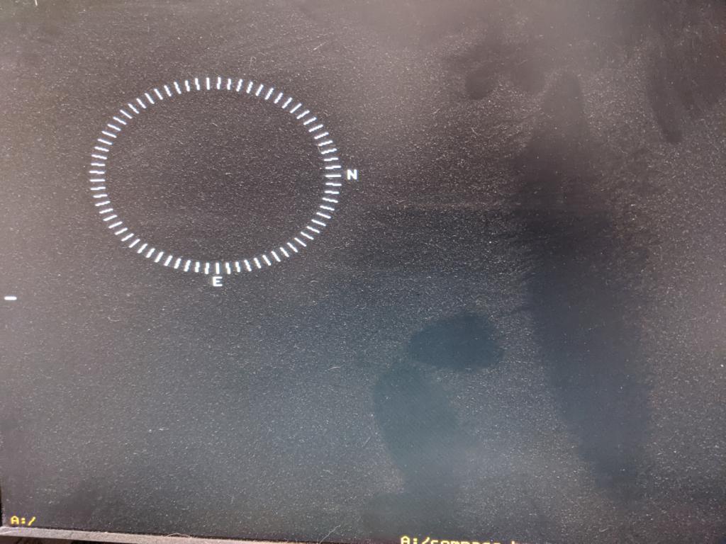

lew247
Joined: 23/12/2015
Posts: 1709
Posted: 09:25pm 04 Dec 2020
Brilliant
I now have a perfect compass
but
for some reason the direction letters are out
This is with a for the text lines
This is with ra for the text lines
Edited 2020-12-05 07:26 by lew247
PeteCotton
Joined: 13/08/2020
Posts: 669
Posted: 09:34pm 04 Dec 2020
  lew247 said  Brilliant
but
Can you post your code please?
lew247
Joined: 23/12/2015
Posts: 1709
Posted: 09:41pm 04 Dec 2020
CLS
for a =0  to 360 step 5
ra = RAD(a)
x1=cos(ra)*90 + 200
y1=sin(ra)*90 + 200
x2=cos(ra)*100 + 200
y2=sin(ra)*100 + 200
x3=cos(ra-90)*110 + 200
y3=sin(ra-90)*110 + 200
line x1,y1,x2,y2
if ra=0 then text x3,y3,"N",CM 'didn't work
if ra=90 then text x3,y3,"E",CM 'didn't work
if ra=180 then text x3,y3,"S",CM 'didn't work
if ra=270 then text x3,y3,"W",CM 'didn't work
next a

PeteCotton
Joined: 13/08/2020
Posts: 669
Posted: 09:48pm 04 Dec 2020
  lew247 said
CLS
ra = RAD(a)
x1=cos(ra)*90 + 200
y1=sin(ra)*90 + 200
line x1,y1,x2,y2
next a
Ah yes. ra is the value in radians. So it will be somewhere between 0 and 6.283 (2*Pi). a is the value in degrees, so it will be somewhere between 0 and 360. I think you are getting confused between the radian and degree values.
That's why your "if ra=90 then" lines don't work. Because ra is always much smaller than 90, and therefore will never reach 90.
It is also why the text is off. The value "ra" in these two lines are now in radians (they were in degrees before - so subtacting 90 degrees was valid).
So subtracting 90 from them is going to give some unexpected result. 90 degrees in Radians is (0.5*Pi = 1.5707).
So the lines should read
x3=cos(ra-1.5707)*110 + 200
y3=sin(ra-1.5707)*110 + 200

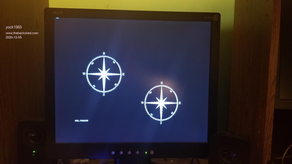

yock1960
Joined: 18/08/2020
Posts: 167
Posted: 01:06am 05 Dec 2020
Here is what I have so far. I still have a few things I'm scratching my head about, namely the positioning for the rotated text, as is, the rotated images don't scale correctly if the wid% parameter is changed. Graphics primitive angles in radians had me confused for a while! I'll give this a bit more work....a fun exercise!
Steve
option explicit
mode 1,8
CLS
dim cx% = 230
dim cy% = 260
dim wid% = 100
dim ang! = 0.087266463
compass_rose cx%, cy%, wid%
compass_rose 530,400,100
do while inkey$ = ""
loop
sub compass_rose cx%,cy%,wid%
 local a%
 for a% = 0 to 90
 line (cx%+15)+(cos(a%*ang!)*(wid%*.85)),(cy%+15)-(sin(a%*ang!)*(wid%*.85)),(cx%+15)+(cos(a%*ang!)*(wid%*.9)),(cy%+15)-(sin(a%*ang!)*(wid%*.9)),,RGB(WHITE)
 next
 text cx%+9,cy%-wid%+5,"N",L,2,,RGB(WHITE),RGB(BLACK)
 text cx%+9,cy%+wid%+5,"S",L,2,,RGB(WHITE),RGB(BLACK)
 text cx%+wid%+8,cy%+4,"E",L,2,,RGB(WHITE),RGB(BLACK)
 text cx%-wid%+8,cy%+4,"W",L,2,,RGB(WHITE),RGB(BLACK)
 text 10,10,"NE",L,7,,RGB(WHITE),RGB(BLACK)
 image rotate 6,4,30,30,cx%+wid%/2,cy%-wid%/2,45
 text 10,10,"SE",L,7,,RGB(WHITE),RGB(BLACK)
 image rotate 6,4,30,30,cx%+wid%/2,cy%+wid%/2,135
 text 10,10,"SW",L,7,,RGB(WHITE),RGB(BLACK)
 image rotate 6,4,30,30,cx%-wid%/2,cy%+wid%/2,225
 text 10,10,"NW",L,7,,RGB(WHITE),RGB(BLACK)
 image rotate 6,4,29,29,cx%-wid%/2,cy%-wid%/2,315
 circle cx%+15,cy%+15,wid%-16
 circle cx%+15,cy%+15,wid%-13
 triangle cx%+15,cy%-wid%+25,cx%+15+7,cy%+15,cx%+15-7,cy%+15,RGB(WHITE),RGB(WHITE)
 triangle cx%+15,cy%+wid%+8,cx%+15+7,cy%+15,cx%+15-7,cy%+15,RGB(WHITE),RGB(WHITE)
 triangle cx%+15-wid%+3,cy%+15,cx%+15,cy%+15+7,cx%+15,cy%+15-7,RGB(WHITE),RGB(WHITE)
 triangle cx%+15+wid%-3,cy%+15,cx%+15,cy%+15+7,cx%+15,cy%+15-7,RGB(WHITE),RGB(WHITE)
for a% = 1 to 8
 triangle cx%+15-sin(9*a%*ang!)*wid%*.4,cy%+15-cos(9*a%*ang!)*wid%*.4,cx%+15+cos(9*a%*ang!)*5,cy%+15-sin(9*a%*ang!)*5,cx%+15-cos(9*a%*ang!)*5,cy%+15+sin(9*a%*ang!)*5,RGB(WHITE),RGB(WHITE)
next
end sub
