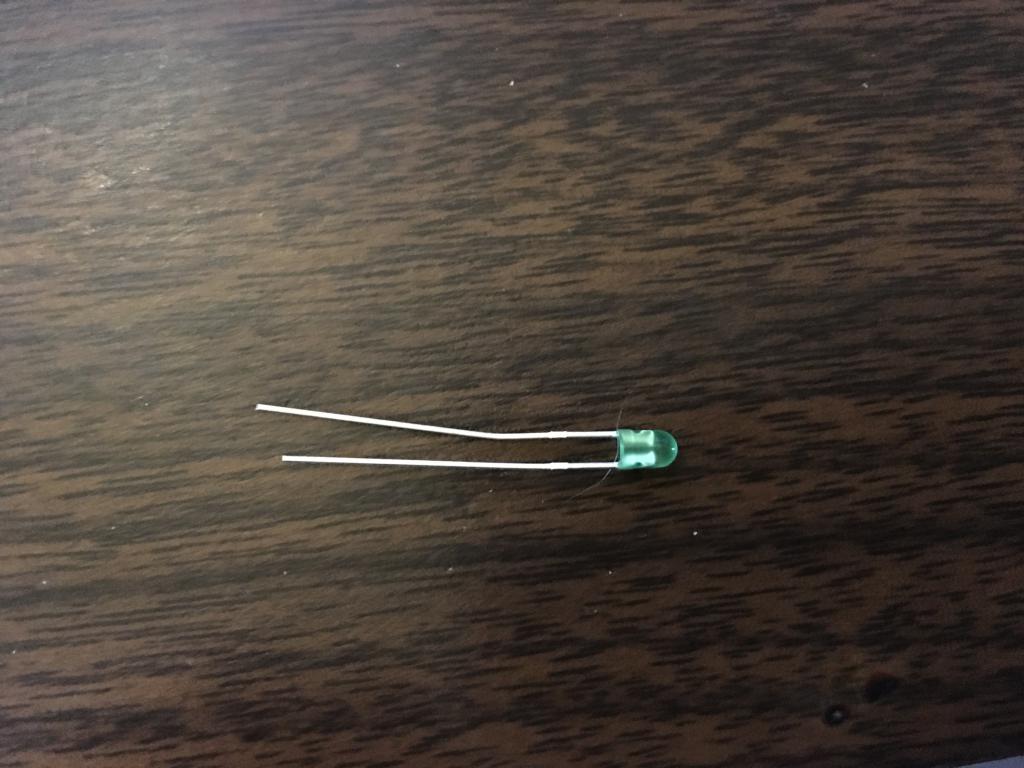

What voltage should the power LED be? I had to replace it and I only had a 5V 3mm LED in green. Could that cause a problem? I wouldn't think so but figured I'd ask anyway.

An LED is not normally rated for voltage unless they include a series resistor. Usually they don't.
A green LED has a voltage drop of probably less than 2 volts and requires a series resistor to limit the current through it. Providing that you have the series resistor still in place and the LED is working there should be no worries.

  Turbo46 said  An LED is not normally rated for voltage unless they include a series resistor. Usually they don't.
No there is no resistor on the LED itself, nor on the activity LED.

No. If the LED is rated for 5 volts it MUST include a series resistor in the package. That would have the effect of reducing the current drain compared to a normal LED.
If it's working then that's not a problem.

  Turbo46 said  No. If the LED is rated for 5 volts it MUST include a series resistor in the package. That would have the effect of reducing the current drain compared to a normal LED.
Hmm. There's no resistor on the LED itself but the package says they're rated for 5V.
Posts: 11892
Posted: 04:08pm 28 Nov 2020
I use the 5V LEDs a lot - you can't see the resistor but something is there as they definitely current limit when powered direct from 5V

I have bought what are sometimes called "resistorized" LEDs which contain resistors which allow them to be plugged into breadboards directly off of microprocessor pins. I have a package from one set of them, and the part name ends with "5V".
The resistors are so tiny that I cannot see them without a magnifying glass.
I cannot see any way that this type of resistor (if that is what yours are, and if undamaged) could cause your CMM2 to fail.
