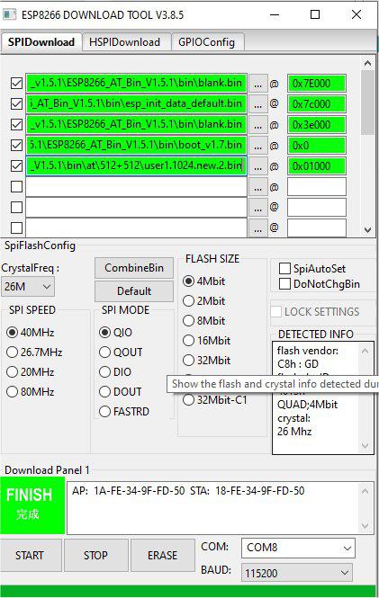

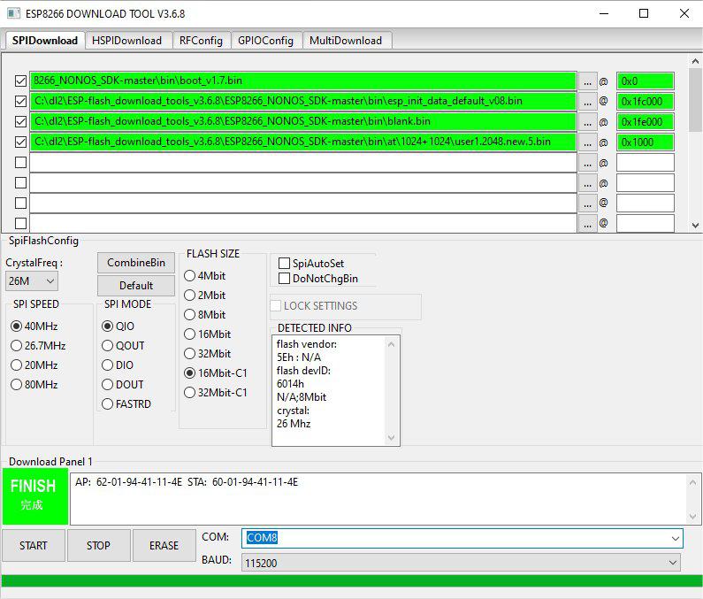

Here is my setup for the Download Tool:
For the blue 4Mbit module, I used this:
I hope these are the right images--I had much struggle to find a combination that worked, but then I successfully flashed a half-dozen or so ESP8266s--4Mbit and 8Mbit modules.
