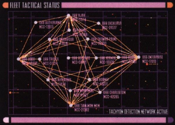

3D lines. So for example: If I have a 3D view of stars that my space ship can jump to, and I wanted to draw lines between them (see image below) as the galactic map rotated.
These lines would also be useful to represent things like shield strength around vessels (see below)
And on a similar note, 3D pixels (for particle effects such as explosions).

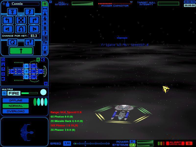

  LeoNicolas said  @PeteCotton, the screenshots that you shared are amazing
I can wait for playing your game
Ha ha - I wish. They were from the game my new game is originally modelled on (Star Trek - Star Fleet Command). Still one of my all time favourite games. I originally started working on a text based 1980's Star Trek, then started playing with the 3D stuff and realised that I could do a passable 3D engine in BASIC for the game. But this new 3D firmware functionality would allow me to take it to a whole new level. Of course, it won't be "Star Trek" as I respect the franchise/IP, but the game play will be along these lines..... if I ever get it completed.
