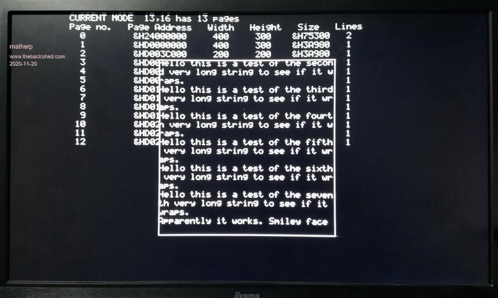

A new sub command allows you to resize pages to make them smaller than the mode default
PAGE RESIZE pageno, width, height
When writing to a resized page the new dimensions will be respected by drawing commands as in the demo program and screenshot below.
This should provide a huge benefit to anyone looking to develop a TUI type application as each screen tab could have a differently sized page allocated to it.
PAGE COPY can be used between identically resized pages but BLIT must be used between pages with different sizes
This release also fixes the INC bugs and the DATA bugs and the STRING$ feature (thanks Geoff).
I've tested the code with all the welcome tape programs and haven't found anything major other than as described above but this is a major re-write of a big part of the CMM2 internals so please report anything you find on this thread
mode 13,16 '400x300
page resize 3,200,200
page resize 2,200,200
list pages
page write 2
cls
print "Hello this is a test of the first very long string to see if it wraps. "
print "Hello this is a test of the second very long string to see if it wraps. "
print "Hello this is a test of the third very long string to see if it wraps. "
print "Hello this is a test of the fourth very long string to see if it wraps. "
print "Hello this is a test of the fifth very long string to see if it wraps. "
print "Hello this is a test of the sixth very long string to see if it wraps. "
print "Hello this is a test of the seventh very long string to see if it wraps. "
print "Apparently it works. Smiley face"

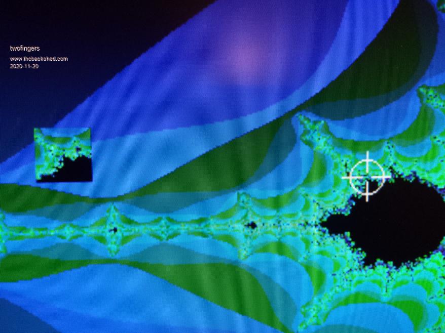

Hi Peter,
sorry, I am getting strange temporary artifacts from
27-10-2020      15332  MandelbrotEXP.bas
s. picture:
Michael

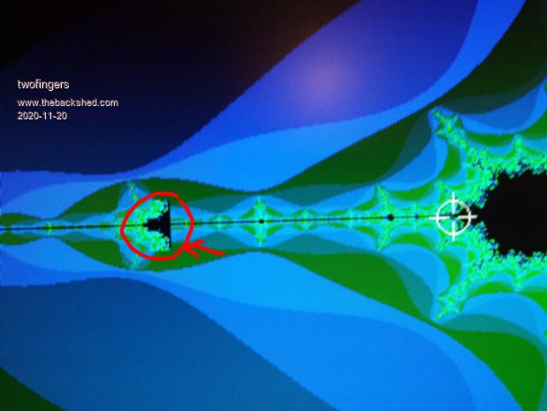

  Sasquatch said  The original MandelbrotEXP using Mode 1,8 seems Ok in this respect.
I can't confirm that! The screenshot above is mode 1,8.
This picture is better:
Edited 2020-11-20 07:45 by twofingers

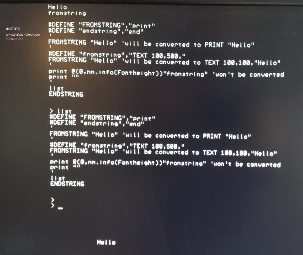

V5.06.00b2
http://geoffg.net/Downloads/Maximite/CMM2_Beta.zip
I really hope this finally fixes the INC command
In addition this release now supports the #DEFINE directive
#DEFINE "replacethis", "withthis"
The program can support up to 64 #define statements and both parameters must be literal quoted strings.
The pre-processor does a simple string substitution of the "replacethis" string with the "withthis" string.
Matches within quoted strings in the program are ignored.
DEFINEs are executed in reverse order of creation so a symbol can be redefined and from that point on in the program the new definition will be active.
Case is ignored in the strings in the DEFINE directive
#DEFINE "FROMSTRING","print"
#DEFINE "endstring","end"
FROMSTRING "Hello" 'will be converted to PRINT "Hello"
#DEFINE "fromstring","TEXT 100,500,"
FROMSTRING "Hello" 'will be converted to TEXT 100,100,"Hello"
print @(0,mm.info(Fontheight))"fromstring" 'won't be converted
print ""
list
ENDSTRING

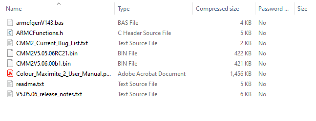

Actually unless I am experiencing some caching issue that zip file has the wrong contents:
Posted: 11:02am 20 Nov 2020
  Quote  Actually unless I am experiencing some caching issue that zip file has the wrong contents:
Try again - working for me - clear cache if still a problem

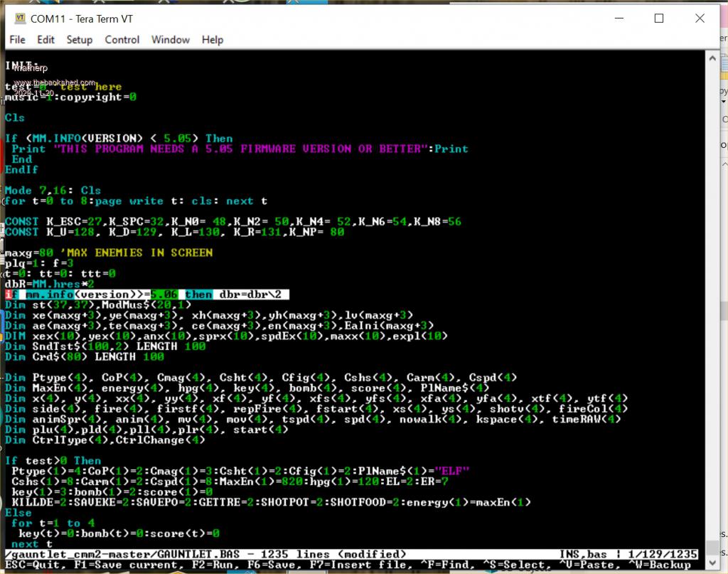

To make Gauntlet work on V5.06.00 and still on V5.05.06 add the line shown below. Great code from Mauro a single variable change and it all works
Edited 2020-11-20 21:50 by matherp
