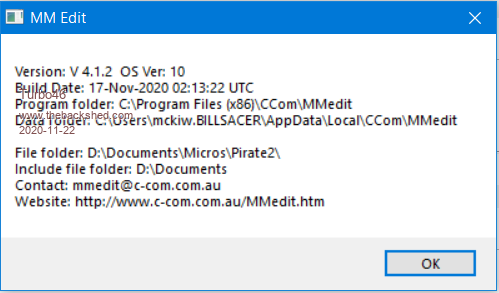

Posted: 02:38am 22 Nov 2020
MMEdit has always created 'temp.bas' to 'run in Dos'.
There was a brief period when MMEdit was not saving correctly. It tried to save without the full path specified so Windows did what it thought best.
That version was only up for a short period but it sounds like you may have it.
Check the build date in 'About' or the configuration report. The date and time,not just the version.
It should be:
  Quote  MM Edit Version: V 4.1.2  20201119065223
Build Date: 19-Nov-2020 06:52:23 UTC
If that's not the problem, I need a copy of your configuration report to look further.
