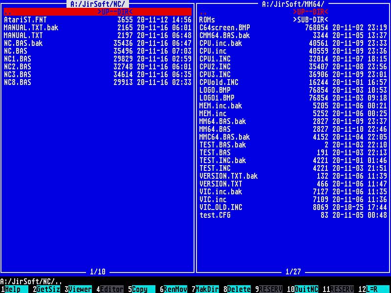

Hi,
I tried this week to write my first app for CMM2, something similar to Norton (Volkov...) commanders for DOS. Of course, it has limited functionality, but for me already works better than build in FILES....
Napoleon Commander
But, be carefully, it needs longer testing!!!.

Very nice application Jiri
This reminds me of the old but excellent Xtree Gold.

Yes, a very nice job Jiri - it also reminds me of Xtree Gold. This will be a very useful application.

Hi Jiri,
I'm interested in what you're showing in the screenshot.
Are you building a C64 VIC emulator? Is that doable? Is there going to be a SID.inc as well?

  epsilon said  Hi Jiri,
Hi epsilon,
yes, I'm trying to. Doable for sure, the question is speed...
I took it like mental training, so first I wouldn't to use CSUBs at all, but later because some limitations (no change font definition during of program run) or speed (I started with execution speed about 1% of C64), I added some.
I also thought that I will take some ideas from Peter's 6502 emulator, but there are bugs and is slower than my code. Right now I'm working on NC, but next week I will continue on MM64.
And for SID no, first I'm not able to do it (maybe later some basic "sounds") and I think SID itself is BIG project. I'm writing just 6502 inclusive illegal codes, simplified VIC (just TEXT and BITMAP modes, no interrupt...), basic CIA (memory, IRQ).
My goal is to be able run BASIC and MC programs, that are not using  any speciality, but too little time and too many projects (+ work   )...
