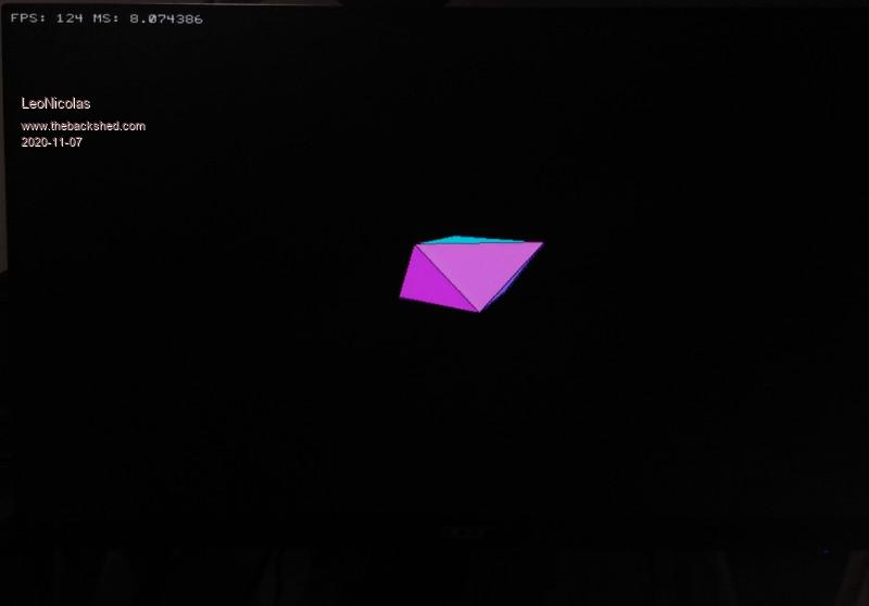

Peter
Is this what you are expecting?
Octahedron rendering with page copy (125 FPS):
https://youtu.be/OFFE4AApq4U
Octahedron rendering directly to page 0 (250 FPS):
https://youtu.be/vvfzPPXxBUQ
No optimizations yet, but it's being very cool

  Quote  Is this what you are expecting?

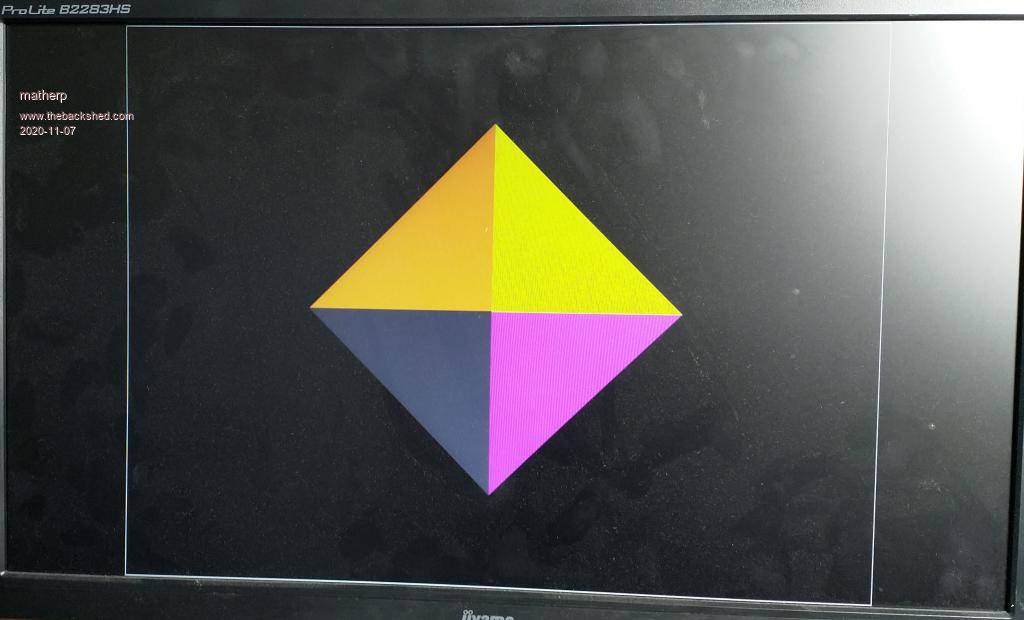

Looks too small. I'm expecting the octahedron will be about 400 pixels high ((250+250)/1000*800)
More clarification on the rules:
Please print out the coordinates of all 6 vertices after 650 iterations.
Do not use specific characteristics of a tetrahedron for hidden face analysis  (i.e. only 4 faces can ever be showing). Please make the techniques for hidden faces fully generic.
Should also have said to centre the output on MM.HRES\2, MM.VRES\2

Before any rotation the screen should look something like this. The white border is the edge of the 800x600 display area (BOX 0,0,MM.HRES,MM.VRES)

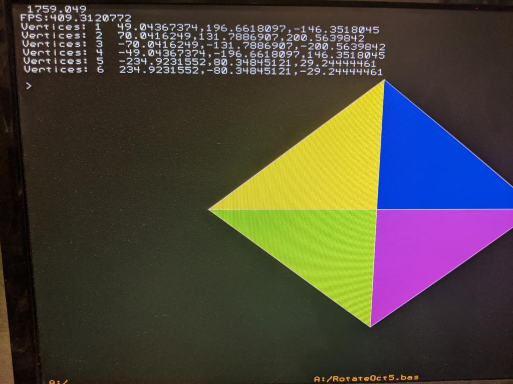

I have no idea if these vertices (from the 650th iteration) actually match anyone elses?
1759ms (409 frames per second)
With Page Copy it drops to 5485ms (131 fps)
Edited 2020-11-08 07:52 by PeteCotton
