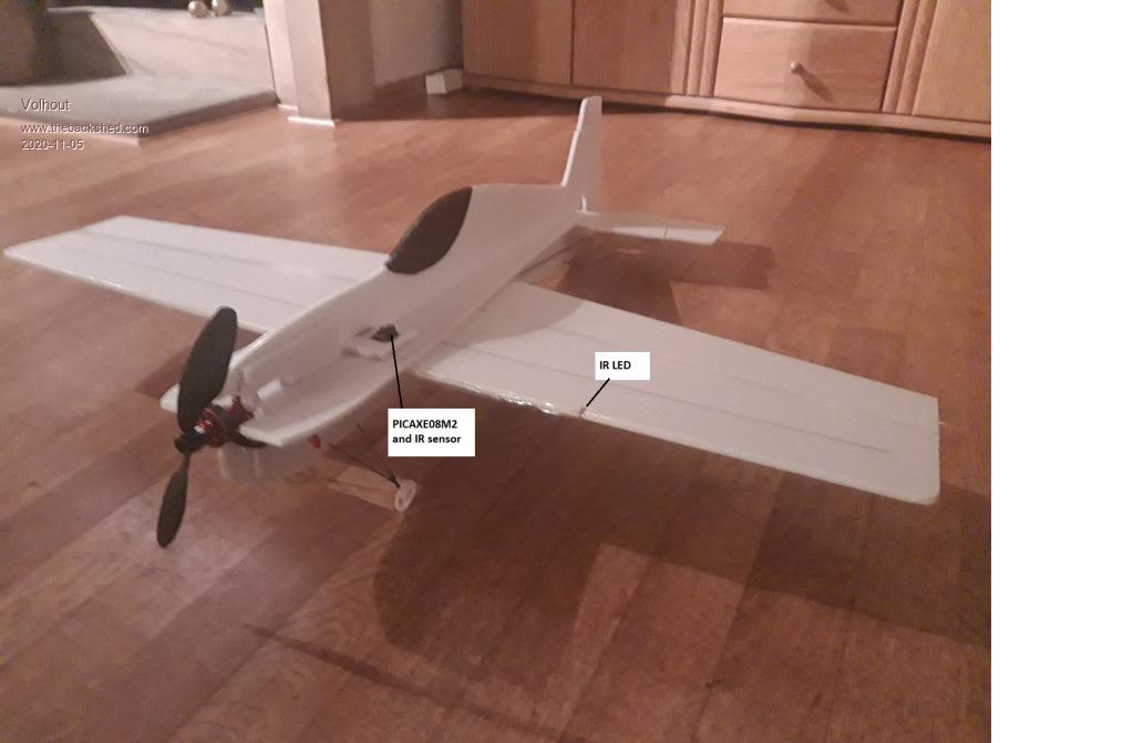

These electronics have to be very light, the planes are below 200 gram. That is why was chosen for a 8 pin picaxe microcontroller.
Example of the electronics on a plane

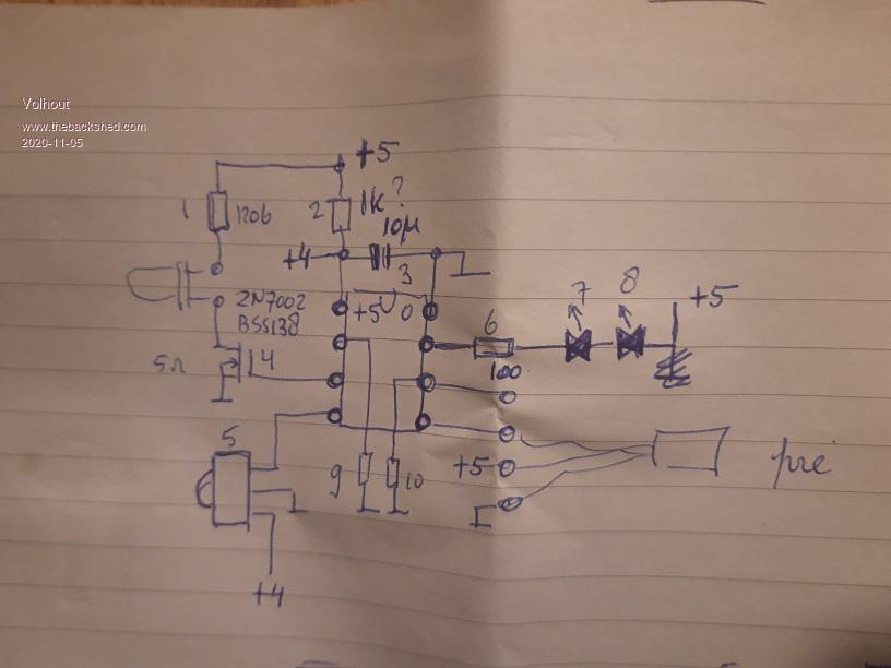

The picaxe has embedded receiving and transmitting of SONY 12bit IR codes. Accidentally the CMM1 also supports these SONY codes. That eases the implementation of the system.
Schematics of the tag (hand drawn sketch)

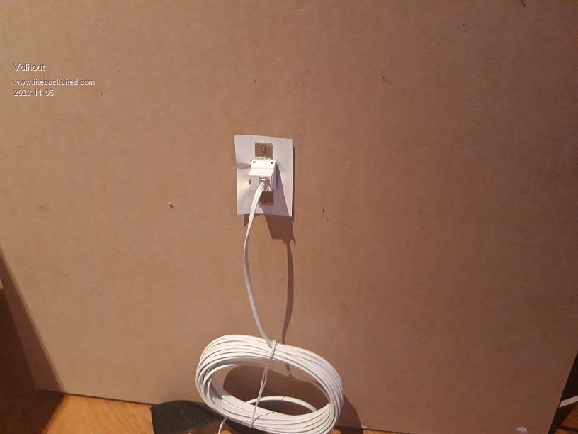

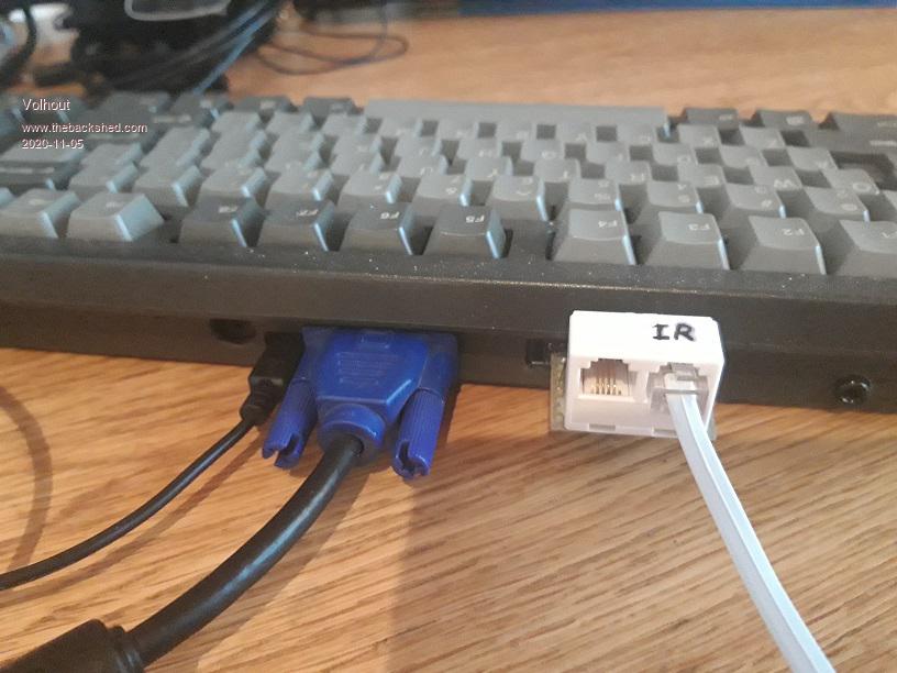

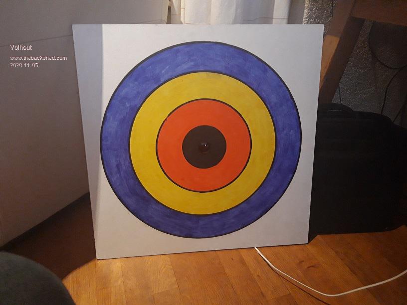

The target runs on a CMM1. An IR sensor is connected (see CMM manual) to pin 12 of the CMM1. Currently the target is connected via a cable (RJ11 telephone cable), but in the future there will be a wireless target.
CMM1 26pin - RJ11 adapter board
The target (front and rear)

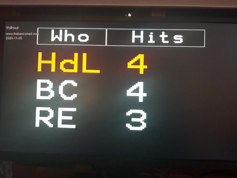

Screenshot of the highscore list
