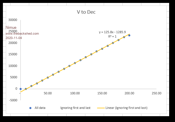

Forgive me if I'm missing the point.. but if I convert Hex to Dec and plot I get:
Ignoring the first and last points as they look definitely non linear (clipping at the highest voltage) --- you get a perfect linear relationship between V and your Hex (now in Dec) measures...
Have I missed the point?

So simplifying your formula slightly and converting say 100V into the hex =
(100 x 126) - 1286 = 11314 = $2C32
Then AND $F0 to mask out the lower nibble or the low byte gives $2C30

The values in the graph and formula look suspiciously like 127 or 128 am I missing something obvious with the conversion?
Is it really decimal points maths on the voltage value to generate the hex?

Go back to the first answer give.
Convert the 16 bit HEX numbers into decimal.
Lets call that 'reading'
Volts = int(reading/126 + 10.8)
Ignoring the first and last readings, that is close enough for me.
I have tweaked the values to allow for rounding to whole volt values.
