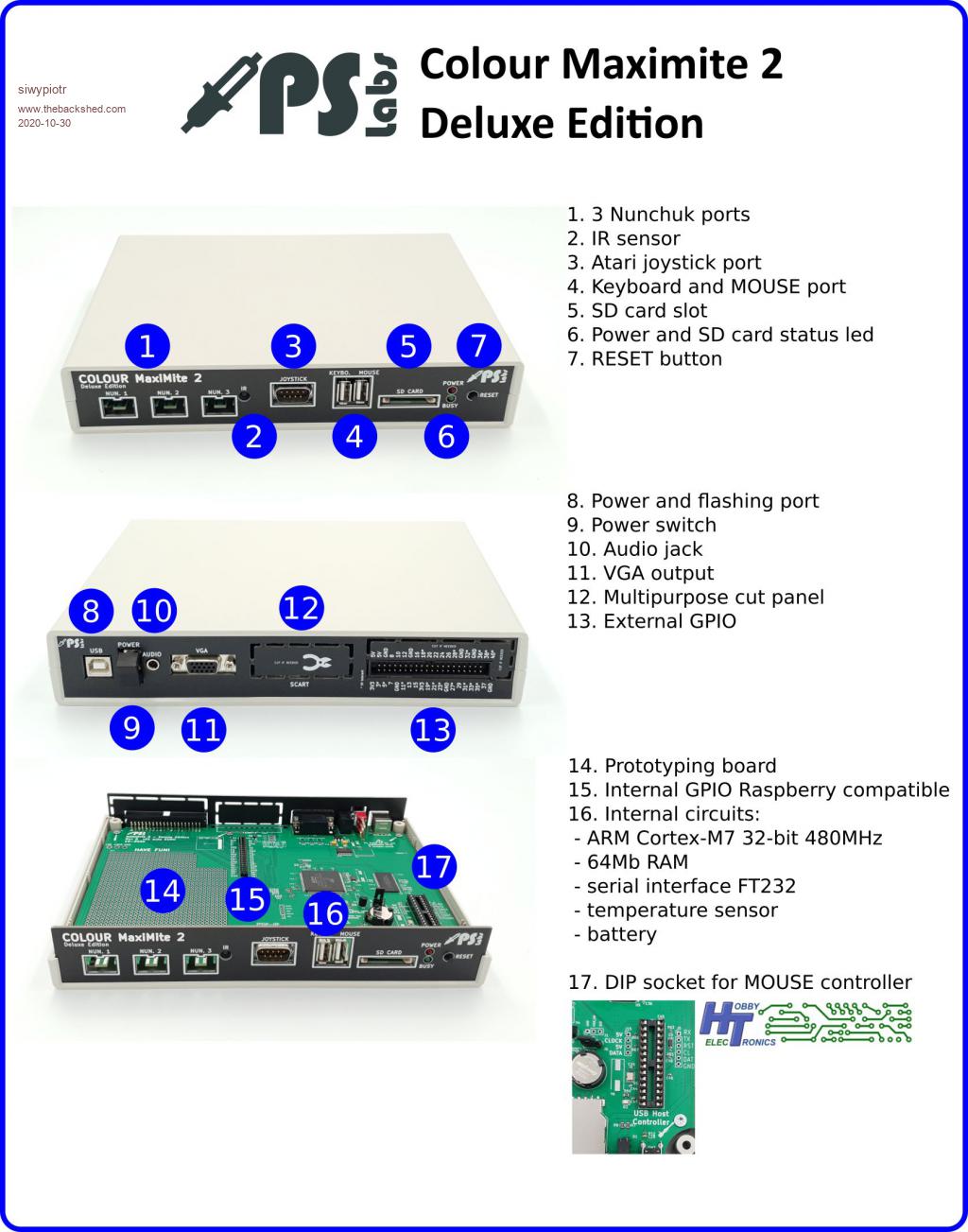

Dear Maximite fans!
My name is Piotr Siwy, Im the owner PS Labs company located in Poland. First time I saw Maximite 2 project I knew that I will build my own version. After creating 4 revisions and adding mouse functionality I decided that my product is mature enough to create this topic on the forum. I nick named it Delux Edition.
Colour Maximite 2 Deluxe Edition is produced in Poland.
The Colour Maximite 2 Deluxe Edition is an enhanced version of the Geoff design.
Main features:
-USB MOUSE support (after installing chip: https://www.hobbytronics.co.uk/usb-host-dip)
- built-in ARM Cortex-M7 32-bit RISC processor clocked at 480MHz (the processor is integrated part of the device, no additional development board with the processor is required)
- 3 sockets to connect 3 Wii nunchuk controllers (as opposed to 1 socket in the original design)
- socket for connecting a standard joystick, e.g. Atari
- reset button
- 40-pin internal socket compatible with the Raspberry Pi extension, which allows the module to be installed inside the housing
- internal built-in prototype board
- 40 pin external socket
- USB socket for keyboard connection
- FT232 chip for flashing by usb power cable
- IR sensor
- temperature sensor
- audio jack
- VGA socket
- power switch
- SD card slot
- LEDs indicating power and activity
- built-in battery for clock settings

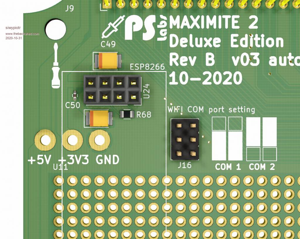

Good morning,
Yesterday before going sleep something obvious came to me. Why there is no WiFi in Maximite?
Good that I have not send the boards to production. I will add socket for ESP WiFi module and jumpers for user to decide which COM port he wants to use.
Have a nice day!

Done!

Apparently it is recommended to power the ESP8266 module separately, when they start transmitting they can draw large amounts of power.
In My opinion there is no need to power it separately, what I did is I added large filtering caps next to it. They will compensate for large power consumption.
In general my design has well made filtering part. This is not first time I design for wireless communication. I made a lot of mistakes when working with GSM modules, they are really power hungry, this changed my thinking in respect of power lines filtration.
Im really happy about my current design of Maximite. Never had issues even on power hungry tests. Im also very happy about new layout of memory lines my last change did a lot for stability.
I have also spend a lot of time when laying the video lines. My VGA signal is very stable, colors are nice, crisp and saturated.

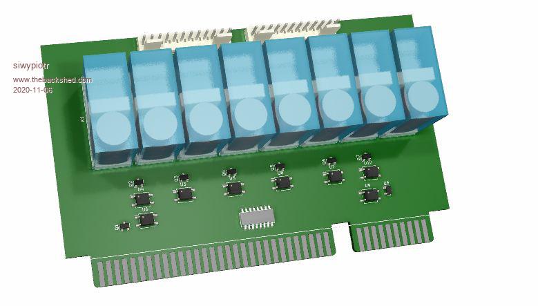

First person who will guess what I'm making today will get 1 pcs for free:

Moter control relay board?

Hi
You are correct, this is relay board.
But for what it will be used?
The chip You see on the board is shift register, what benefits it will give?

Does it load an 8 bit word serially and shift the bits into parallel output registers to control the eight relays???? Do I see opto-couplers on the board???? How big are the motors you are driving? Did you think about using a Triac to soft start the motors and limit inrush current? After the motor accelerates you can pull in mechanical relay contacts to avoid the continuous voltage drop in the Triac.

Since It got too complicated to constantly add functionalities to my version of maximite and because I want also people who have different versions of maximite to also benefit from my work I decided to do something new.
The board You see is part of expansion system for maximite users. It will be extension board with edge connectors (for multiple modules) connected to maximite via ribbon cable. Moreover this can be extended by connecting additional extension boards.
3d model of card You see is one of modules that can be pluged to extension board. The board documentation will be open source so everyone can create their own board.
You are correct about shift register.
The relays will be operated by SPI, You will only shift bits to decide about relays pins. Moreover You will be able add as many relay cards as You wish and still use the same number of maximite pins (shift registers on the cards will be daisy chained).
This is one of the cards that will be soon available:
- relay card
- bread board card (for fast protoyping)
- power card (highly efficient delivery of 3.3V, 5V, 12V, 24V)
- wire communication card (USB mouse, RS232, RS485, CAN BUS)
- wireless communication card (WiFi, GSM, RFM - LORA)
And I hope that many more including those created by other people.
For filtering of ESP it is too late, boards will be delivered next week so It looks like we will see.

Siwypiotr man, you are productive !!!
A true expansion system. That brings back the days of card cages (Altair 8800, Acorn system 3,4,5).

When I was thinking about expansion system I was searching for different solutions. I quickly found that reason why I chosen Maximite is the memories from my childhood. Switching on my Atari 800XL and in second Your computer is fully operational, ready with programing environment. What You seen on the screen is the word READY and cursor below encouraging You to start programing.
Decision was every easy, there is nothing better than edge connector that we all remember from our happy times as kids!
