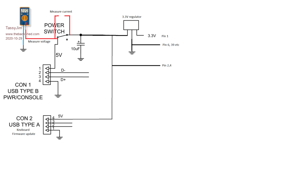

I thought I would write a beginners fault finding guide.
The power circuit of the CMM2 is reasonably simple.
The easiest place to measure voltages is at the power switch.
1. With the switch OFF, measure from the centre pin to ground.
My system reads 5.17V but the actual voltage is not too important yet.
2. Switch the unit on and re-measure the voltage to ground.
My system with a good cable reads 5.04 Volts
With a 'bad' USB cable (actually 5 2M extension leads inserted in series) reads 4.52 Volts with the unit switched on vs 5.17 with the unit switched off.
My unit still runs happily at 4.52 Volts but some keyboards may spit the dummy.
3. with the power switch off and the multimeter set to current, measure the units load by putting the leads across the power switch pins. It's the centre pin and the rear pin that we want.
My unit reads 270mA with a few external devices still connected.
Without the extras, the current is ~200mA
Anything under 150mA or over 250mA with no keyboard or connections to the 40 way connector would require investigation.
Doing some maths.
With the good USB cable there is 5.17-5.04 volts drop in the cable and 270 mA load gives (5.17-5.04)*0.27 = 0.035 ohms lead and power supply impedance.
With the 'bad' USB lead (5.17-4.52)*0.27 = 0.175 ohms
That doesn't seem much but I would be concerned with that much lead resistance.
While I don't have any bad USB cables (as far as I know), I did have some very bad Dupont leads I use on the breadboards. They went into the bin...

  TassyJim said  I thought I would write a beginners fault finding guide.
Doing some maths.
This is what I need...good stuff! Thanks for the help TassyJim and all!
Switch off = 5.08V
Switch on = 2.25V
Above measured as you described. I get no readings for current on any setting. I'm not sure I've ever used this meter (DVM830L) to check current, so I'm not sure it works, although voltage and resistance checks seem okay.

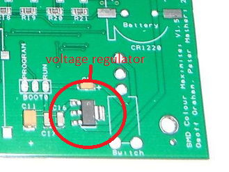

Checking voltages at the various legs of the regulator, with power on are:
      a   b   c
          d
a = 2.26v
b = .68v
c = 2.62v
d = .68v
I've checked with three different cables and from a dedicated USB power jack to a laptop USB port with essentially the same results. To reiterate, the unit connects/reads/flashes in it's current state using the Cube Programmer, but will not connect via serial/console...does not show as a com port in device manager.
There are no markings on the top side of the regulator and while I could probably get it off, getting a new one back on in working condition...with my horrid soldering skills is problematic....but what have I got to lose! :-)
Steve
Steve
Posts: 10114
Posted: 12:23pm 29 Oct 2020

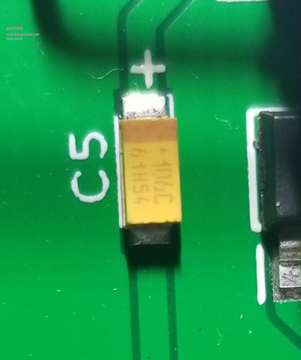

CMM2 must be powered from 5v, and a regulated 5v at that.  Some of those 5v USB chargers put out 9v(as mentioned), and some output 5v, but that 5v can also be quite "Dirty", as many of them are very cheap.
The regulator is an LM1117-33, and is good for up to 15v input, so even a 9v input should not really have killed it.
  Quote  2.25V on pin2 and .67V on pin1, same with two different cables. Connected via the A port and PC, I get 1.71V on pin2 and basically zilch on pin1.
Yes, something has been cooked.  You should have 5v between pin-2 and ground, and you should have 3v3 between pin-1 and ground.
You may have killed C5 or C11, which I think are rated to only 6v3, so putting 9v on them could have made them go short-circuit.
With the power switch on the front OFF(up), plug in the 5v, and measure the voltage between ground and the power-switch legs - should be 5v.  Turn on the unit and measure the 5v voltage again across the switch and ground.  If it has dropped down to 2v or so, you probably have shorted C5 due to over-voltage.  Turn off the switch, remove C5, repeat.  If the voltage now stays at 5v with the switch on(down), then replace C5.
EDIT:
  Quote  Switch off = 5.08V
Switch on = 2.25V
You've cooked C5.
Replace.
EDIT:
  Quote  Checking voltages at the various legs of the regulator, with power on are:
     a   b   c
         d
a = 2.26v
b = .68v
c = 2.62v
d = .68v
Completely understandable, if C5 is short-circuit.
It will be pulling the input voltage right down to 2.26v input, for a regulator that is trying to output 3v3, so you only see a fraction of that on the regulator output, cos the input is now well below the LDO for the wanted output voltage.
A is the regulator input - should be 5v
B is the regulator output - should be 3v3
C is the regulator ground
D is also the regulator output - should be 3v3
Edited 2020-10-29 22:33 by Grogster

  yock1960 said  ... while I could probably get it off, getting a new one back on in working condition...with my horrid soldering skills is problematic
Steve ...
On the assumption that you dont have a hot air rework station, two soldering irons, one in each hand should do the trick to remove C5.
\_cap_/ like chopsticks
Note that C5 is polarised (looks like a tantalum to my untrained eye), you could probably dead-bug a suitable through hole cap if you don't have a suitable surface mount part.
As you mentioned, you have nothing to lose by attempting a repair, and save on the shipping time for a replacement CMM2.
Womble
