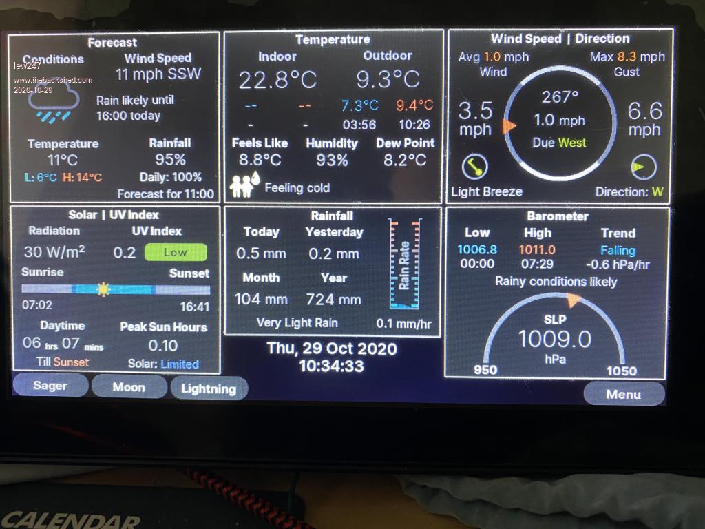

I'm trying to get my Si7021 temp/humidity module working with Python
I've got it working great BUT
I cannot fathom or figure out how to get the min and max temperatures to check if the date has changed then use the current values
date has changed means its a new day ie just gone midnight
This is the code thats working perfectly

This is what I'm trying but it keeps coming up with errors

The error at the moment is
  Quote     File "/home/pi/wfpiconsole/lib/SI7021.py", line 46
    if datetime.now() > MaxTemp.date
SyntaxError: invalid syntax
Anyone know a simpler way to get the min and max temps and change them to zero at midnight?
The two variables I need are
MinTemp
MaxTemp
and update at midnight (new date)

lew247
Joined: 23/12/2015
Posts: 1709
Posted: 10:12am 29 Oct 2020
To achieve what I need is beyond me I'm afraid
I needed to accomplish this
  Quote  In the SI7021.py file the variables you need to set are Obs['inTempMin'] and Obs['inTempMax']. The format of these variables needs to be a list, with five elements in each. The elements are
max/min temperature as a string,
u'\N{DEGREE CELSIUS}',
time of max/min formatted as a string,
max/min temp as a float,
time of max/min temp as a datetime
I got lost at string float and datetime in Python
Given up for now, I'll stick with the the temperature now showing on the display
Edited 2020-10-29 20:39 by lew247
