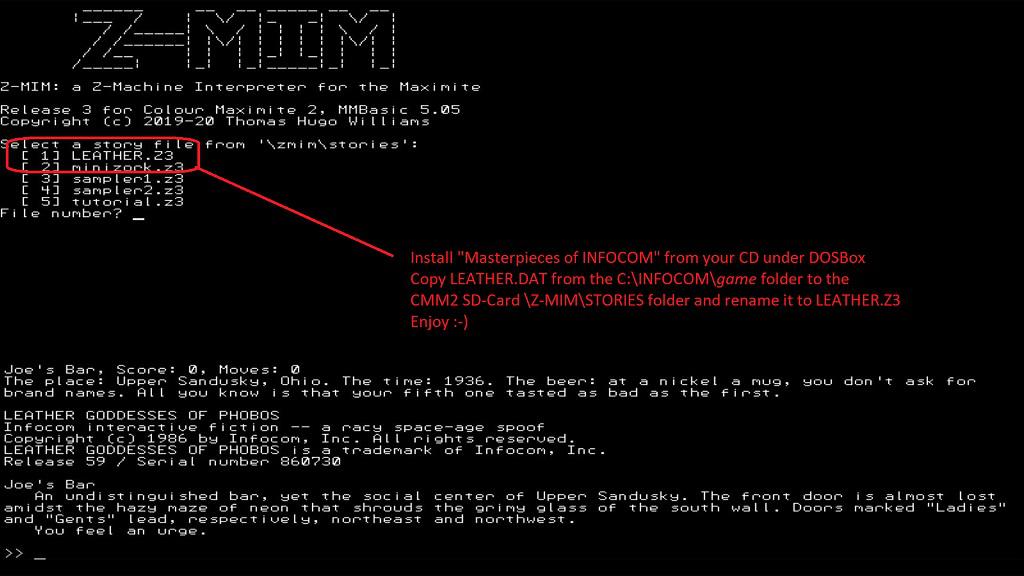

Bill ...
When you install "Masterpieces of INFOCOM" under DOS the files are named *.DAT
I assume the same applies to "The Lost Treasures of Infocom"
Rename them to *.Z3 and they should work
See below ...
I have not tried any others, but they should work.  Firmware v5.05.06B15

@Womble, beyond the obvious red additions can you confirm that screenshot has been doctored it looks likes several lines of output are missing between "File number?" and "Joe's Bar".

Tom ...
Two images cut together, and then the red comments added in paint.  Also resized for upload to forum.  I mashed the imaged together to make it easier to upload and view.
Here are the original images zipped up
z-MIM original images.zip
I simly renamed LEATHER.DAT to LEATHER.Z3 and copied it across to the SD card and ran Z-Mim to see if the file would load.  Didn't actually play the game or compare with DOSBox.
edit: Fired up DOSBox this morning and screen grabbed (PrtSc) the first screen of Leather Godesses.  Does not appear to be missing any text.
Leather_Dosbox.zip
More thorough testing is on my ToDo list but been distracted coding stuff on my CMM2.
My setup uses a Win10x64 laptop with a VGA-USB capture device --> Windows Camera (used to take screen grabs),and TerraTerm rather than a keyboard.
CMM2 firmware was v5.05.06B15
Hope this helps

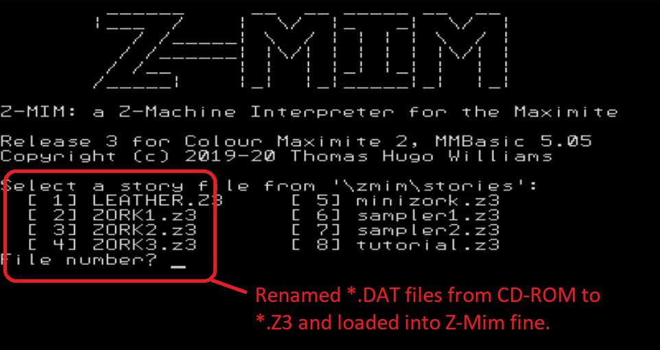

Tom ...
I tried a few more *.DAT files from my CD-Rom (actually from the DOSBox installed folder).  Renamed them to *.Z3 and they loaded OK into Z-MIM release 3
Image cropped and commented.  Firmware was the most recent EXP version for the CMM2.

Thanks @Womble, that's what I thought.
We also have different versions of the LGOP data file (I have Release 160 / Serial number 860521) which includes the following disclaimer:
WARNING!, Score: 0, Moves: 0
  Some material in this story may not be suitable for children, especially the parts involving
sex, which no one should know anything about until reaching the age of eighteen (twenty-one in
certain states). This story is also unsuitable for censors, members of the Moral Majority, and
anyone else who thinks that sex is dirty rather than fun.
  The attitudes expressed and language used in this story are representative only of the views of
the author, and in no way represent the views of Infocom, Inc. or its employees, many of whom are
children, censors, and members of the Moral Majority. (But very few of whom, based on last year's
Christmas Party, think that sex is dirty.)
  By now, everyone who might be offended by LEATHER GODDESSES OF PHOBOS have whipped their disk
out of their drive and, evidence in hand, are indignantly huffing toward their dealer, their
lawyer, or their favorite repression-oriented politico. So... Hit the RETURN/ENTER key to begin!>

Tom ...
Yes I get that "diclaimer" but it appears on a separate screen.  One which I didnt Screen Grab.  The extra screen is displayed before you actually get into the game on my version.

OK, same for me.

At least I have now also tried the three Zork files
Great work on Z-Mim, it appears to be rock solid as far as I can determine.
