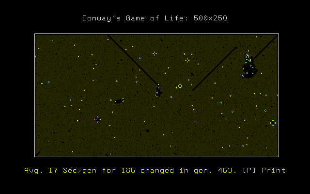

OK - I've rewritten the Life program to clear and use a change list.  As I mentioned above, the list is composed of three arrays, draw_x(), draw_y(), and draw_c(), and each is (x-extent * y-extent) in size.  So, for the field shown in the drawing above, 500x250, that's 125,000 elements each (huge!!).  I use the MATH MAP function to rapidly clear the list after each generation.
Also, as I suspected, the PIXEL command happily zips through the list, drawing all of the changed pixels.  Unfortunately, my first attempt puked when I filled the list arrays with "-99" values, in hopes that the code would stop when it encountered an out-of-bounds value (can't use -99 as a color).  Unfortunately, it errored out, and "ON ERROR SKIP" skipped the entire PIXEL command, drawing nothing.
The actual number of changing cells, which, when randomly filled at a 10% probablility, goes something like this:
Out of 125,000 cells,
Gen 1: ~15,000 change, or 12%
Gen 2: ~ 5,000 change, or 4%
Gen 3: ~ 2,500 change, or 2%
after that: ~3,500 change, or ~3%
after ~450 generations, the amount of change is negligible:
So, for a huge fraction of the time, 95+% of the array extent is not used.  I don't exactly know what the PIXEL assembly code does when it finds coordinates off the screen, but it wasn't any faster than traversing the list step by step myself.
Unfortunately, both approaches turned out to be about a second slower than just setting the pixels as soon as the change was detected.
My request: alter the assembly code to terminate when an off-screen coordinate is encountered.

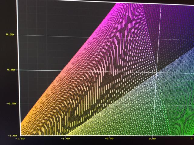

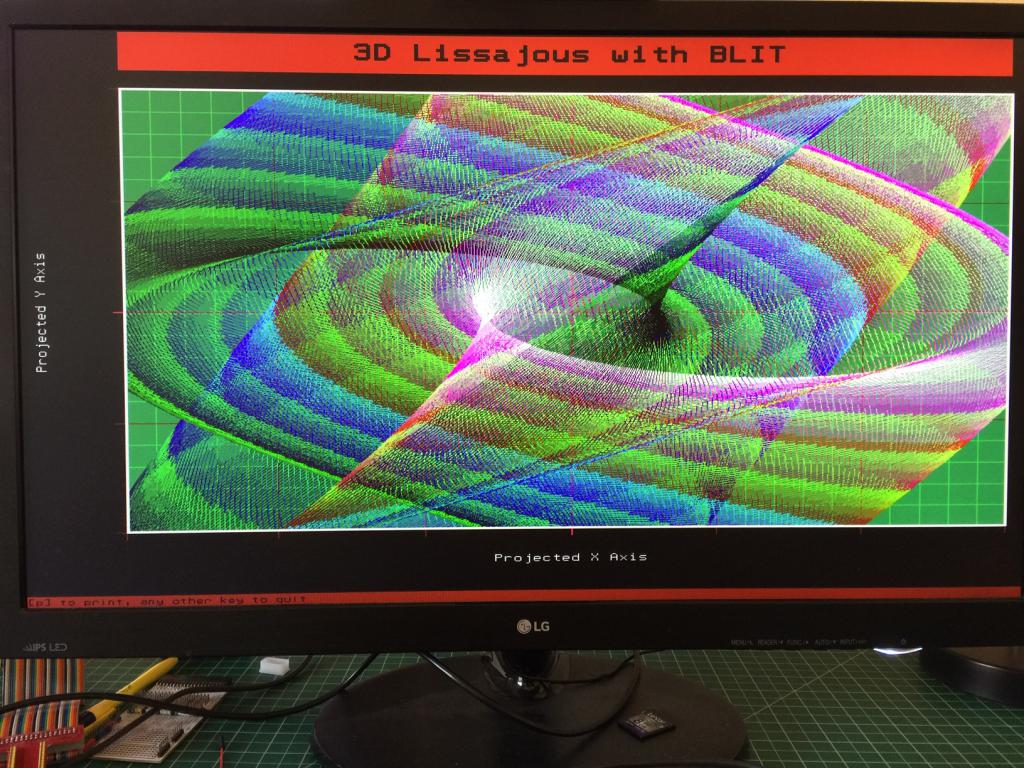

OK - strange stuff!
I first tried doing all of the plot graphics off-screen (to Page 1), and got weird artifacts when blitting from Page 1 to Page 0 to display.  Instead of this:
I got this on the screen (note jaggies whereas previous was very smooth):

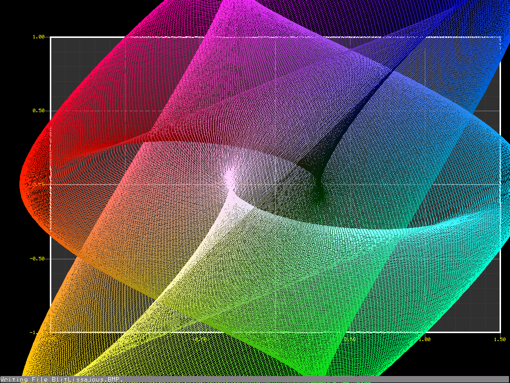

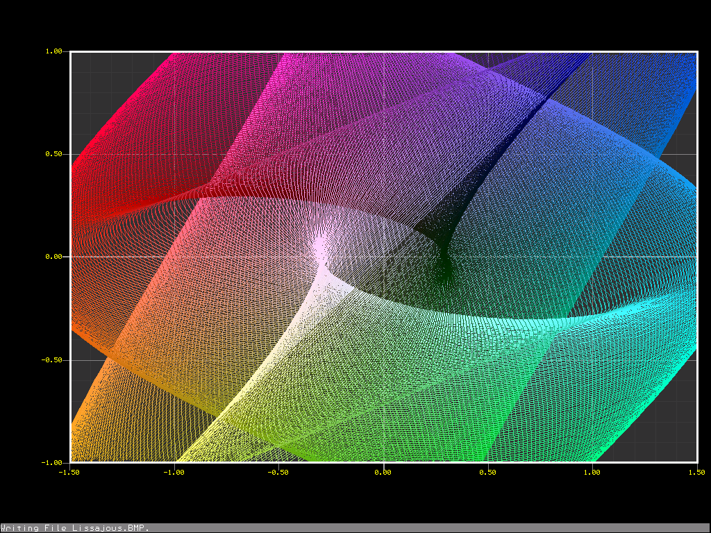

and this is what the SAVE command produced (note the excursions beyond the plot area; I expected this, as I was using Blitting to copy just the plot area to screen 0):

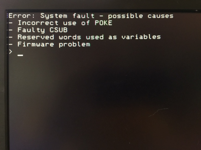

So, I tried using the framebuffer instead.  This got even weirder, resulting in this:
which I got both using the "normal" PAGE WRITE FRAMEBUFFER syntax and the otherwise documented FRAMEBUFFER WRITE syntax.
Oh - I'm using Screen Mode 9, and Peter Mather's recent "hashing" firmware 5.0506RC5
Insights?  Suggestions?

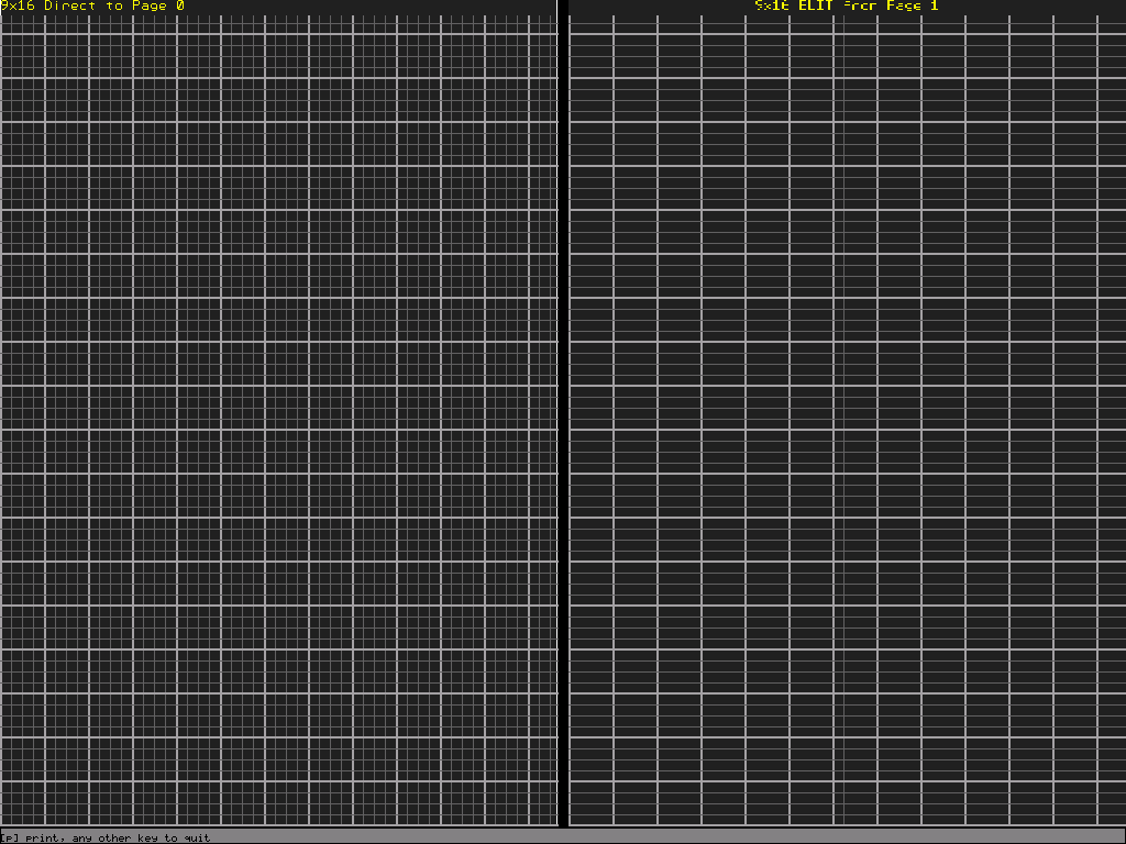

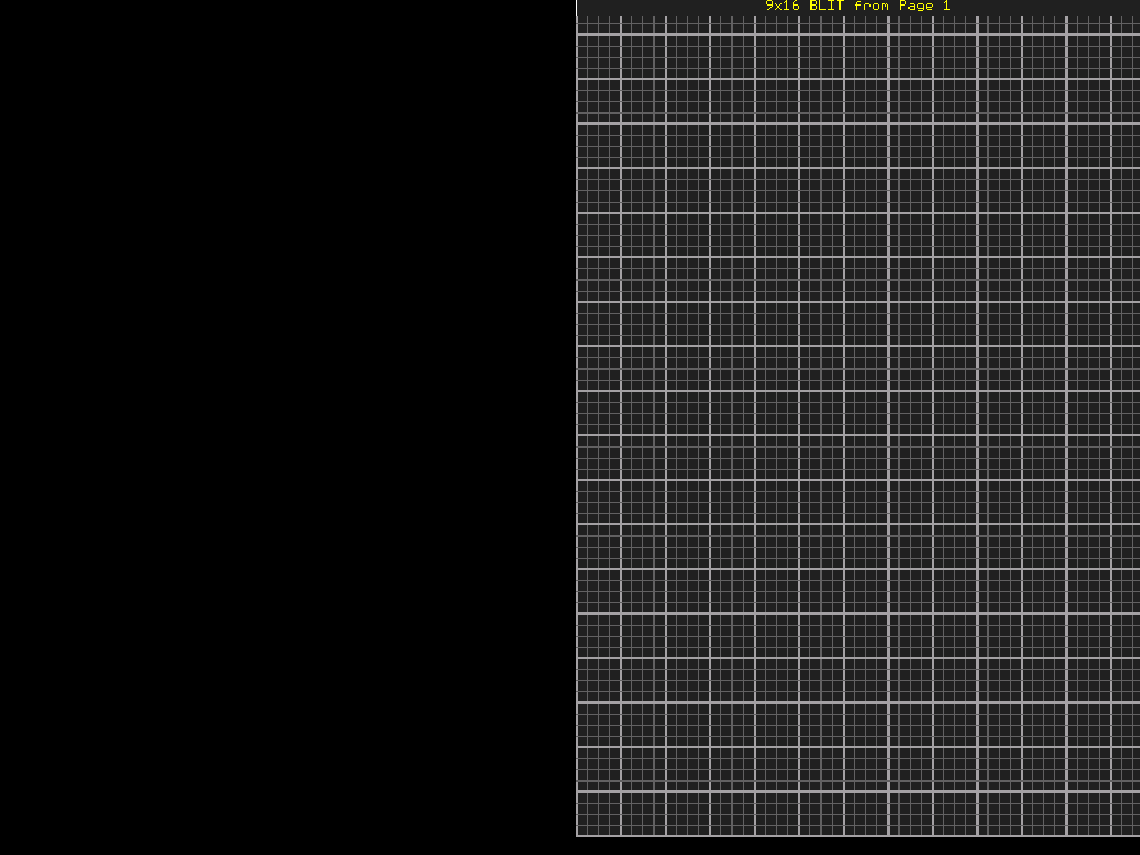

Pressing "p" after each mode will save bitmap files from both page 0 and page 1.  Now that I can sequence through the modes and depths, it seems that it's in 16-bit color mode (I didn't run any tests at 12-bit).
In 16-bit Page 9, here are the two captured pages:
Page 0 (after blitting the left half to page 1 and then back)
and Page 1 (after blitting the left half of page 0 to the right half of page 1)
Edited 2020-10-27 03:46 by NPHighview

   PAGE WRITE 0 : CLS ' OK - write to left half of screen directly.
   BOX  h0min%, vmin%, h0max%-h0min%, vmax%-vmin%, 4, RGB(red), RGB(gray) ' dark grey background
   FOR x% = h0min% to h0max% STEP 10 : LINE x%,     vmin%, x%,     vmax%, 1, RGB(black) : NEXT x%
   FOR y% = vmin%  to vmax%  STEP 10 : LINE h0min%, y%,    h0max%, y%,    1, RGB(black) : NEXT y%
   FOR x% = h0min% to h0max% STEP 40 : LINE x%,     vmin%, x%,     vmax%, 2, RGB(magenta) : NEXT x%
   FOR y% = vmin%  to vmax%  STEP 40 : LINE h0min%, y%,    h0max%, y%,    2, RGB(magenta) : NEXT y%
   BOX  h0min%, vmin%, h0max%-h0min%, vmax%-vmin%, 4, RGB(white)
   TEXT h0ctr%, vres%, STR$(Vmode%)+":"+STR$(Cdepth%)+" Page 0", CT, 1, 1, RGB(yellow), -1
   PAGE WRITE 1 : CLS : BLIT h0min%, 0, h1min%, 0, hres%/2-5, vmax%, 0  ' BLIT the graph
   TEXT h1ctr%, vres%, "BLIT 0->1->0", CT, 1, 1, RGB(yellow), -1        ' Add Right Hand title
   PAGE WRITE 0 : BLIT h1min%, 0, h1min%, 0, hres%/2-5, vres%, 1        ' BLIT the right side back
   BOX 0, 0, hres%, 15, 1, RGB(white), RGB(white)
   TEXT 0, 0, "[p] print, [q] quit, any other advances mode", LB, 1, 1, RGB(black), -1
   key$ = inkey$ : DO WHILE key$ = "" : key$ = inkey$ : LOOP
   SELECT CASE key$
     CASE "q" : CLS : END
     CASE "p"
       PAGE WRITE 0 : SAVE IMAGE STR$(Vmode%)+"x"+STR$(Cdepth%)+"_Page0.BMP"
       PAGE WRITE 1 : SAVE IMAGE STR$(Vmode%)+"x"+STR$(Cdepth%)+"_Page1.BMP"
   END SELECT
 NEXT Cdepth%
NEXT Vmode%

Posted: 07:32pm 26 Oct 2020
Yup, our postings crossed paths.  I've updated the firmware to your experimental version, and saw that the vertical line drawing now works in all modes and depths - thanks!
I'm afraid I can't characterize the color changes as subtle, however.  My 3D lissajous plot uses X, Y, and Z coordinates to create an RGB value; about one run in three, these are waaaaay off, as are the various shades of gray (now green or red) in the graph background and minor / major axis lines, and reds where there should be whites, and blues where there were cyans.  Here's how I get this behavior (behaviour - sorry!):
* Power on the CMM2 (often takes two switch throws to get video & the banner)
* Use Files command to select and immediately run the blitting Lissajous program (it has a CONST that is used to determine whether or not to use Blitting).  It uses mode 9 by default.
* The program runs - all is fine; colors look good.  This is true whether or not blitting is turned on.  Generally I lose patience and [ctrl]-[c] out, but sometimes I'll let it complete.
* Edit the program to "flip" the CONST - in the editor, the usually vibrant keyword coloration is muted.
* F1 to exit, F2 to run.  I get this on-screen; the captured bitmap file looks fine.  (I did check my VGA cables to make sure I didn't have any loose connections)
and
I'll poke around my little demo program to see if I can get it to do the same.
- Steve

NPHighview
Joined: 02/09/2020
Posts: 223
Posted: 07:45pm 26 Oct 2020
More info:
* Repeating the steps above gets me the weird colors.
* Then, I exit, use Files to find my little demo program, run it through its modes (all look fine), then go back to the Lissajous plotter, and it looks fine.
* Wait until it's done, then enter editor (colors show muted).  Exit with no changes.
* Run - colors are completely messed up again.
Hope this helps.  Sorry, I haven't got to the Framebuffer issues yet :-)
