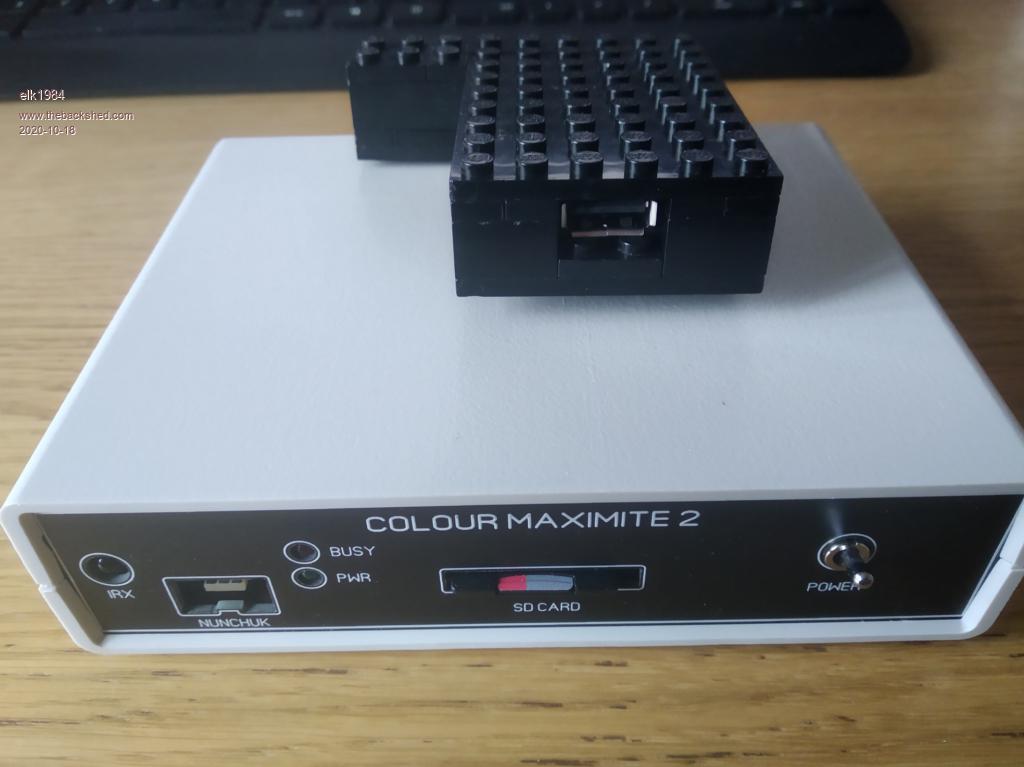

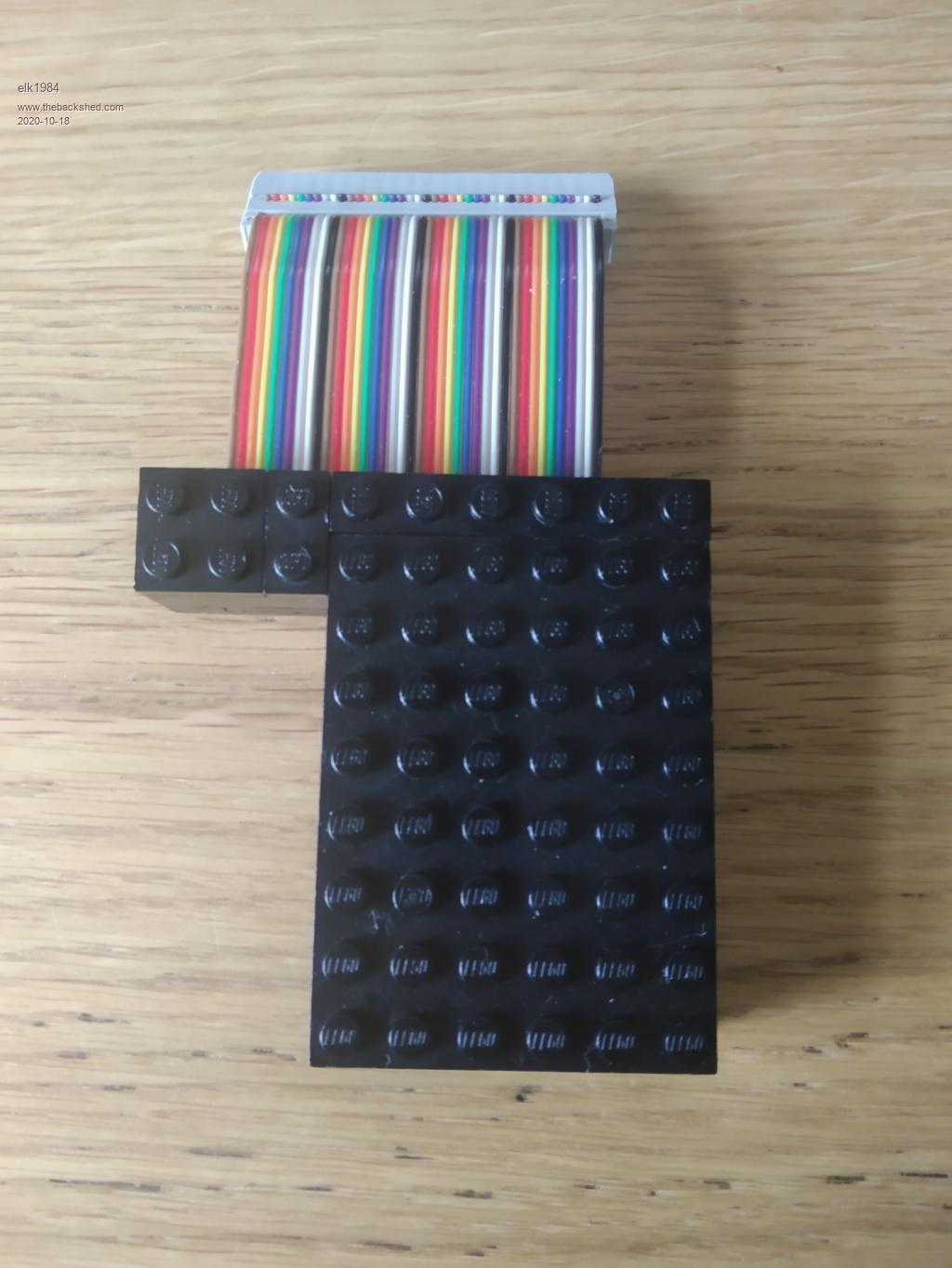

I was getting a bit nervous about having a bare HobbyTronics board hanging off the top of my Maximite, so I've finally got round to making a case:
The ribbon cable and the wires into the board are both grommeted so a mouse can be plugged and unplugged without fear of pulling on the cables.
If anyone would like the plans to build, I can create a set with an ordering list for Bricklink.

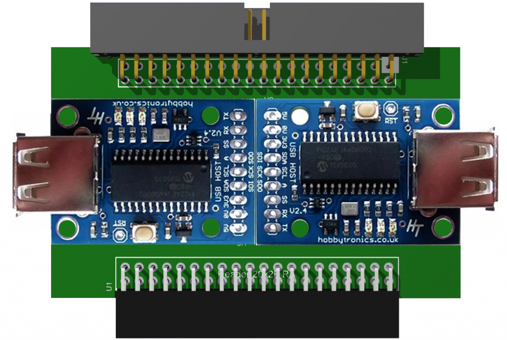

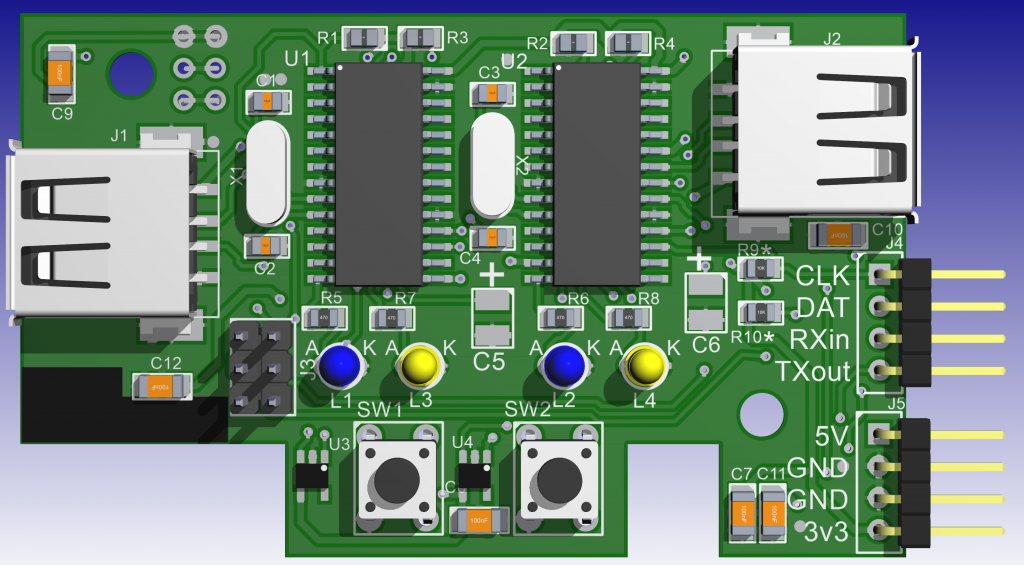

I may be preempting things a bit but I have two designs in the pipe that may (or may not) be of interest to people
Both are based on dual HOBBYTRONICS USB devices.
The first is to be an internal design that has one external facing USB port for joysticks (Or any other device that the HT chips can support) and a second port for an INTERNAL port designed for a mouse with a wireless transceiver so that it can be fully contained inside the case. This ones requires the purchase of 1 or 2 HT chips not the assembled boards.
This is the internal design, I have it completely designed but I am still waiting for my chips from HT to arrive so I can test the hardware before I send them off to be made.
The above board has 3 female header pins (facing down) that can mate (with a bit of luck as they are tight with the waveshare PCB) with the DS18B20 header on the WAVESHARE versions of the CMM2 board.. This will then have the DS18B20 mounted on the extra pads on my PCB,, it will also pick up 3v3 and GND from this header so no need to run these wires. There are headers to pick up power (both 5V and 3v3) and GND as well as two that will need to go to the I2C pins that will need to be soldered to suitable spots on the CMM2.
Then I have this one part designed that will plug into the rear of the CMM2 and have a pass-through port so you wont lose any functionality.
This design is not yet finished and I hope to cater for EITHER 1 or 2 HT full PCBS so the user can just plug them in and go or I hope to be able to add the HT chips and support circuitry on board (under the images of the HT boards) so they can just buy the chips and solder them on (with a few other cheapish components)
Anyway, As I said I need to get my chips first to test the designs before any release is done.
Any comments (Good or Bad) will be welcome

Your plug-in one will likely foul the VGA plug on one side and the other cables on the other side.
Instead, perhaps mount the two HT boards upside down underneath (you know, Australian style) the board with the USB jacks facing away from the CMM2. Only one of the mounting holes beside the jacks will hit clear pcb but that should be OK.

I have only got that one as a concept at this stage (luckily, I have spent my time on my preference (the fully internal board) There are several possibilities I opt for..
The VGA goes VERY close to the edge of the 40 way header so the PCB cannot protrude past as far as I have shown.. Back to the drawing board..
I have to build 20 off '170 mm boards for a customer first so that will be delayed a few days.
I am thinking rear facing it will have to be (or a very long PCB) I possibly could swing the FEMALE header underneath so the PCB raises enough to allow clearance but that probably wont be sufficient to clear the onboard USB connector..
