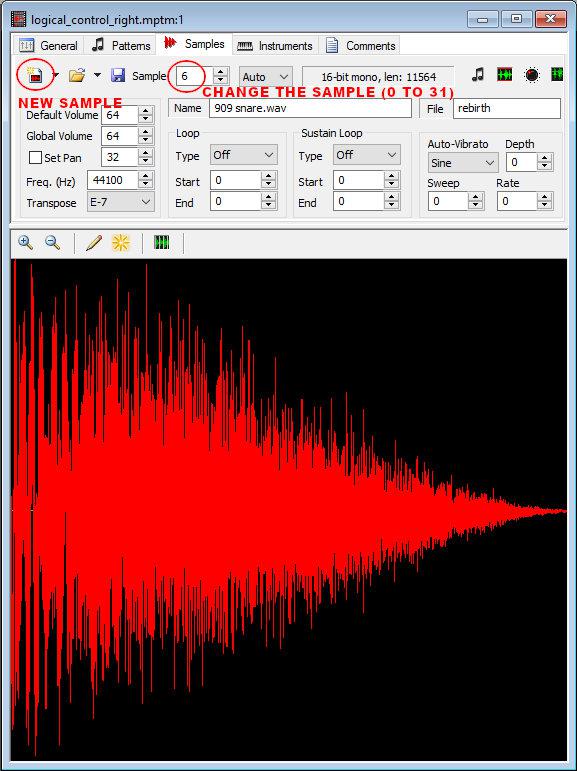

Unfortunately, you can't play any sound effect simultaneously with MP3 music (Not yet, but we never know when Peter goes to make a new magic trick).
You have three alternatives:
1) - Play a MOD music and use the PLAY EFFECT command to play WAV files as a sound effect, but you must use WAV that is the same frequency as the MOD. A good middle term usage is to use all in 22050Hz, use this frequency to the WAV in mono, and play the mod forcing this: PLAY MODFILE "....", 22050
2) - Play a MOD file using some channels as sound effects. It's easier than you think! Get the OpenMPT  program (it's free!), open the MOD on it, click on the Samples tab, change the number of the sample that doesn't have any data, or click on the left icon and create a new sample, then open your file browser, select your WAV at the same frequency that you will play the MOD and simply drag and drop it in the frequency wave. Look at the red circles to guide you:
Save the music, and in your program, you can play your SFX sample at any frequency with this:
PLAY MODSAMPLE number, channel, volume, frequency
number = the number of the sample that you changed on the MOD file
channel = 1 to 4
volume = 1 to 64
frequency = 22050 if your WAV is at the same frequency. The benefit of this is that you can go to 8000 to play it slower or 44100 to play it at doubled speed. In a game, it can be very useful (I used this in Gauntlet).
3) - Play two WAV sounds using DAC, like the game Max-E-Man. You can play the music on one channel and another channel to play SFX. With this approach, you can play any WAV music without limiting you to the MOD file format, but it can eat your RAM!
I think that with the PLAY MODSAMPLE command you can do more things than the other ways. You can even use the PLAY EFFECT at the same time with PLAY MODSAMPLE, with this you can put your essential sound effects on the MOD file, and other sounds that you use sometimes keep it on WAV files.
I hope this helps you in some manner.

I’ve gotten pretty much this far already I.e. figuring out what the hell a MOD file is (apparently, it made its first appearance on the Amiga), acquired the samples I want, and fooled around with the various open-source MOD trackers. I even did a WAV to MIDI conversion to extract the melody and harmony data.
On that note (pun intended :), one thing I keep missing is:
1) it’s the MOD player’s job to increase or decrease the sample’s playback rate to hit all the right notes, but
2) where do you tell the tracker what the “natural” note of the raw sample is ?
For example, if I import a WAV file of a 440Hz square wave, how do I specify that is in fact the note of “A”?
If you would be so kind to point out where in OpenMPT you do that, that would be awesome!
