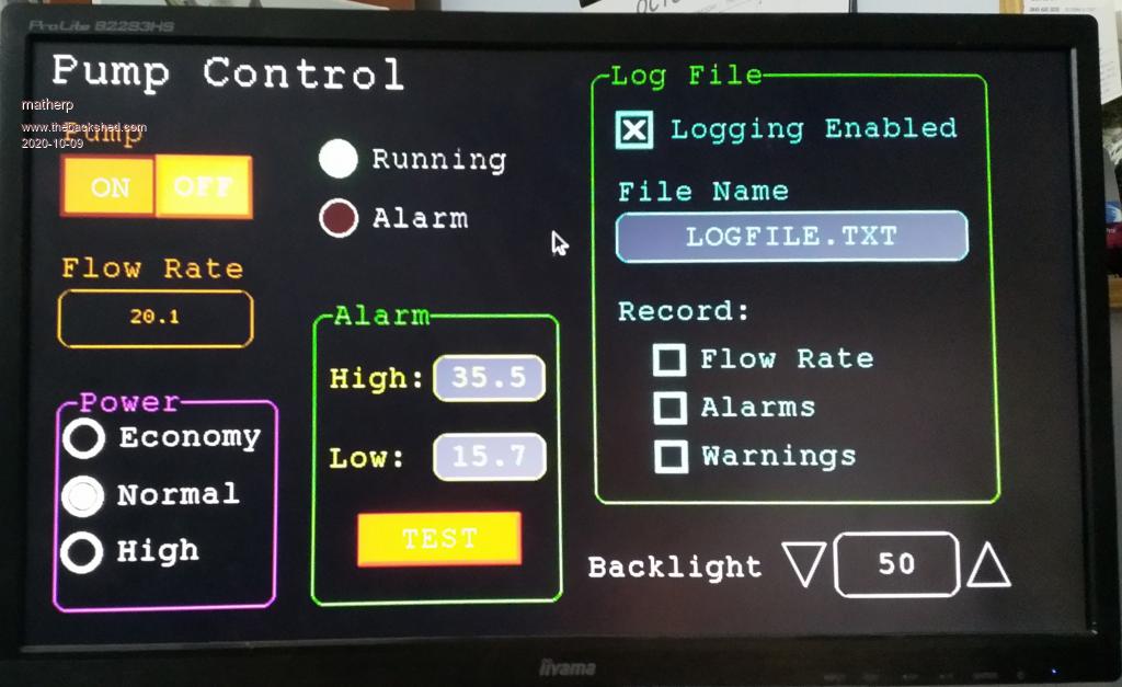

I've integrated Geoff's GUI functionality from the Micromite Plus into and experimental release of the CMM2. When using this with the Micromite Plus the functionality is tightly integrated with the LCD screen and Touch I/F. However, we have neither available on the CMM2 so I have implemented the cursor control and the "beep" as callbacks from the firmware to user supplied Basic subroutines.
GUI functionality should be exactly the same as the MM+ with the exception that the PAGE command is replaced with GUI PAGE.
Two Basic routines are required for full functionality
Function MM.CURSOR and subroutine MM.BEEP
MM.BEEP takes a single parameter which is the time in microseconds that the beep should last. The subroutine pro-forma is

My version using the HobbyTronics USB mouse I/F as in the video is as follows:

The experimental binary for the CMM2 is attached:
CMM2V1.5.zip
If you are feeling adventurous try creating versions of MM.CURSOR for the Wii Classic, Nunchuk, or just the USB keyboard using arrow keys and the space bar
Full example code based on Geoff's MM+ example

Posted: 06:05pm 09 Oct 2020
Here is a version that works using the keyboard to position the cursor. Arrow keys to move and space to activate a control. This demonstrates the H/W independence of the callback mechanism. You can use any device you want to move the cursor - just follow the rules for MM.CURSOR and it should work.
' Demonstration program for the Micromite+
' It does not do anything useful except demo the various controls
' Geoff Graham, October 2015
Option Explicit
Dim ledsY
option console serial
Colour RGB(white), RGB(black)

function MM.CURSOR( t as integer) as integer
 MM.CURSOR=-1
 if t=1 then
   MM.CURSOR=lb
   if sprite(x,1)<>10000 then sprite hide 1
 elseif t=2 then
   if lb then MM.CURSOR=x
 elseif t=3 then
   if lb then MM.CURSOR=y
 elseif t=4 then
   MM.CURSOR=lb
 elseif t=5 then
   sprite show 1,x,y,1
 else
   MM.CURSOR=lb
   sprite show 1,x,y,1
 endif
end function
sub mm.beep beeptime as integer
 if beeptime and mm.info(sound)="OFF" then play tone 600,600,beeptime
end sub

Posted: 09:09pm 09 Oct 2020
I came across an issue with my mouse.
In the SUB readtouch, you have a DO LOOP to wait for the x and y to get on screen.
Ocasionally, that SUB seems to get called halfway through my mouse sub, before I have had a chance to put the x and y back on screen.
Because the program gets stuck in your loop, my sub never gets a chance to do it's thing.
I solved it in two ways.
Firstly, in my sub, I put the range limiting all on one line.
mouseX = min(max(0,mouseX + deltaX),mm.hres-1)
   mouseY = min(max(0,mouseY - deltaY),mm.vres-1)
That seems to fix it by stopping the mm.cursor sub interrupting.
I also tried removing the DO LOOP from the SUB readtouch as an alternative and that worked also. That is probably the best place to do the fix.
   x = max(min(x,mm.hres-1),0)
   y = max(min(y,mm.vres-1),0)
Either method seems to fix the problem.
I noticed that the calls to mm.cursor continue even after a GUI DELETE ALL. That will be handy sometimes but a GUI STOP | START to turn off the calls would make it even handier.
Posted: 09:43pm 09 Oct 2020
Another observation.
The mm.cursor sub gets called about every 250uS
The sub, in my case takes 120uS so half the time is spend in the mm.cursor sub.
The nunchuk routines are run every ~16mS and I think that that would be a better timeframe for the mm.cursor as well.
Posted: 09:55pm 09 Oct 2020
This stuff is quite difficult and took many iterations to get working.
Code run as part of MM.CURSOR is not interrupted. However, code run outside it can have a MM.CURSOR call actioned at any time between statements (including code in MMBasic interrupts). That is why in my example readtouch is called from within MM.CURSOR.
In the keyboard version X, Y and LB are always valid so there is no issue.
Basically the rule is that X,Y and LB must always be valid at the end of any single Basic statement except during a single call to the MM.CURSOR routine.
The loop in readtouch was because sometimes the Hobbytronic I2C calls gave invalid data so I had to filter them out.
Don't know if the above makes sense but......
Posted: 10:02pm 09 Oct 2020
  matherp said  Jim
Yes, that is the conclusion I had come to.
It all makes sense and provide we are aware of the process, it is easy enough to cater for.
