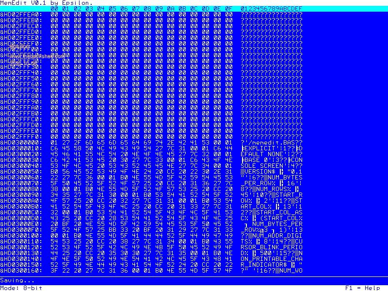

Hi all,
As said, here is MemEdit, derived from HexEdit.
https://github.com/epsilon537/memedit_cmm
Description
MemEdit presents you with a view into CMM2's (virtual) memory and allows you to make changes. Essentially, it's a peek/poke front-end. This means that the tool is limited to the virtual address space exposed by peek and poke.
The memory contents are shown as hexadecimal byte values and as ASCII code in two side-by-side blocks. Changes can be made both in the hex table section and in the ASCII section.
The usual file navigation with cursors keys, page up&down, home, end, etc. should work as expected.
MemEdit is a full-screen console-only editor. I does not work over serial, sorry.
The starting address to view can be passed in as a command line argument, e.g. *memedit MM.INFO(PROGRAM)
Commands such as goto and fill accept MMBasic syntax for address specifications, e.g. Go To Address (MMBasic syntax): MM.INFO(PAGE ADDRESS 0)
Press F1 to get help on key bindings.

I made this tool because I said I would, because it was easy after hexedit, and because some people expressed an interest. However, the usefulness of this tool is not obvious to me currently. Poking around on page 0 gets old after a while ;-)
On a C64, which doesn't have a virtual memory concept, such a tool is very useful. It gives you a unfiltered view on the entire address space, including the I/O address space.
Here, we are limited to what peek and poke will let you see. Maybe, with a clever CSUB, it's possible to tunnel through to the physical address space underneath. I haven't looked at the M7's memory management yet, so I don't know. If I figure it out I might add the capability.

Peek and poke only restrict to the extent that the addresses are real so you don't get a bus error.  They also block access to the C variables and stack to avoid the worst mistakes.
DTCMRAM (rw)    : ORIGIN = 0x20000000, LENGTH = 128K
AXIRAM (rw)     : ORIGIN = 0x24000000, LENGTH = 512K
RAM_D2 (rw)     : ORIGIN = 0x30000000, LENGTH = 288K
RAM_D3 (rw)     : ORIGIN = 0x38000000, LENGTH = 64K
ITCMRAM (xrw)   : ORIGIN = 0x00000000, LENGTH = 64K
FLASH (rx)      : ORIGIN = 0x08000000, LENGTH = 1024K
FLASH2 (r)      : ORIGIN = 0x08100000, LENGTH = 1024K
RAM_D5 (rw)     : ORIGIN = 0x38800000, LENGTH = 4K
#define RAMBASE         0x30000000
#define RAMEND           0x30040000-0x100
#define SRAMBASE         0x38000000
#define SRAMEND         0x38010000-0x100
#define RAM(a)  ((a >= RAMBASE && a < RAMEND) || (a >= SRAMBASE && a < SRAMEND) || (a >= 0x24000000 && a < 0x24080000) || (a >= 0x40000000 && a < 0x59000000) )
#define ROM(a)  ((a >= 0x08000000 && a < 0x08200000) || (a >= 0x10000000 && a < 0x20000000))
#define PEEKRANGE(a) (RAM(a) || ROM(a))
#define POKERANGE(a) (RAM(a))

That's useful info. Thank you! I defined constants for these address ranges so they can be used in address specifications. The constant names and their values are shown in the help screen.
