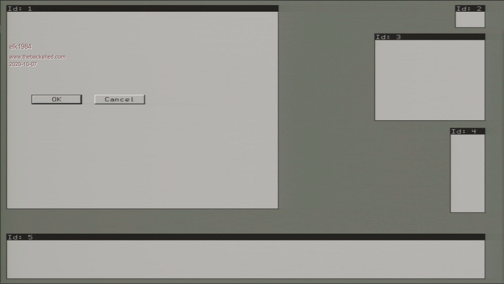

This is very rough and ready, but I'm putting it out there for comments & suggestions on how I might do this better (or indeed if it's a total waste of time!)  I don't want to go to Csubs (mostly because I can't code in C!)
wimp.zip
Features
- Movable panels (implemented as sprites and I'm sure this is a problem because it's easy to get up to the sprite limit with 64 controls on a page!)
- Buttons (default and normal)
- Show/Hide control
- Move control
To Do:
* Relative positioning (so the X and Y coordinates are defined relative to the container control rather than the screen)
* Z-Order (the hiding of ID: 2 leaving the background to ID: 1 visible when Id:5 would need to redraw; the hiding of Id: 5 leaving part of Id: 2 visible when Id:1 would need to redraw)
* Implement the other controls!
* Navigation (Keyboard / Nunchuk / Wii Classic / Mouse?)
* Memory usage - I'm sure I'm swallowing loads in all those string arrays!  I think maybe implementing the Container / Controls as a tree?
* Recursive redraw (repainting a Container causing all contents to draw)
Comments welcome.

Posted: 06:09pm 06 Oct 2020

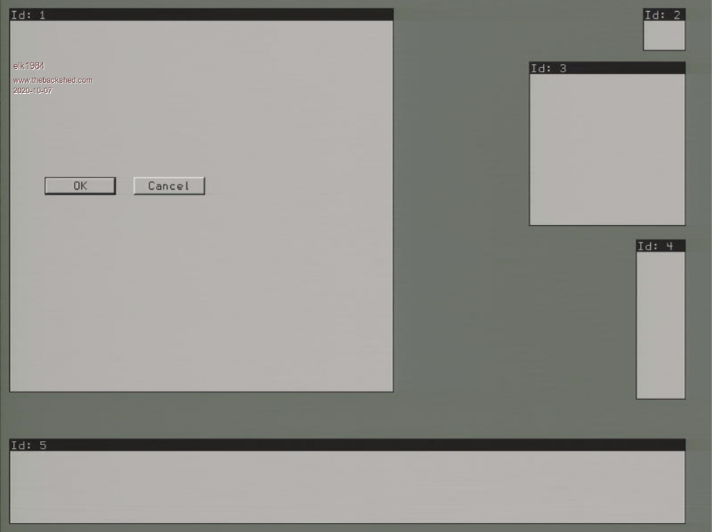

Screen capture using new VGA Capture Device
Edited 2020-10-07 04:25 by elk1984

Video capture uploaded to here showing frames moving and the Z-order problems.
Edited 2020-10-07 04:50 by elk1984

What's really interesting here is that I remember using GUIs like this without a mouse - process control software with "windowed" GUI elements accessible by keyboard (or touch screen) input, so work like this is just as applicable without a mouse.
Interestingly, one of the positives from an education perspective is the lack of mouse.  Forcing keyboard input makes students focus on what is going without the usual "click fest" that seems to plague software in schools.  So, oddly, no mouse by default is a positive for me.
That said - the GUI looks great - am following with interest.
Nim

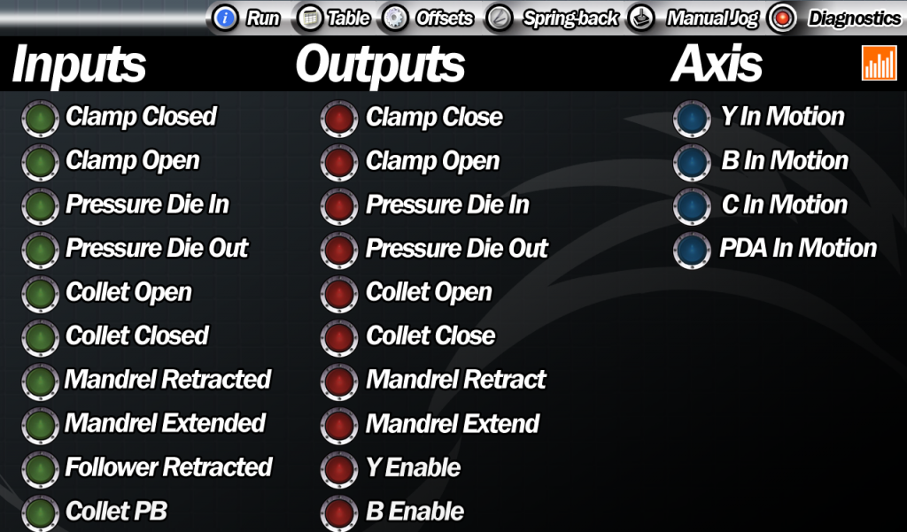

Posted: 05:00pm 08 Oct 2020

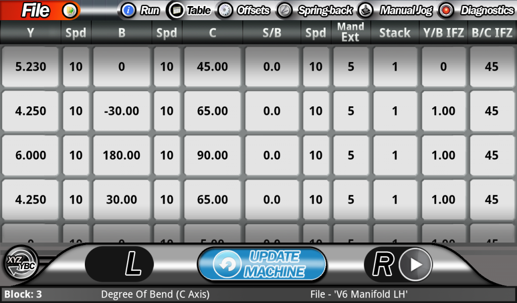

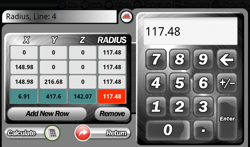

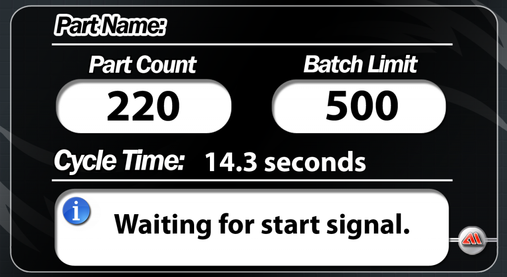

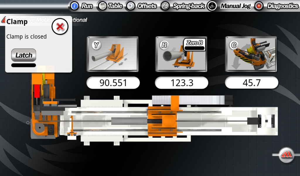

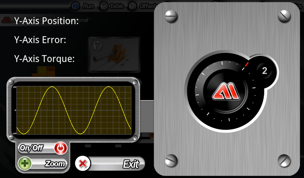

Here's what I have been doing since my DOS days because I never saw the point of drawing GUIs in code.

  Tinine said  Here's what I have been doing since my DOS days because I never saw the point of drawing GUIs in code.
Cool!

Posted: 07:20am 09 Oct 2020
Make use of the graphics capabilities of the CMM2, especially the page flipping.
Do a search for:
Knobman
Skinman
Creator: g200kg
I'd post a link but a search will reveal more.
The photo-realistic graphics for audio devices, etc., are created with these tools.
The rotary dial used in my top image was created with Knobman
