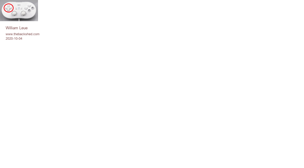

Looking at the 5.05.05 manual, I don't see any support for the D-pad (hilited in photo below) in the CLASSIC() function, although all other analog controls and buttons are supported. Am I missing something?

Posted: 09:09pm 03 Oct 2020
B returns a bitmap of the state of all the buttons. A bit will be set to 1 if the button is pressed.
The button bitmap is as follows:
BIT 0: Button R
BIT 1: Button start
BIT 2: Button home
BIT 3: Button select
BIT 4: Button L
BIT 5: Button down cursor
BIT 6: Button right cursor
BIT 7: Button up cursor
BIT 8: Button left cursor
BIT 9: Button ZR
BIT 10: Button x
BIT 11: Button a
BIT 12: Button y
BIT 13: Button b
BIT 14: Button ZL
Bits 5 to 8 work for me.

LOL, thanks! I guess the 'cursor' name was throwing me off; everyone I know always calls it the directional pad, or DPad for short.
