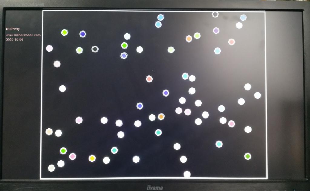

This demo hammers the SPRITE engine with 64 sprites moving all over the screen and never being allowed to overlap. Video here

Posted: 04:26am 04 Oct 2020
After nearly 3 hours running, it finally gave up with
  Quote  Error in Line 99: -9 is invalid (valid -8 to 239)
Posted: 07:51am 04 Oct 2020
  Quote  After nearly 3 hours running, it finally gave up with
Oops missed a bracket
  x(atom)=rnd*(mm.hres-sprite(w,atom))
  y(atom)=rnd*(mm.vres-sprite(h,atom))
Also change line 33
  sprite show i,x(i),y(i),1
  Quote  May I have permission to include it on the Welcome Tape please?
  Quote  May I also add it to the Graphics Programming Manual please?
Any Basic code I post can be used for any purpose - appreciate the courtesy but no need to ask
I'll have a play later today and see if I can get the physics better
Edited 2020-10-04 19:22 by matherp
