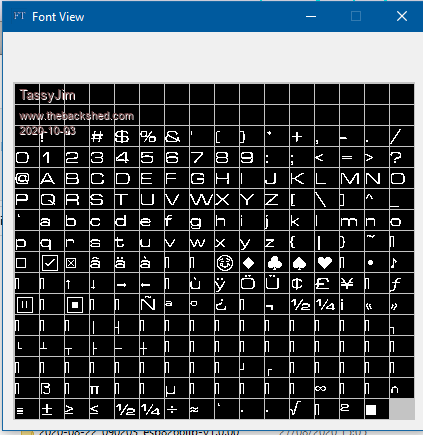

Posted: 09:21pm 02 Oct 2020
Under the assumption that you are using FontTweak, not Tweakfont...
I assume you started with the '.c' file.
The header line is not consistent with the data.
The header suggests 16 characters starting at chr$(0) but the data has the full 256 characters. We can't do 256 so 255 is the closest.
As your 'c' file font has the first 32 characters as blanks, you would end up with a font of 16 space characters. This is what did happen when I tried it.
Once that was fixed, the '.c' file loaded. Still complained, but loaded OK.
Changing the header to 255 gave me 255 characters as expected.
I changed the start of the '.c' file to:
  Quote  fontdatatype Microgramma[15364] PROGMEM={
0x18,0x14,0x00,0xff,
From there, according to the help file
  Quote  Delete First Character (ctrl-Delete) removes the first character in the file.
You will have to do that 32 times.

Not sure if you wanted suggestions, but:
Instead of
  Quote  5. Select from &h00 to &hfe (so this should be only 255 characters now)
you can select from &h20 to &hff, then you won't have to erase the initial 32 afterwards.
