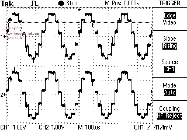

Straight from the manual, P78, Play Tone, 4000, 4000 should produce a nice smooth sinewave.
But for me, I get more like a 4 bit wave, ie a curved staircase. Could someone please verify that Play Tone or Play Sound produces smooth 12 bit waves?

The output seems to be set at 25uS intervals, independent to the frequency.
It's a while since I have played with the audio so I am not sure when this problem appeared.
Posted: 07:28am 29 Sep 2020
This has always been the case. That is how tone generation works. Same as on all MMBasic versions. Can't find the reference but the technique uses a constant frequency interrupt and then picks the appropriate place in a sine table for the next sample. The interrupt frequency on the CMM2 is 44100 Hz. Because other MMBasic versions use an RC filter on a PWM output the sine wave will look smoother but the technique is the same

Just put a small capacitor between the output and ground to filter out the high-frequency components of the waveform to smooth it out. You will have to experiment to find the right value. I would start with something like 0.05 microfarad.
