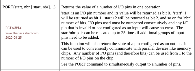

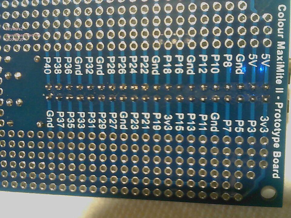

I am having trouble finding 8 consecutive pins for a 8 bit port .
Should I be looking at the P numbers on the attached ?
There seems ( and my brain is burnt    ) that there is a ground
pin interrupting any 8 consecutive pins ?

Why do you think consecutive is good or required? Quazee's new PCB design shows the allocation of the pins very clearly: Expansion Pinout

All of the pins don't have to be consecutive. Use the pin numbers as shown on page 10 of the manual. EG:
PORT(2,4,7,2,10,2)
IE: pins 2,3,4,5,7,8,10 and 11

How does
> PORT(2,4,7,2,10,2)
Translate to

4 pins starting at 2, 2 pins starting at 7, 2 pins starting at 10

Posted: 02:36am 25 Sep 2020
Thank You
