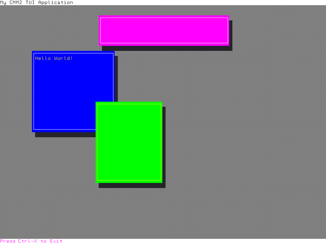

In my quest for creating a TUI library for CMM2. I have started by hacking a simple
screen using MMBasic to explore the screen, BLIT, and font capabilities. It looks like visually we can have a TUI library :)

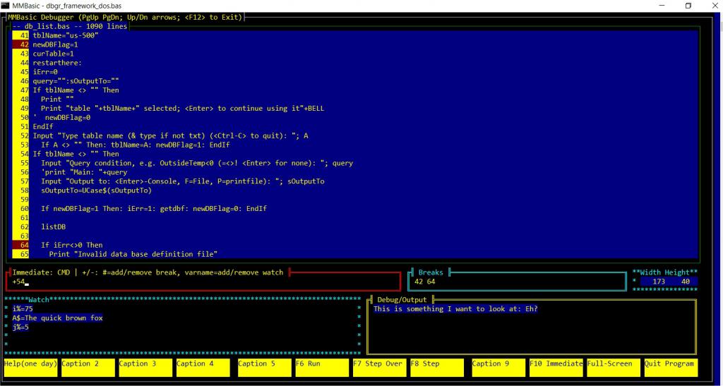

Posted: 07:46pm 05 Nov 2020
Something like this:
Using flip's framework from here: https://www.thebackshed.com/forum/ViewTopic.php?TID=9851
Edited 2020-11-06 05:49 by lizby
