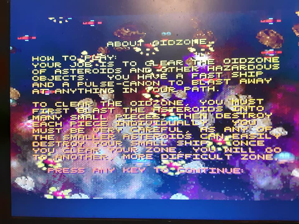

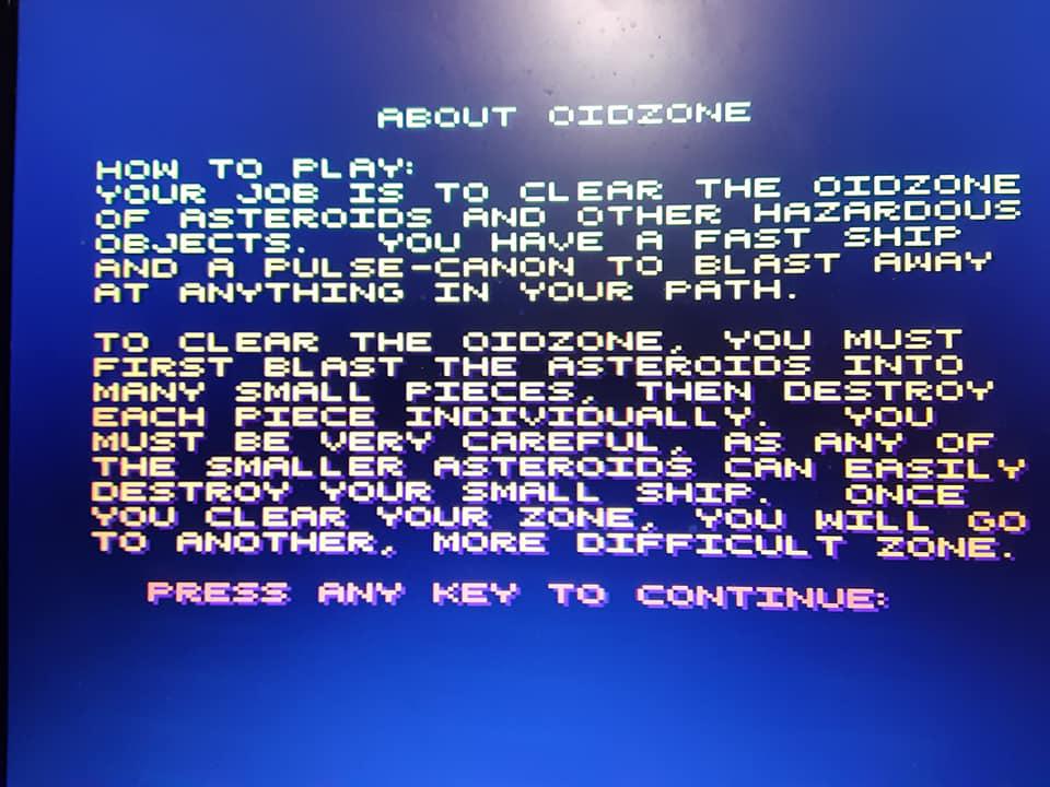

I just make my own font in any size and color(s) I want in photoshop, load the image on a spare page, and use my own font subroutine to read an array of strings and blit the letter images to the screen.
I can add a constant value to the letter coordinates to change colors from my font page.
in the snippet below I'm printing each line in black for a drop shadow and then in whatever color on top of it. This particular font is 6x6 and is good at 320x200.
I'm loading it on page 9 in mode 3.  This font is upper case only.

page write 0:cls
for q = 0 to 19
printline ozmessage1$(q),htab+1,vtab+1+q*vspace,fcolors(1)
printline ozmessage1$(q),htab,vtab+q*vspace,fcolors(q+2)
next

sorry for the lousy phone photos, my video capture thing I ordered is lost in the mail.
