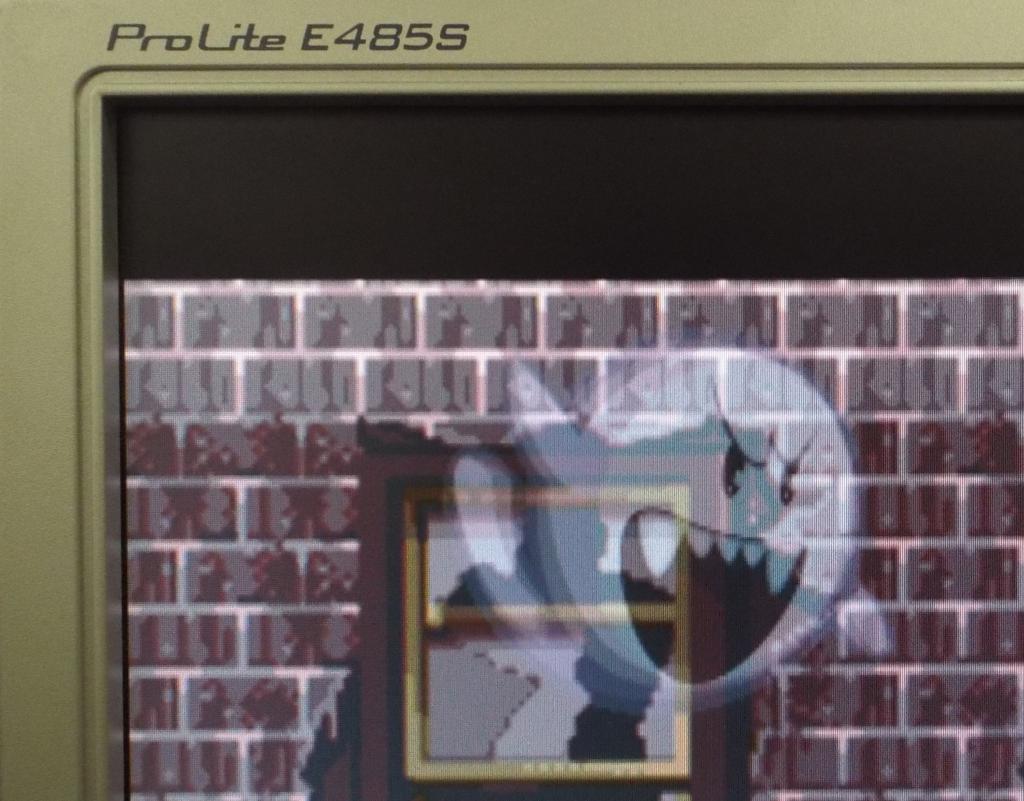

Thank You for your rapid response on this.  I have carried out some tests, with both good and bad results, using the supplied firmware.
The Good
The Ghost is back ... YaY
The program performs eaxactly as expected.  Good audio, no screen tearing, random transparent Ghost.  Perfect.

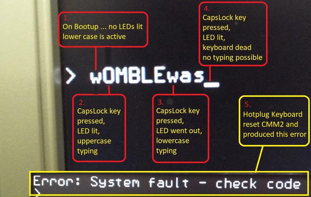

We have a CapsLock LED.  None of the LED's lit up before.
The Not So Good

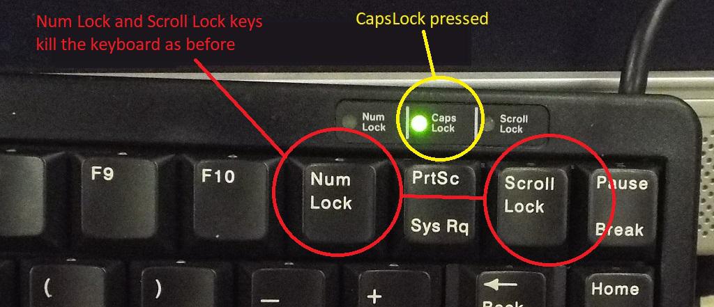

You get two presses of the CapsLock key on the Cherry G84-4100.  Then it crashes like before.  The LED lights on and off when you press the key as expected.  But once it has crashed it stays lit, at least until you hotplug. See below:
The NumLock and Scroll Lock keys crash the keyboard instantly.  The LED's never light up.  Hotplugging renables the keyboard:
BUT ...
When you Hotplug, for any of the keys (CapsLock, NumLock, Scroll Lock) the system resets and then you get the
"Error: System fault - check code" message.
You are obviously are on the right track with this, but not there yet, at least so far as this keyboard issue is concerned.

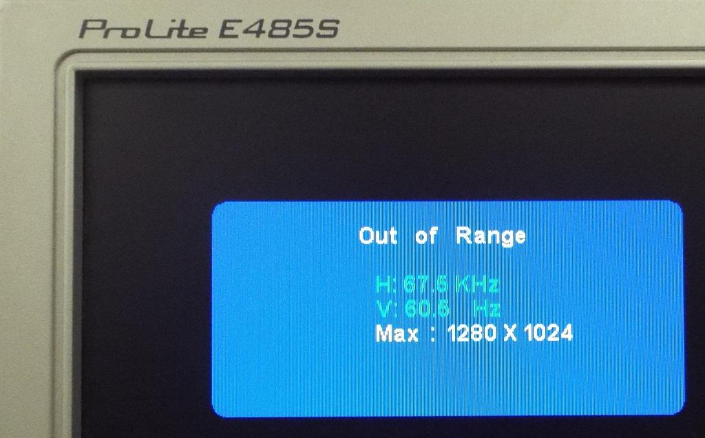

Whilst I was testing I also found this, Testing with TassyJim's NewColourBars.BAS:

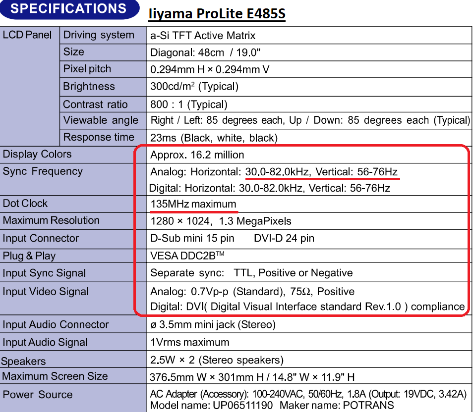

Iiyama ... MODE 12.8 and Mode 12.16 (960 x 540 @ 60 Hz) is "Out of Range" on V5.05.06b9 or the test firmware you provided.
Despite being within spec according to the speciications from Iiyama.
I assume that the "watchdog timer error message". I believe Peter mentioned that the watchdog routine can be triggered when plugging in a USB keyboard.
Note that for every keyboard hotplug, you get TWO presses of the CapLock key before it locks up again.  This seems to be consistent behaviour.  Two presses, thats your lot.

Your monitor is simply incapable of displaying 1920x1080 which is what it needs to do to use the 960x540 mode. This mode will only work on true 1080p monitors. Bit rate seen by the monitor is 148.5MHz

Thanks Peter ...
I wondered if that might be the issue with mode 12.  I misunderstood what 960x540 really meant.

18. GOTO 4, and repeat a number of times
19. Run Ghost_Demo.BAS which works perfectly (as expected), ESC back to prompt
19. Do something stupid ... Remove USB Keyboard
20. Reinsert USB keyboard
21. CMM2 resets and displays (watchdog message) "Error: System fault - check code"
22. Make note to self that Hotplugging from a running CMM2 is a very bad idea !!!
Many Thanks Peter, this one works fine
You have fixed it
  thwill said  Excellent, the keys now work, couldn't care less about the LEDs
I agree
