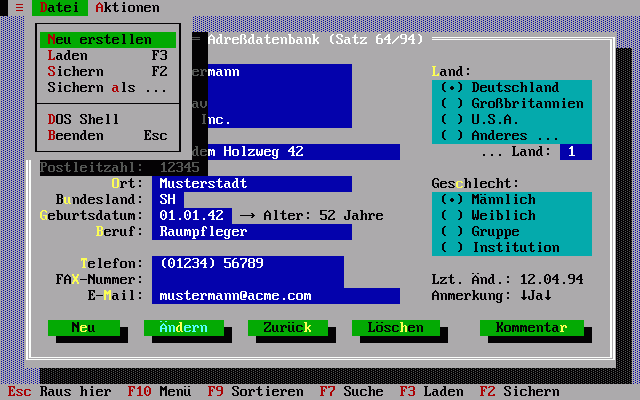

You either tabbed or arrowed around until you reached the target widget, or you used a shortcut key - note in the first screenshot every screen item has a unique letter in red or yellow, which is the keystroke associated with it.

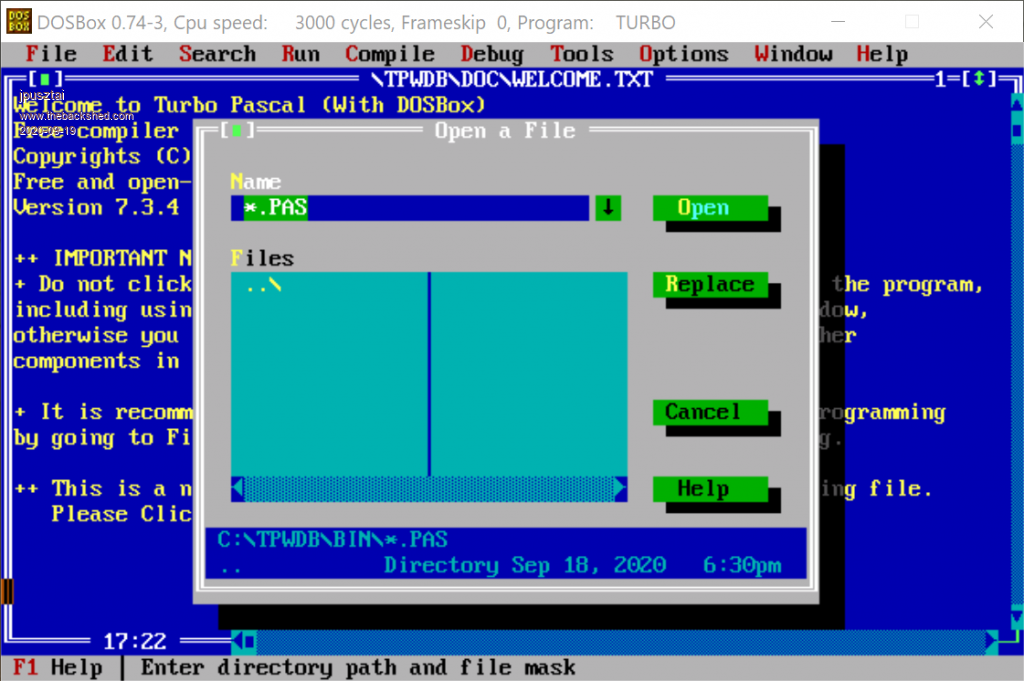

QBASIC.EXE runs fine under DOSBox 0.74-3 on my Windows 10x64 (v.2004) machines.  So does TurboC which has a similar IDE.  I have been using it to check out some of my ancient code with a view to porting some stuff across to the CMM2.

I'd never heard of DOSBOX. Have now installed it and run QBASIC.EXE. Thanks.
Also enabled me to run TurboC--TCC.EXE dated 1988. Oh the thrills.
