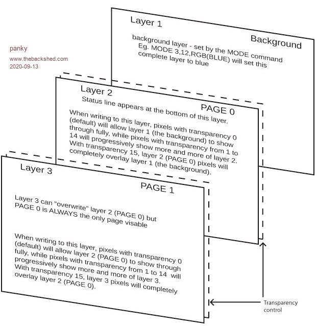

I also need to update the diagram for 12 bit colour depth - the following is what I intend to use,
Doug

Layer 3 can "overwrite" layer 2 (PAGE 0) but
PAGE 0 is ALWAYS the only page visable
I don't think I understand this, and I'd suggest rephrasing it. Taken literally it seems wrong - page 1 can also be visible in this mode.
Also typo in diagram - visable should be visible.

Posted: 04:15am 13 Sep 2020
Yes, it did my head in trying understand and also to explain. I think the text in the document itself does make it clear but I will look at re-phrasing the diagram. The bottom line is however, whatever you view on your monitor can only come from PAGE 0.
12 bit colour depth adds the ability to write information to PAGE 1 (layer 3) and depending on transparency settings, this will end up being visible but ONLY to the extent that it modifies PAGE 0 (unless of course if you do a page copy but then, it is STILL only PAGE 0 that is displayed).
Typo noted, thanks,

Error in the excerpt for RGB(332) diagram - fixed.
Which one is page 4? They both have page 4 on them.

Posted: 07:37am 24 Nov 2020
Apologies all, there were errors in the diagram on page 28 of the manual - corrected version attached.
Graphics Programming on the CMM2-v3b.pdf
Don't understand Tom? Can you indicate further what part of the manual you are referring too?
Doug.

  panky said  Apologies all, there were errors in the diagram on page 28 of the manual - corrected version attached.
Doug.
I'm referring to Page 4, of course! :) In an earlier post, you had two pages, each showed page 4 in the lower right corner. The current version is fine.
