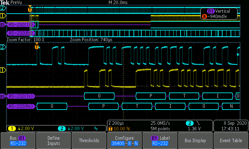

When sending out a contiguous stream of data from an Explore 100, on a random basis my terminal emulator looses the plot and starts spewing random trash. The on-screen LCD display continues just fine.
This happens with both TeraTerm & the MMedit terminal, and on two different computers, pointing (non-conclusively) towards the MicroBridge (a PIC16F1455). On occasion the data stream is corrupted so badly it somehow crashes the USB/RS232 driver in windows and requires the cable be unplugged and replugged.
The data coming out of the E100 is formatted 1 start bit, 8 data bits and 1 stop bit (the MMbasic default) with no inter-character delay. My current theory is that because all the bit times in the data stream are equal, the MicroBridge looses sync at some stage, starts interpreting the wrong bits, converting them to USB and dutifully sending them over the emulated serial port.
I have attached a bus sniffer analysis. 38400 baud.

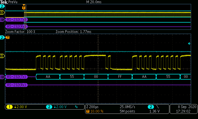

Yellow trace : Data coming out of the E100 (Tx)
Blue trace : Data going into the E100 (Rx)

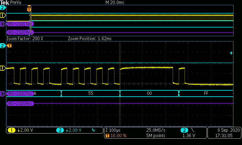

0009 shows a test sequence AA 55 00 FF sent continually
0010 shows a zoom of 55, showing the start & stop bit being equal and no inter-character delay
When sending data to the E100 there is an inter-character delay (0012 & 0013)
I assume the PIC32 hardware on the E100 is used to send data and the buffer is simply filled and then the UART told "go to it". I was wondering if it were possible to change the default to either 1.5 or 2 stop bits?
However, that might break compatibility for incoming data, so even trickier, is it possible to specify 1.5 or 2 stop bits for Tx (out of the PIC32) and retain 1 stop bit for incoming?
I have had the exact same problem occur with 19200 & 9600 baud. I have not tried higher or lower though.

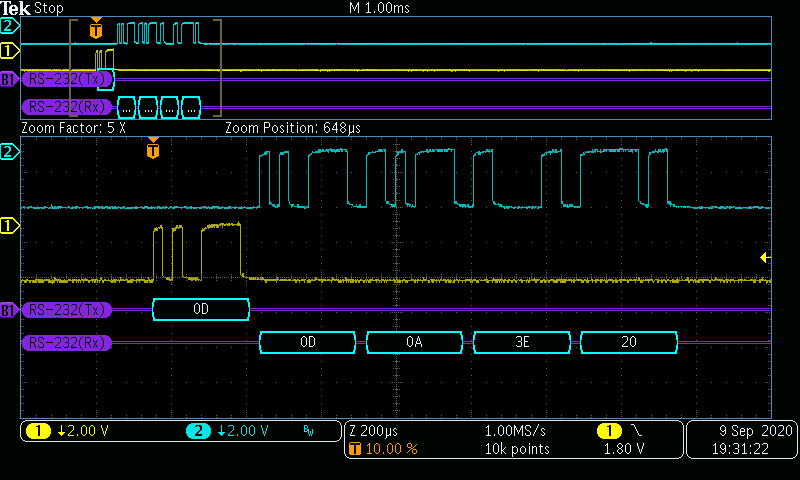

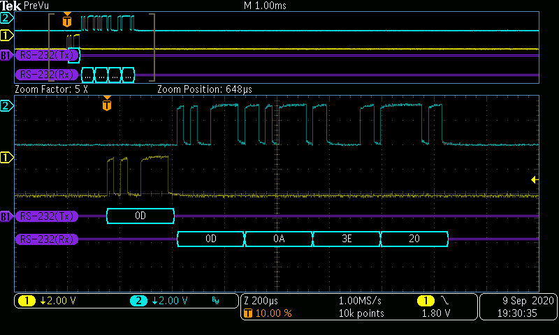

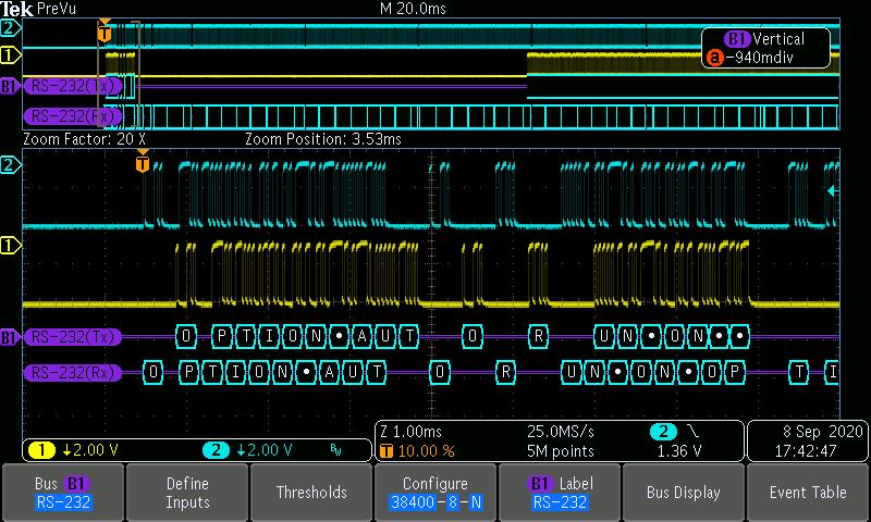

I tried Geoffs suggestion, ie: the POKE, and the E100 does not crash. I can tell immediately it does 2 stop bits (scope grabs before & after the poke) without even having to output AA or 55.
The POKE survives through a NEW, but (as expected) does not survive a reset.
I will report back with an update after operating it for a few days.
Cheers,
Unfortunately the TX/Rx channels/colours got swapped when I reconnected the scope. Oh well.
Before POKEing...
After POKEing...

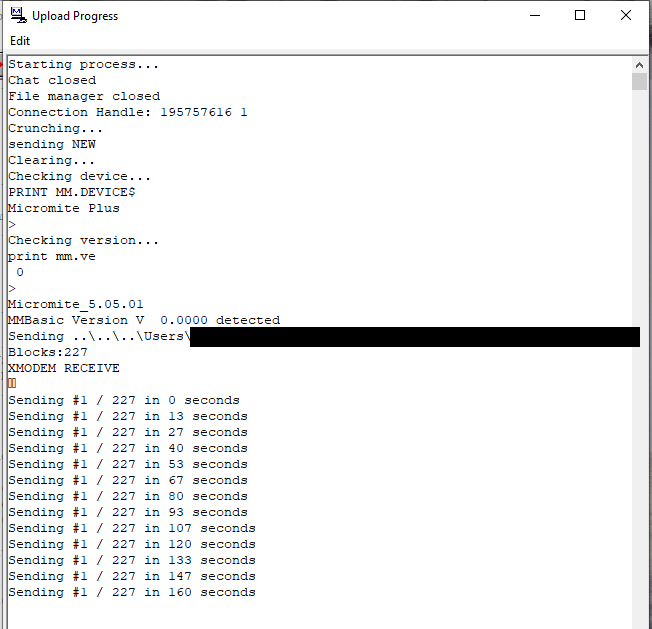

This-morning the problem re-appeared: MMedit would continually fail when trying to XMODEM a .bas file up to the Explore 100. I got a screenshot that essentially shows that the MMedit/E100 communication had screwed up even before the 'print mm.ver' got through. I have however seen considerably more interesting variants than my screengrab where it would mess up the 'XMODEM RECEIVE' command, turning it into something like 'XMODEM REXMODEM' (sorry, I didn't take careful note, and I didn't get a screengrab).

Posted: 07:07am 18 Sep 2020
Because you appear to be having problems with the USB side failing, I would start with a new USB cable.
Updating MMEdit will not help. I have not made any changes in the serial routines.
Your connecting failed at the second step.
It correctly replied to PRINT MM.DEVICE$ but didn't even manage to echo the next command PRINT MM.VER but did manage to give a prompt.
